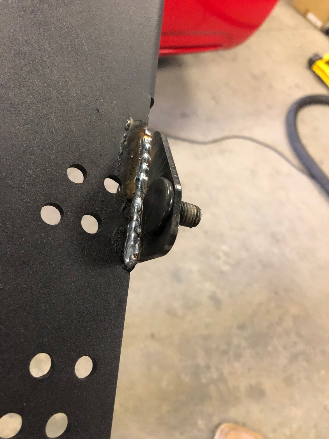

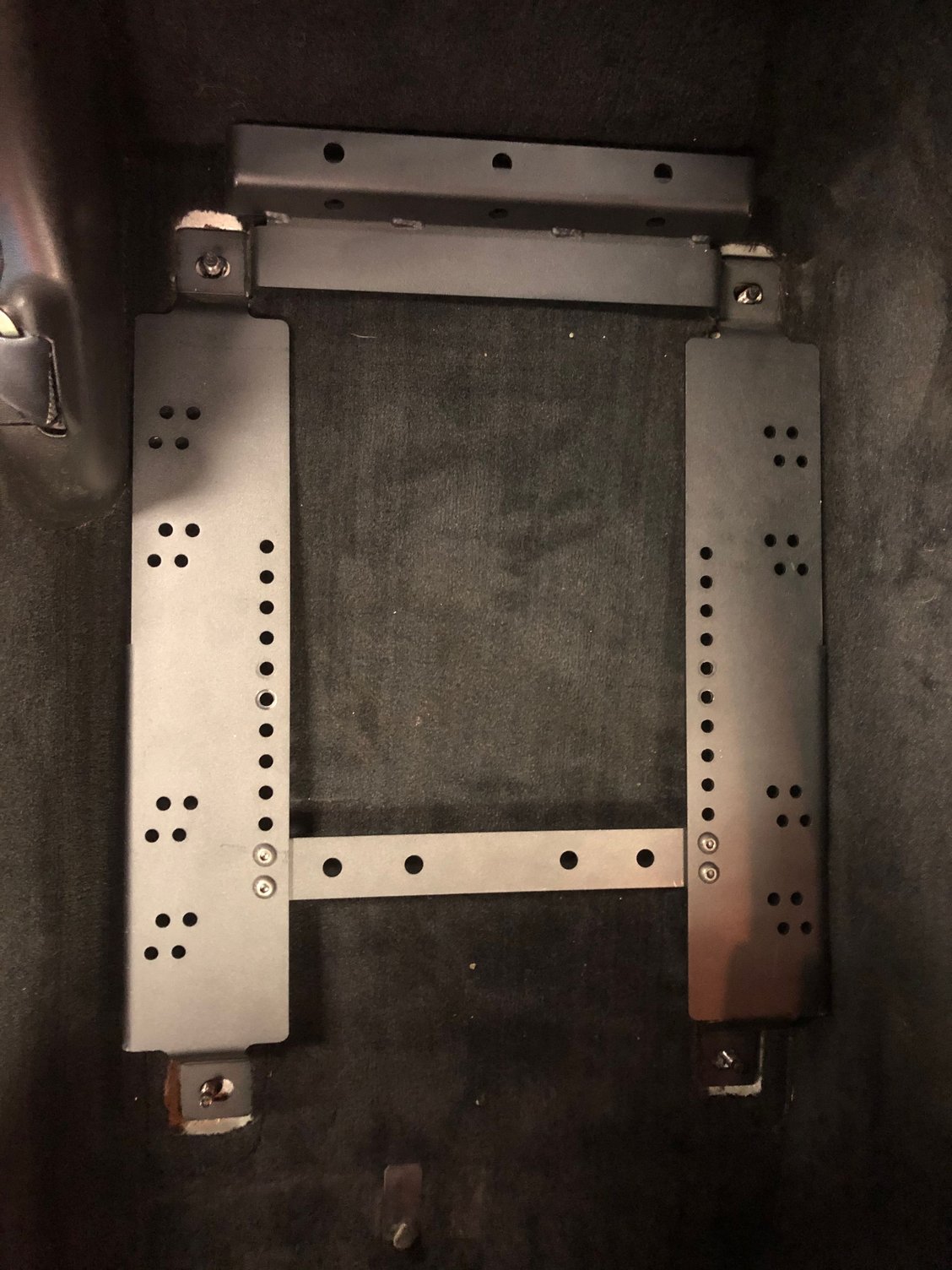

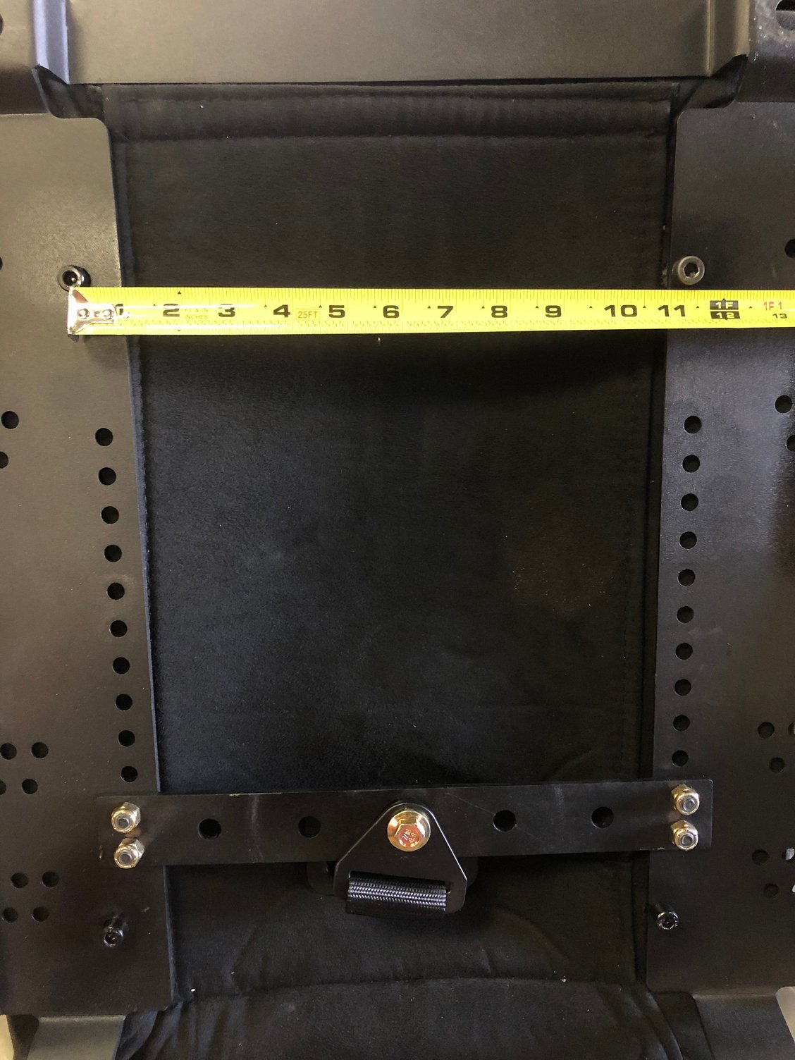

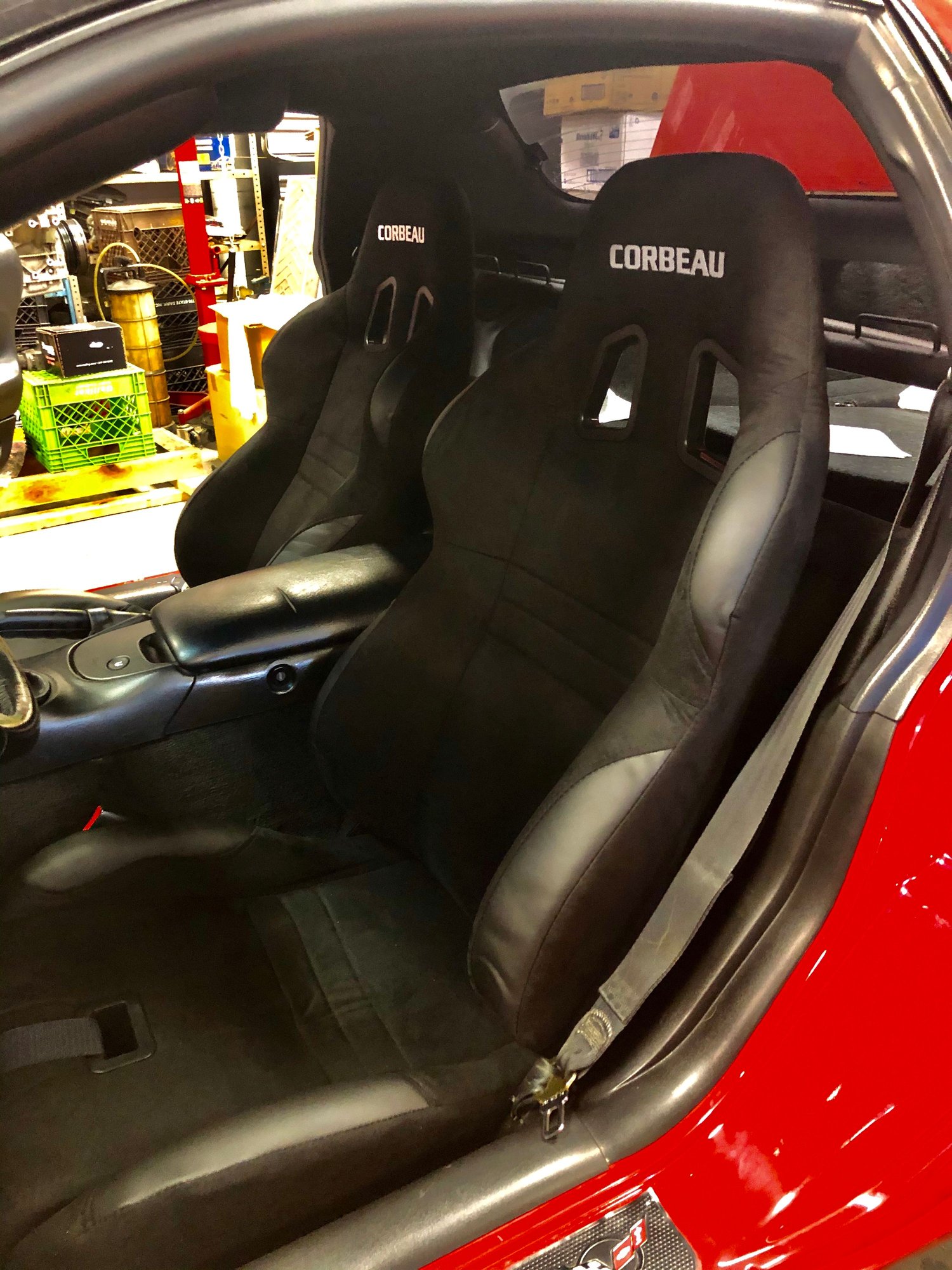

I bought the Marrad ultra low seat brackets and modified them to fit the A4's
https://www.marradind.com/proddetail.asp?prod=C56MBR-UL
I wanted the max headroom I could get with a reclining seat. I ended up with 4" of headroom without a helmet on (I'm 6'3). The seat bracket had to be modified and tapped to mount these seats which was not a big deal. I was ok with a fixed mounting position so I went this route. Also if you want to retain the 3 point harness you will have to cut and weld your seat belt bracket to the Marrad seat bracket otherwise you will have to go a 4, 5, 6 point harness. I did both 3 point and a 5 point harness.
I would recommend getting the stud extenders if you add a harness bar to make it easier to fasten the nut on to the stud.

I have the same seat and Corbeau cut down the base (seat ) a couple of inchs.
I am your height and with a helmet i fit well. I did not need a special low seat track.
