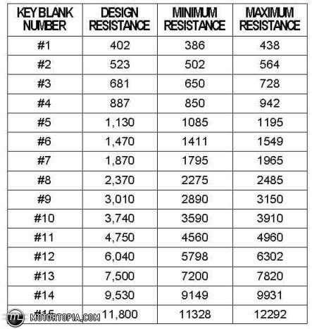

Measure the resistance on the pellet on your key and order the blank you need

First, you need to measure the VATS on your current key.
How to read your VATS Pellet Number! - McGuire Lock
Then Order the Key from one of the Vendors with the proper VAT.
1997-2004 Corvette Ignition or Door Lock VATS Key Blank

This is the fastest, cheapest option. You can measure and order as suggested, but then you'll still have to get the blank cut to match. A locksmith can do all of it in one stop, and will likely make you a better quality copy than you can get at Lowes or Home Depot.

You can get the same coded VATS key blank on ebay for $10-12. Uncoded door key is $6-7.

Default VATS Key Reference Table
I decided to combine the information presented in the two table sources into one Excel spreadsheet for those who want both the resistance and the GM VATS Letter Codes.
I hope that this is helpful for others.
