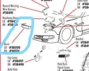

OK...I am concerned I may have given you incorrect information. I thought you were referring to attaching the bezel to the headlight frame. The information for that I believe to be correct. See photo; bezel circled in blue
If you are talking about the screws headlight mounting bracket (see photo; screws circled in red), then those screws are GM part # 11508561 [4.2 X 1.41 X 20]. These screws were also used on GM instrument panels from 1990-2005 so they should be fairly easy to find.

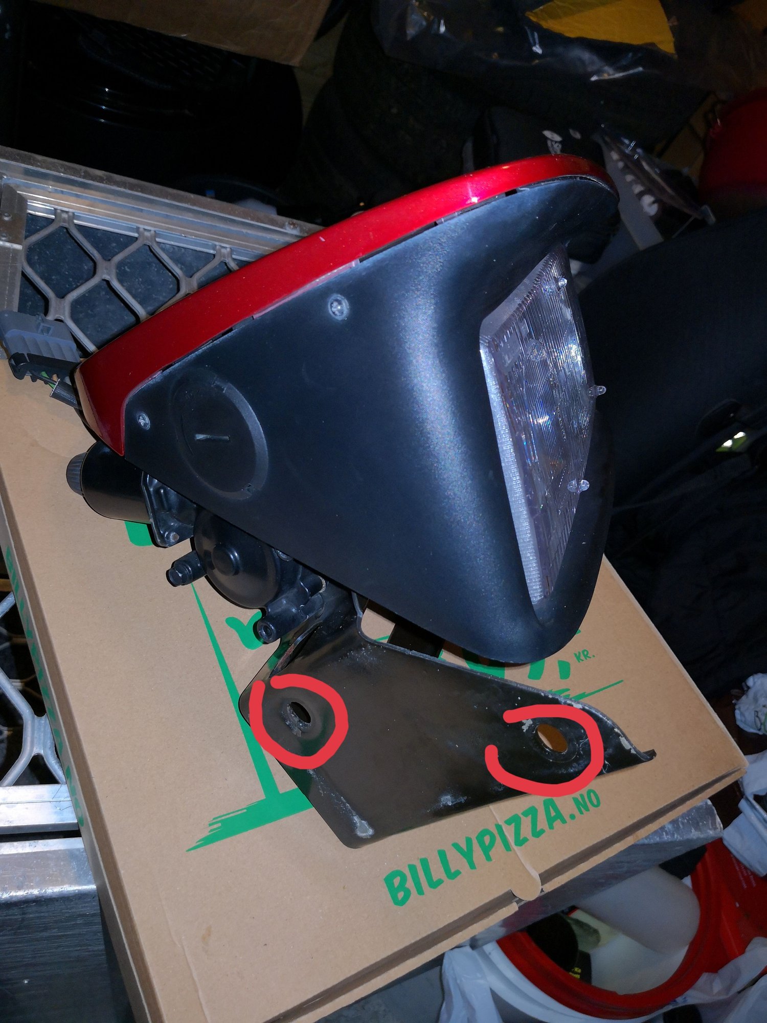

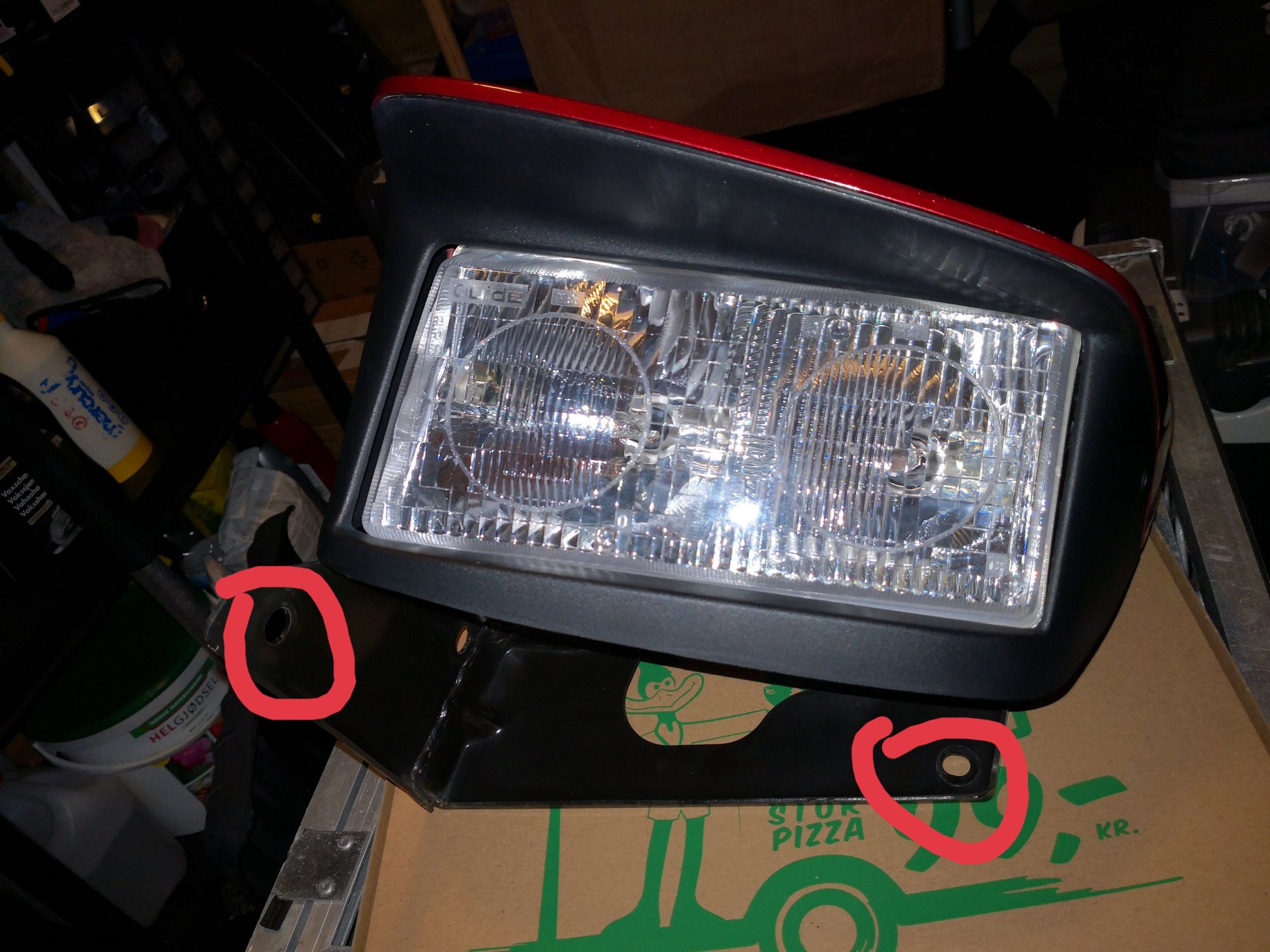

In the metal frame where the red rings are i assume there will be some screws to attatch the headlights to the car?
Seem to be some confusion so i hope these pictures clears this up 😉

Yeah thought so.
I think at least one of those is a stud that needs a nut. It's been awhile, though.
