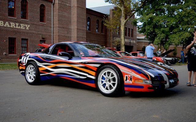

A while ago i ordered some wheels that you all said would be too big. So i canceled the order today and talked to the shop about getting some proper fitting wheels. I want the wheels for going on a track days now and then, Im thinking 18 front and 19 in the back. But what would be in your experience the widest rim and tire for oem C5? I do have some Corvette creation ZR style wide fenders on the way so i will buy rims to fit those, but the dealer wanted OEM numbers first. The wide fenders are 2.5" wider each side so should be simple to find out how much wider we would need.
So what is the widest tire and rim for OEM C5 (No poking). If you know ET that would help a lot to, thanks!
Picture for attention

I have NEVER understood people posting pictures of wider/larger than stock tires from the sides!! Most want to know how far, if any, they protrude from the quarter panels/fenders.......
