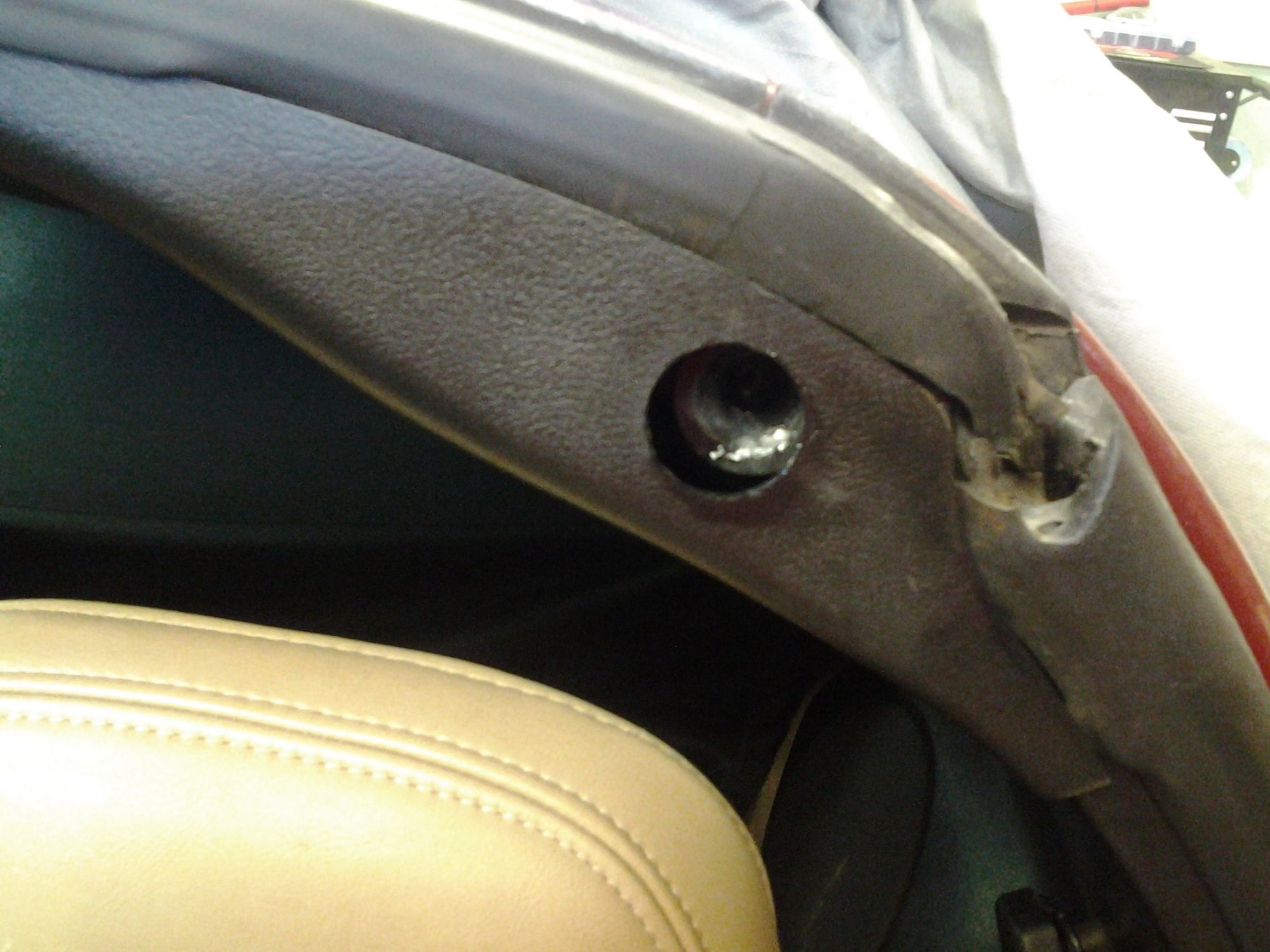

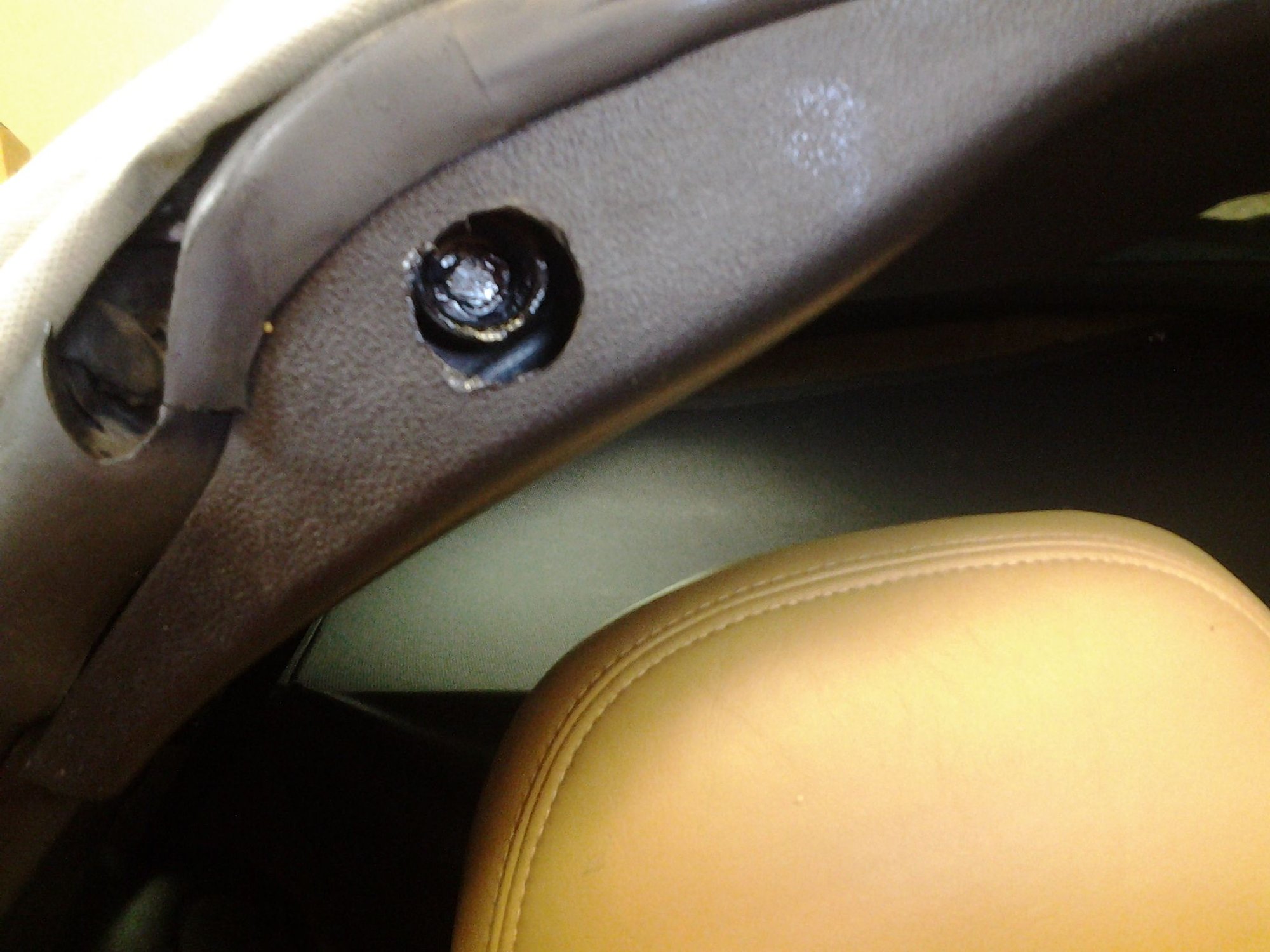

Default Photos: #1 is a stud, #2 is the complete socket with insert, and #3 is without
Old Aug 11, 2021 | 01:45 PM
katanaman's Avatar
katanaman
Joined: Dec 2020
Posts: 71
Likes: 21
From: Ocean Park, Washington
I couldn't figure out how to get text in with the photos. As you can see, I have a layer of Vaseline on everything, and I left it on. You can tell, if you are looking closely, that the attachment #3 shows the socket without the insert -- you see a sharp, large opening versus the tapered insert in the driver side socket. I am looking for a new insert for the passenger side. MidAmerica couldn't help. I don't see these parts listed anywhere.

Hard to tell from the pictures, but it appears both "female" receivers are there...they're just really mucked up somehow. Luckily, that's an easy fix. Pop the plastic push pins out of the halo trim and you can pull the trim down enough to access the receivers. Two bolts each and they should come out (or adjust). I'm all for janky repairs when warranted, but I'd personally replace those from a salvage yard or ebay rather than trying to stick a foreign object in there lol. Shouldn't be expensive and they're easy to access.
Now how in the heck did your receivers get so mucked up?? I don't see how a smooth ball could gouge up the receivers like that. They're just there to help align the targa top...looks like someone went at them with a screwdriver or something lol.

No screwdrivers. Like I said, I had dabbed some vaseline in the sockets, and that's why they look distorted. No trauma, just missing some kind of insert. I just saw a listing on eBay from Eckler's but it was just the studs and the nylon washers that go underneath. I still haven't been able to track down any info on inserts. Whatever it is must glue inside the metal sockets.

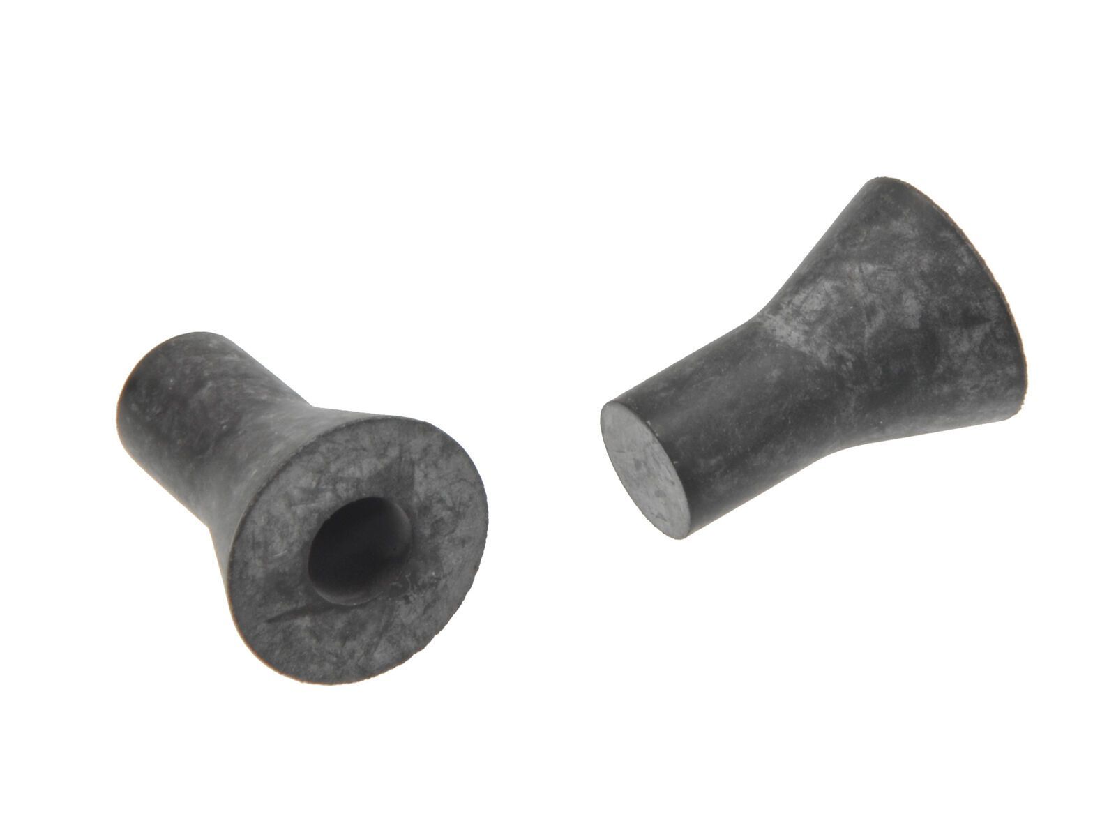

Hi. Attached see a photo of a product Corvette Central carries, they want it to be used in a storage scenario. This is the closest I have seen so far, but I would need to shorten it, fit it into the pocket, then glue it in. I guess the next step will be to contact the nearest junkyard (3 hours away) and see if they might have a complete original socket unit instead.

I hate to bring this back up, but the locator bumpers from Corvette Central still aren't what I need. I am going to have to go to a junkyard. This is going to take some time...

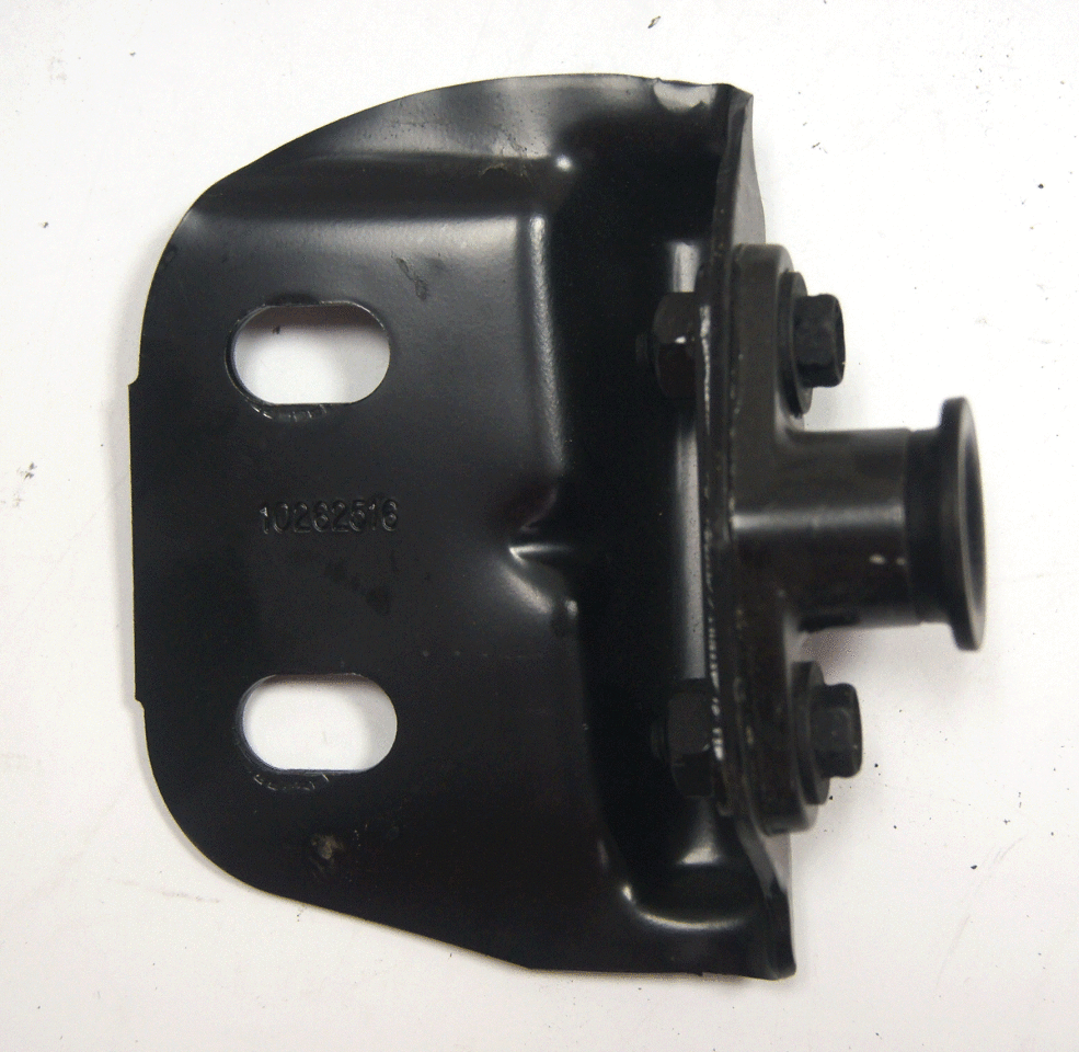

Finally. I got what I needed. The junkyard called it a targa top latch bracket, and its number is 10262516. I didn't use the whole part, I used just the part I needed -- part # 10270313. There was a bit of adjustment to do -- it's amazing how much range this part gets in the bracket. No more thump. All I really needed was the bell shaped part, and I cannot imagine how it was missing.
