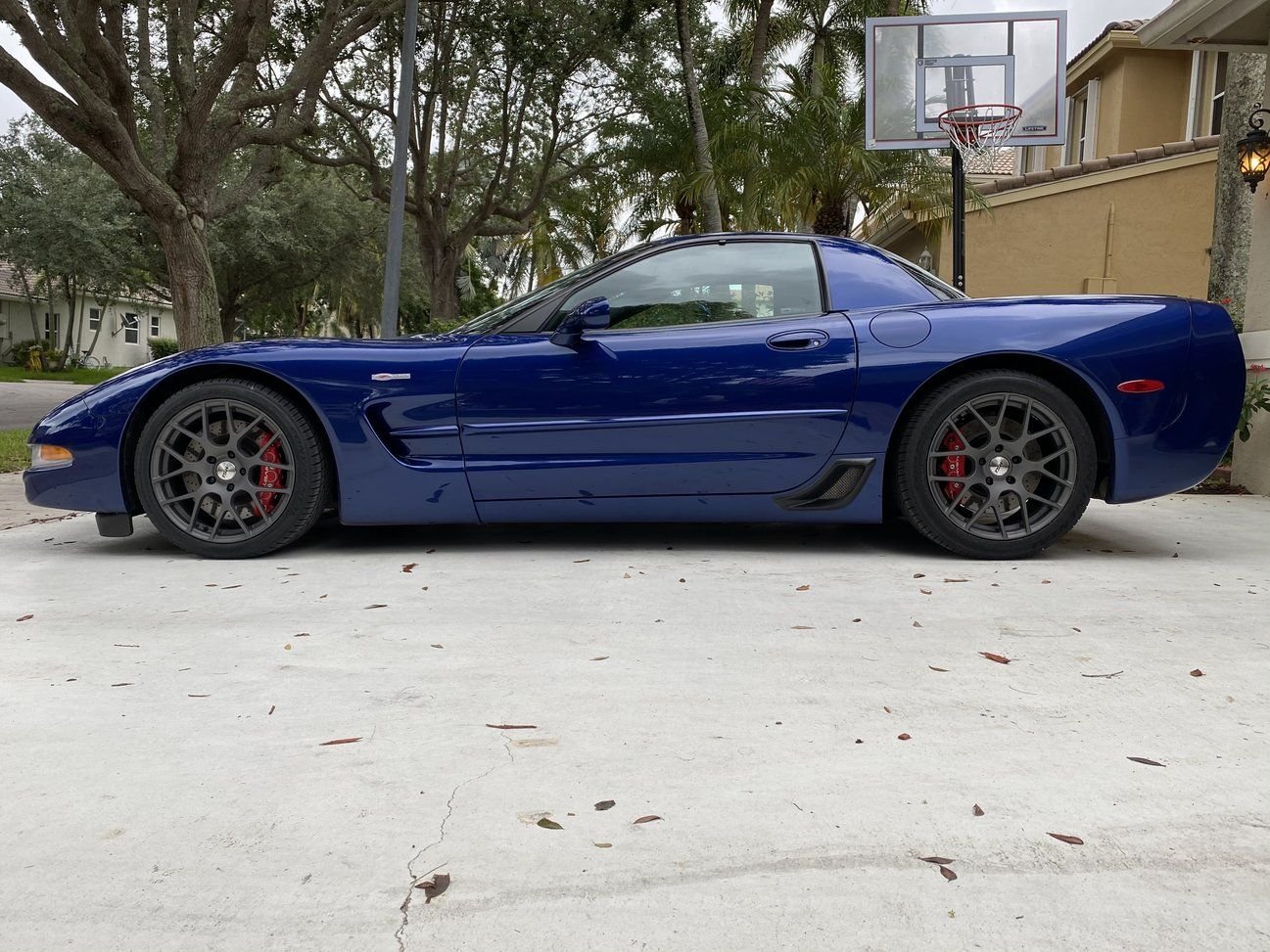

I've had the pleasure of owning several Vette's over the years (C4, a few C5's, and a C6) This one has been the best of the best (and my current one). 04 CE Z16/Z06. Just a well-rounded, powerful, sleek, and timeless shape. I would one day love to get a widebody C7 - but I would keep the C5Z as it is just an awesome car.
