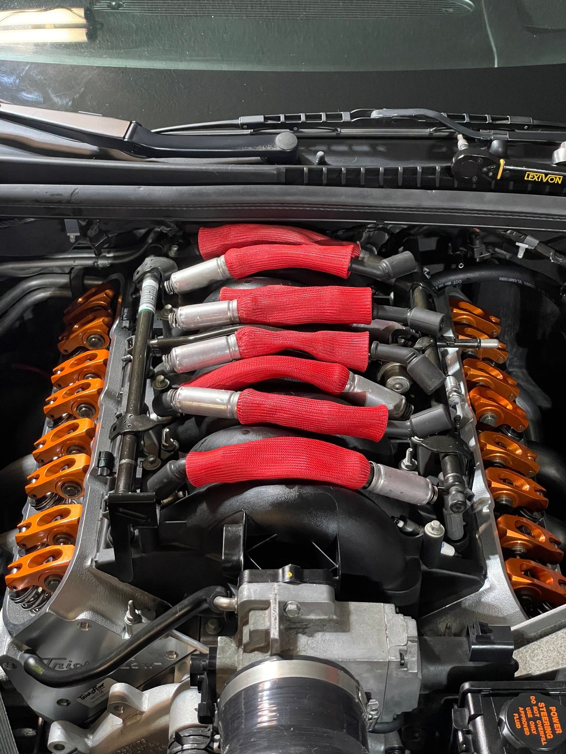

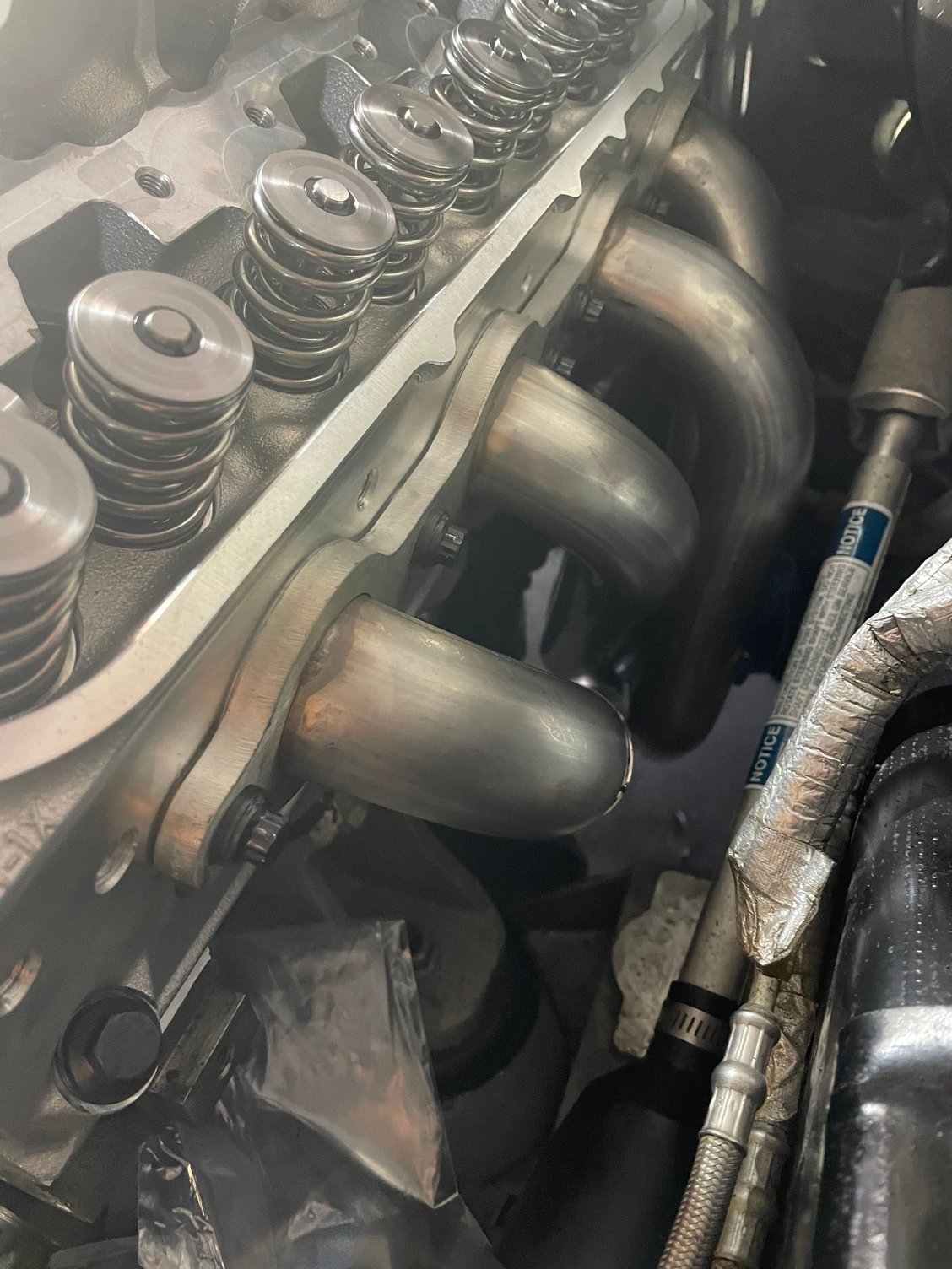

[QUOTE=PerryKing;1603906399]I went with Texas Speed 1 3/4 long tubes and their off road x pipe. Had absolutely no issues with fitment. No wrap or coating and my temps run the same as before. I did install spark plug boots.
Thank you for the information and pictures!
