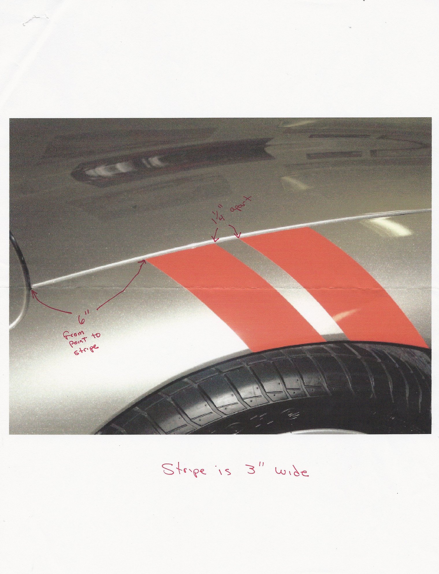

This may help you - measurements from stripes I had on my '00. If I recall correctly, each stripe was 3" wide and tucked in over the edge at the top and bottom of the fender. Approximate 45* angle on the stripes.

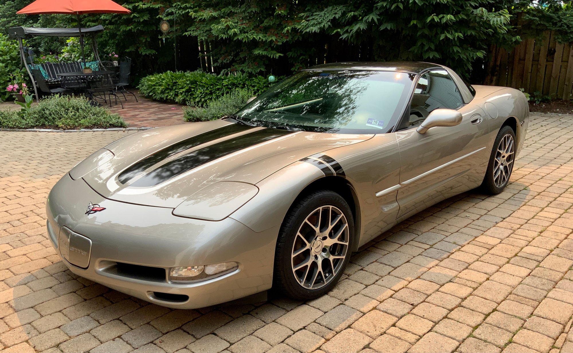

Max, I took my dimensions from a C6 and C7 GS years ago, as I’ve had fender stripes on and off for a long time. Mine were almost the same as Jack’s, but on the C6 the second stripe is wider. Very easy to cut them out from a piece of vinyl. My current stripes are further back than Jack’s but his measurement is close to the C6.
One caveat is if you go more towards the rear, watch your angle. If you pitch the upper end too far forward without positioning the lower part the second stripe might go past the fender well causing you to reposition it. I place them with the backing paper on, then use painter’s tape to decide the position.

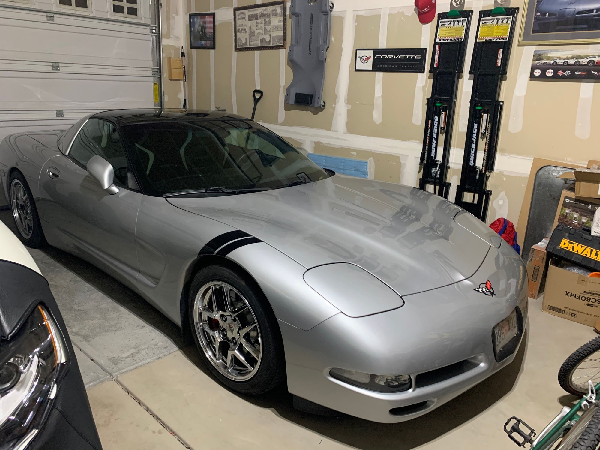

These were on my Z, similar size to Jack’s.

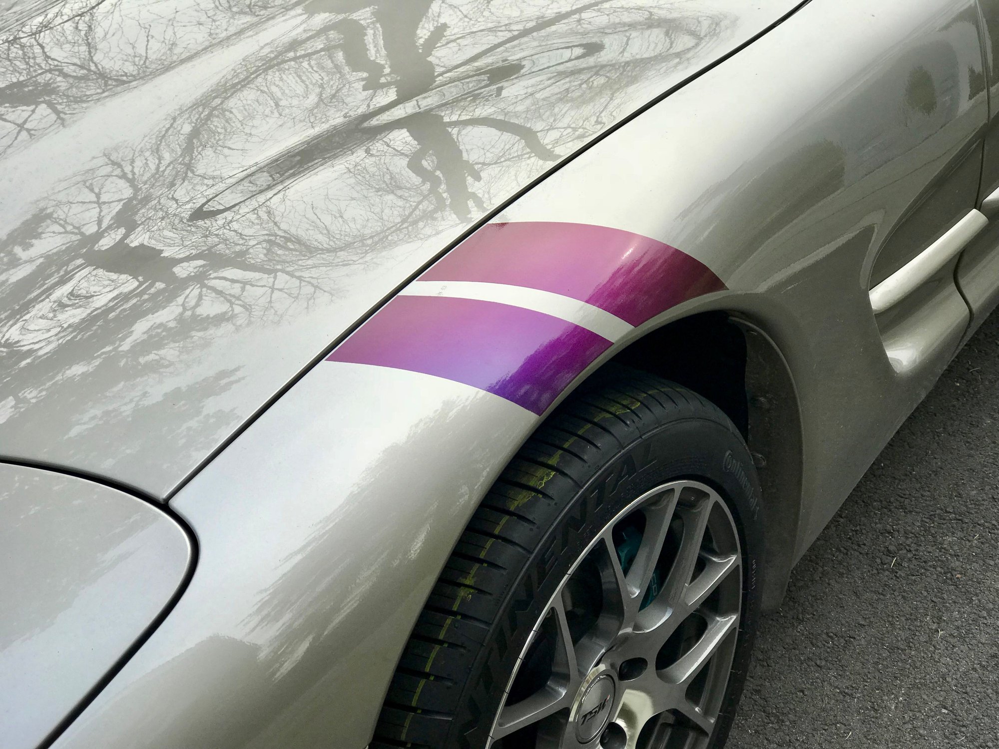

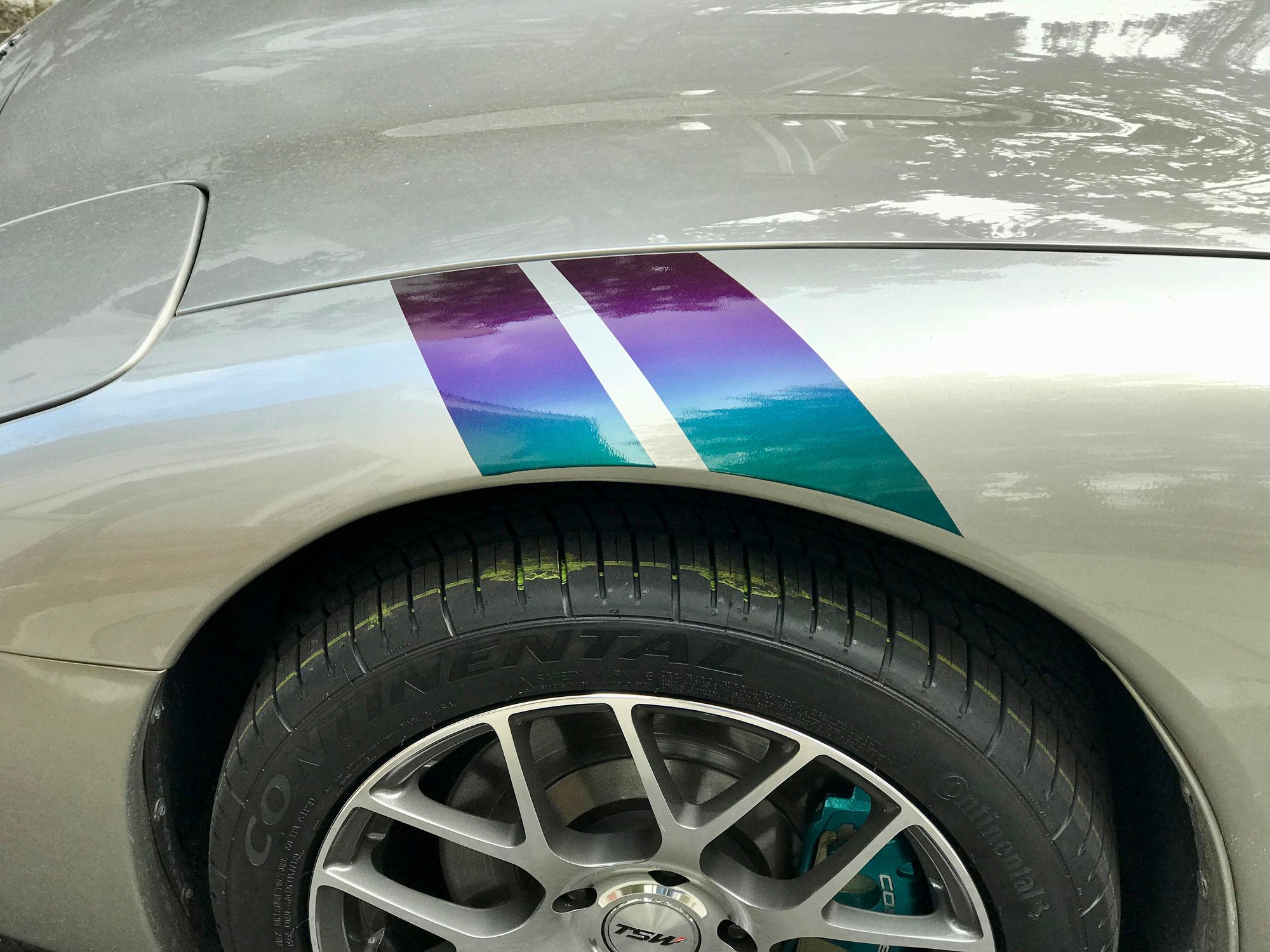

Here’s a few pix of the first fender stripes I tried on the pewter.
