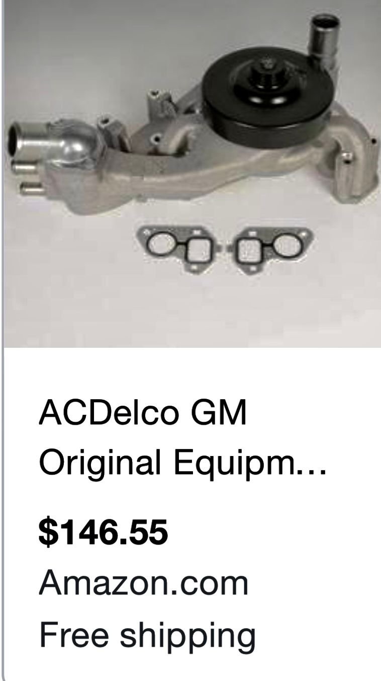

On all 1993 and up Ford engine components have a true worm trail machined/casted/provision in all bolt on components with the rubber/viton O-ring/gasket. No paper/O-ring gaskets used. I was ‘guessing’ GM did the same.
Old Aug 24, 2021 | 07:33 PM
I’m Z one's Avatar
I’m Z one
Posts: 2,318
Likes: 243
2022 Corvette of the Year Finalist -- Modified
2021 C5 of the Year Winner - Modified
I guess this answers the question
Old Aug 24, 2021 | 07:44 PM
Stingroo's Avatar
Stingroo
Joined: Jan 2019
Posts: 4,308
Likes: 3,455
From: Somewhere, Florida
St. Jude Donor '20-'21-'22-'23-'24
Yeah new ones probably come with the gaskets. FelPro makes them, too. The parts store pump I got had metal gaskets if I remember correctly.... been about a year since I did it.

I just replaced a WP on a 2002 Z06 this past week. Napa Water pump came with metal & O-ring gaskets. Pretty easy job actually. Luckily the one I took off had metal/o-ring gaskets too so I didn't have to break out a fresh blade razor scraper.
