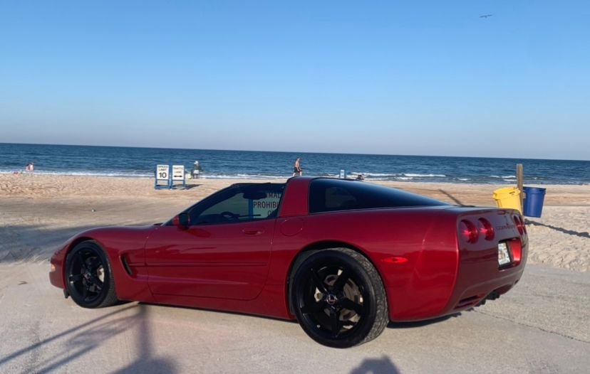

Bought a used stock 1999 with auto tranny, 100K miles back in April. Previous owner put on C7 rims. 19 inch in rear, 285/35/19. Recently I decided to floor it at a light. Tires stayed gripped to the blacktop, no spinning wheels. I suppose that is a good thing if I wanted to race someone, but wonder if the car needs a tune or something. It runs great, other than the slight vibration I read all of them have. Doubt I will rag on it, want it to last a long time, but still… a Mustang might pull up next to me someday.
