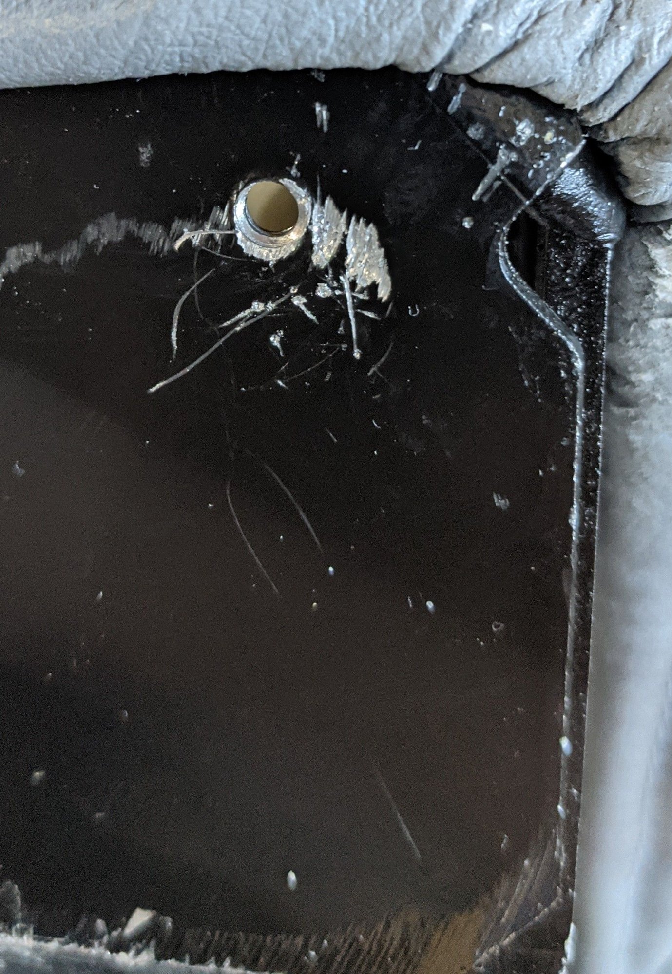

What does the front edge of the seat bezel supposed to attach to on the seat? There is a hole, I assume something is supposed to be there to hold the screw? Is it just a speed clip? Thanks.

There are 3 points where the bezel is attached to the seat.
1. at the front edge, this is a long screw that just goes into the metal frame
2. front side there is a press fit post that usually breaks off
3. under the recline handle. again this is a short screw that goes right into the metal frame
Many of the bezels I have seen have the mounting points broken, so if your is not fitting well it could have broken posts.
Gary

The front corner of mine was broken and repaired, but rebeoke. I ordered a new one that comes Tuesday. I will see if I can find a screw that fits for the front. Thanks.

The screw for the front of the bezel is 2 or 2.5 inches long.
Gary
