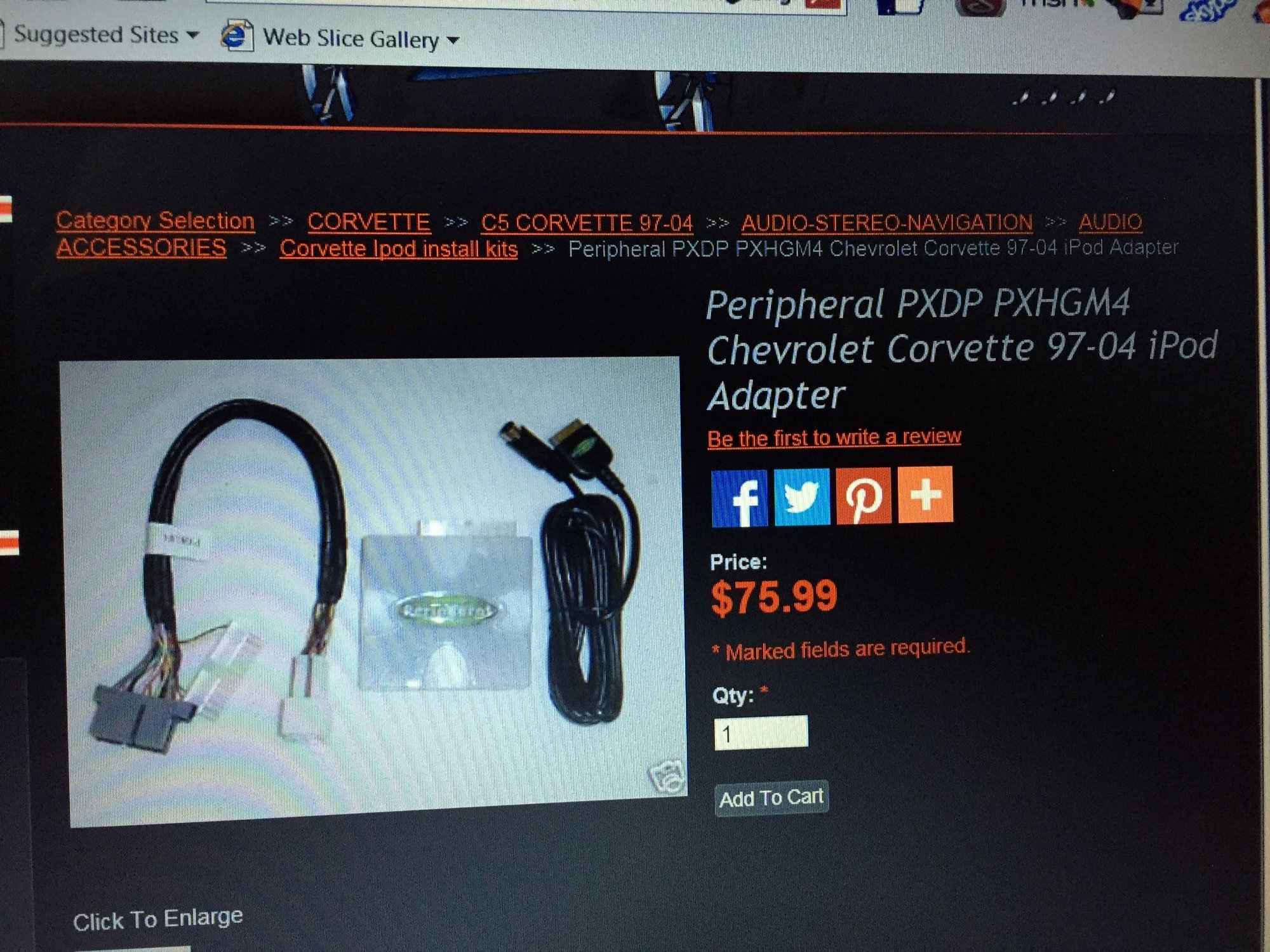

I purchased this and used it in my 04 for many years before trading car in. It worked great and played music from my iPhone music library. You still used radio control ***** for volume , next etc and it charged iPhone while connected. This picture shows model withOUT cd changer but they had a model for car with cd changer. This adapter connected to back of radio head was fairly easy to install . I had to disassemble console and face plate by radio. I spent more time checking on how disassemble than it took to do. Price shown was from a few years back.
