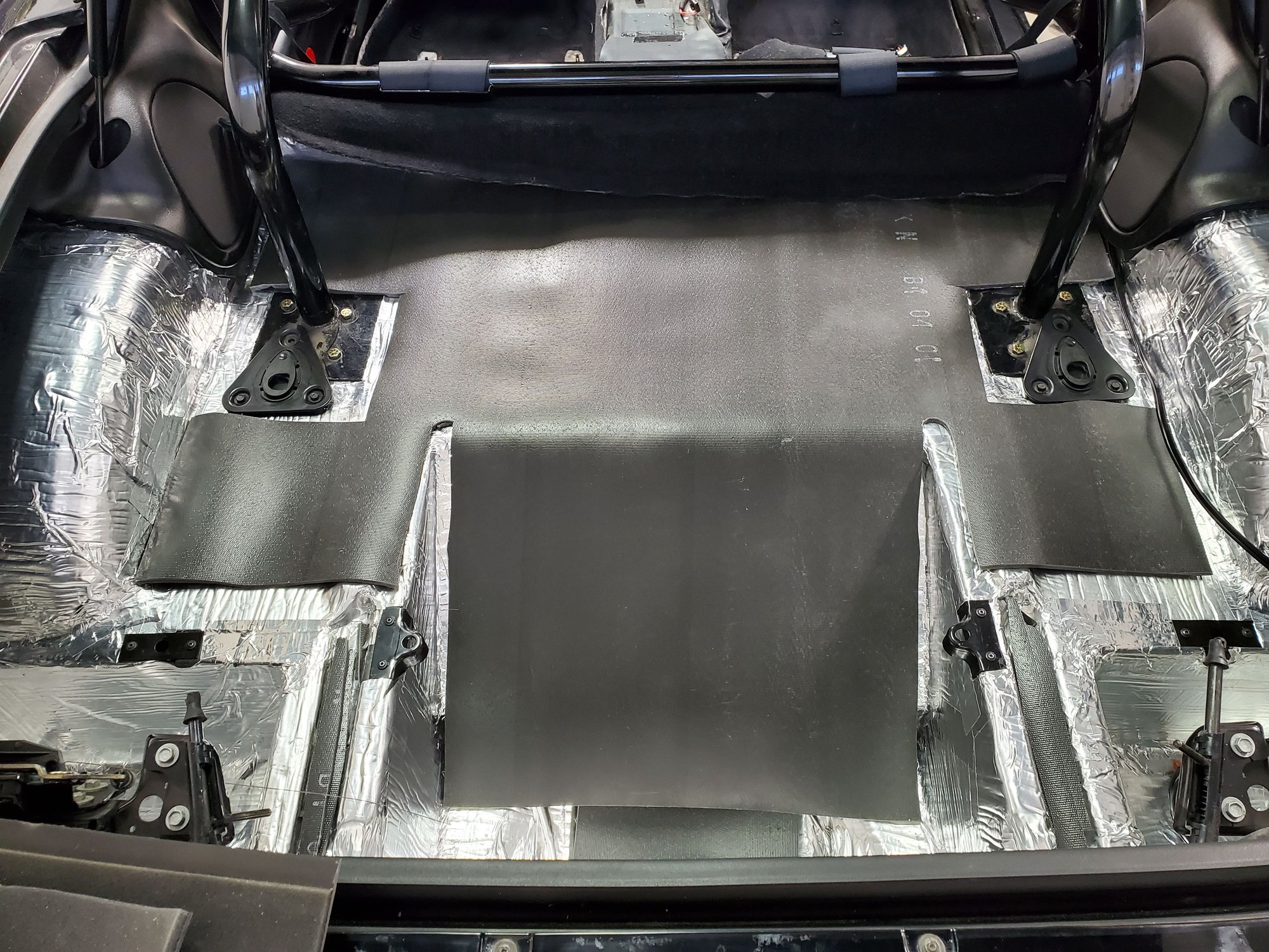

I used B-Quiet materials on my black 99. There are two types of materials, sound deadener and sound absorbing. Most people just use sound deadener which was developed to stop rattles and such. It does quiet the car down some and also cuts down on the heat. Sound absorbing materials do just that, absorb sound. It does it quite well and does a good job at cutting down on heat. Here is a link to the website:
https://www.b-quiet.com/collections/...products/vcomp
Here are some photos of my install. It was pretty easy to do, just time consuming. I did it because my exhaust was way too loud. This made a huge difference!

Wow you went nuts with the sound deadener. I was under the impression you only need 25% panel coverage to see a benefit from sound deadener. Sound absorption mat on the other hand should be 100% coverage.

I forgot to add, if you install the sound deadening, be careful. That chit is sharp. Ask me how I know,
