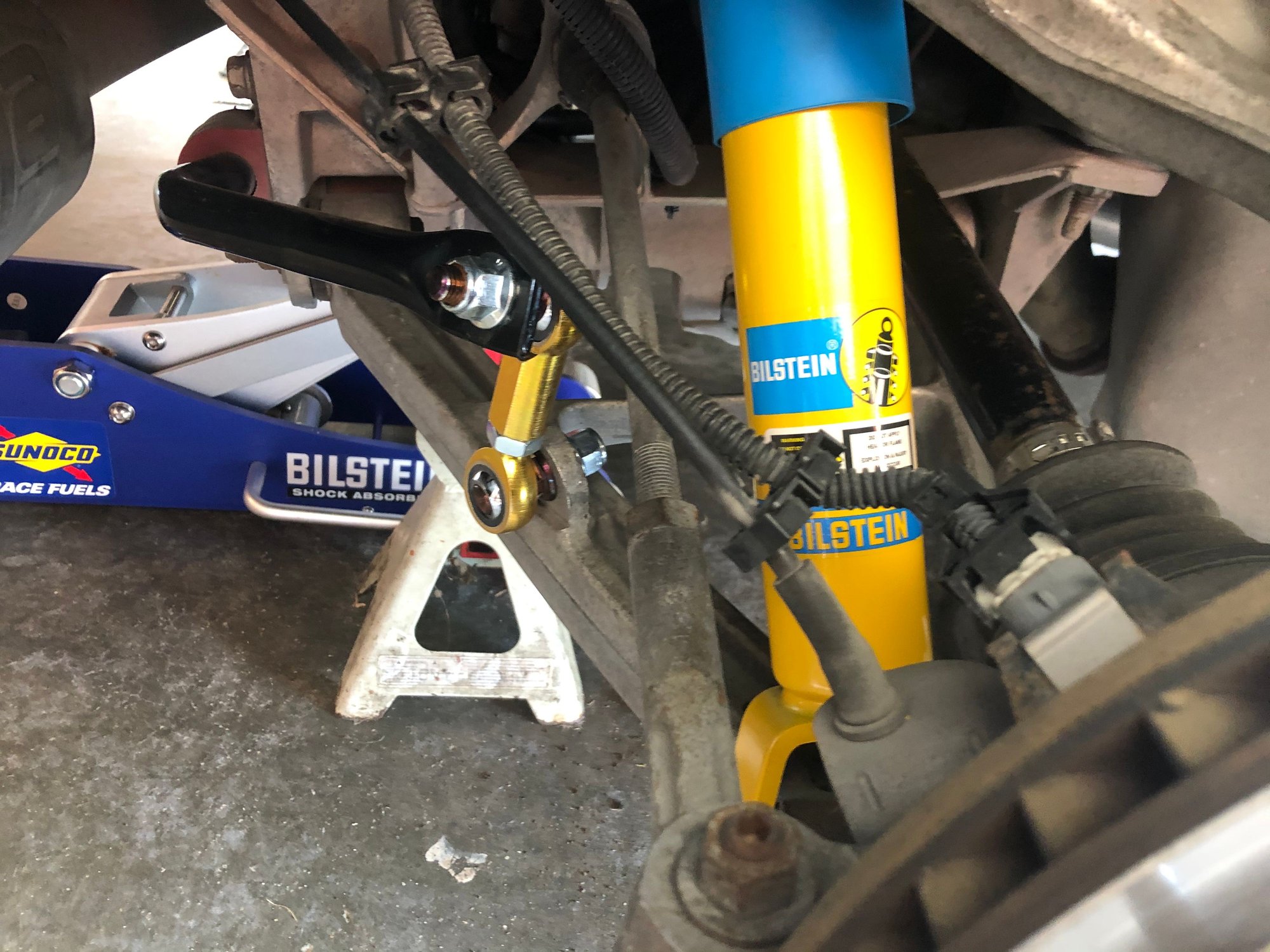

Old Sep 9, 2021 | 08:50 PM
PerryKing's Avatar
PerryKing
Joined: Aug 2020
Posts: 485
Likes: 371
From: Basehor, KS
2020 C6 of the Year Finalist - Modified
I went with the AFE endlinks. They look and feel like quality parts.

Perry,
I like the Bilsteins and sway bar set up. What is the model numbers on those and where did you buy from? Bushings too?
Old Sep 10, 2021 | 11:31 AM
PerryKing's Avatar
PerryKing
Joined: Aug 2020
Posts: 485
Likes: 371
From: Basehor, KS
The sway bars were on the car when I got it. The rear sway bar is a Steinjager and from what I can tell the front is stock. Haven’t measured it to be sure though. I planned on going with the Johnny OConnel sway bars but can’t find them with out the endlinks I already have. The Bilstein shocks are their B5s. Front PN 24-029773. Rear PN 24-029780. I got them from Rock Auto.

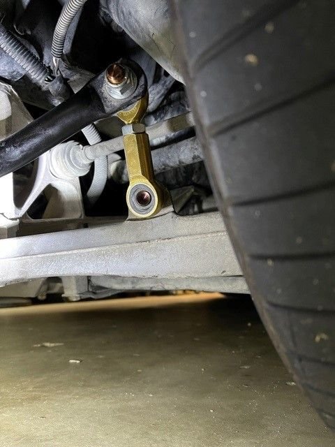

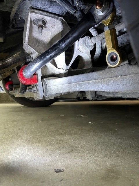

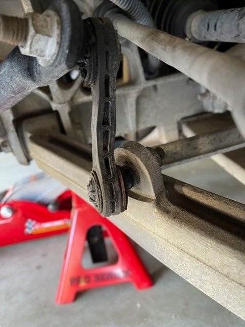

Old Sep 30, 2021 | 05:00 PM
ZO6johnny's Avatar
ZO6johnny
Joined: Aug 2021
Posts: 18
From: Agoura Hills, Ca
Happy to report, I went with the AFE's and bushings to boot.
Old and new below...
Originally Posted by smitty2919
Don't buy adjustable if you don't need them. Waste of money.
In the picture above, see how the lower span of the sway bar is parallel to the ground? That's how it should be, and if by chance you've altered the ride height of your car, you need the adjustable links, in order to keep the sway bar in that orientation.
