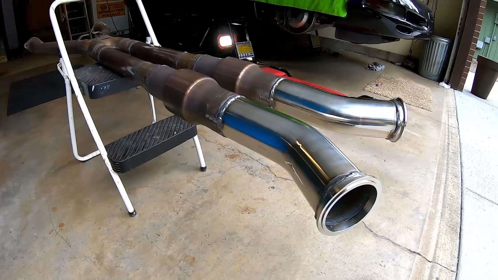

I think being able to put cats in the mid pipe was of zero concern from Speed Engineering. I would say it was 100% packaging. You would be blown away at how small the box is that both headers and the mid pipe all come in. 1 box.
Any 3 inch cat will work especially the round versions. Look for horsepower ratings when you can. You can 50 a bucks a cat or 300 bucks a cat. A lot of the cheap cats have surprising results.
Also the cats should IMO be as close to the collectors as possible. Mine are back about 4 inches because my mid pipe used to be mated to Texas Speed long tubes which are really really long.
Don't mind my booger welding. I'm a pretty decent welder but me and exhaust tubing don't get along lol.

I would actually consider speed engineering headers, if they came with a catted midpipe. I feel like it would take a lot of fab work to add cats to this system. Mr. Black, your midpipe is a Bassani, is it not?

It really would not be hard at all to add cats to the Speed Engineering setup using their kit alone. They could even be clamped in place although I just hate clamped together exhaust systems.
Yes I am running a Bassani X that I got for free from my well known tuner that I use because he hated the sound so much with the H pipe lol. I like the sound of the H pipe on a stock cam but once I changed cams it really did sound terrible. Like a farm truck mixed with a motor boat that had bad wet farts.
