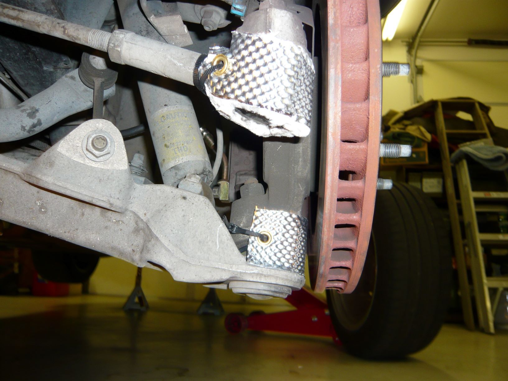

Consider insulating the lower ball joints and tie rod ends to protect the sealing rubber in these parts:

- Insulate tie rod ends and lower ball joints
