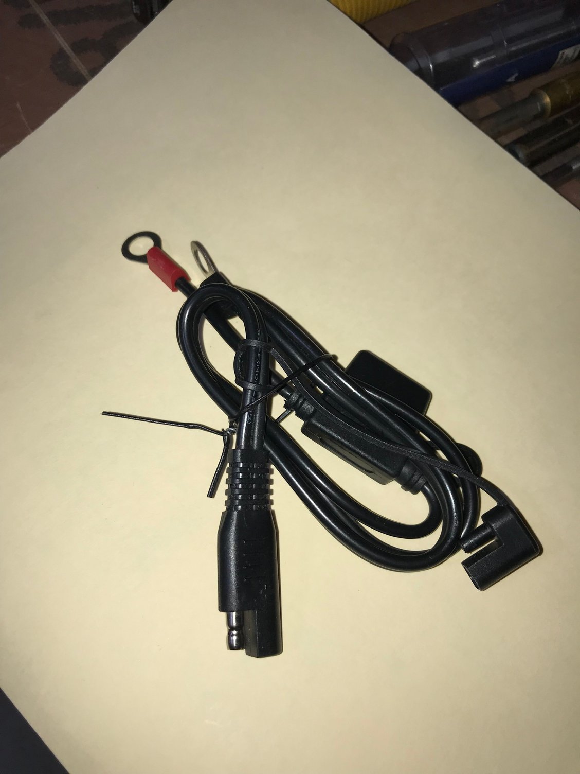

Mine is shown below, but i'm looking to do something where I don't have to open and close the hood every single time. Feel like i'm gonna wear it out. Does anyone attach the accesory cable with the rings, permanently? and can you position the cable to access the little plug with out opening hood. It would have to be up near the passenger wiper.

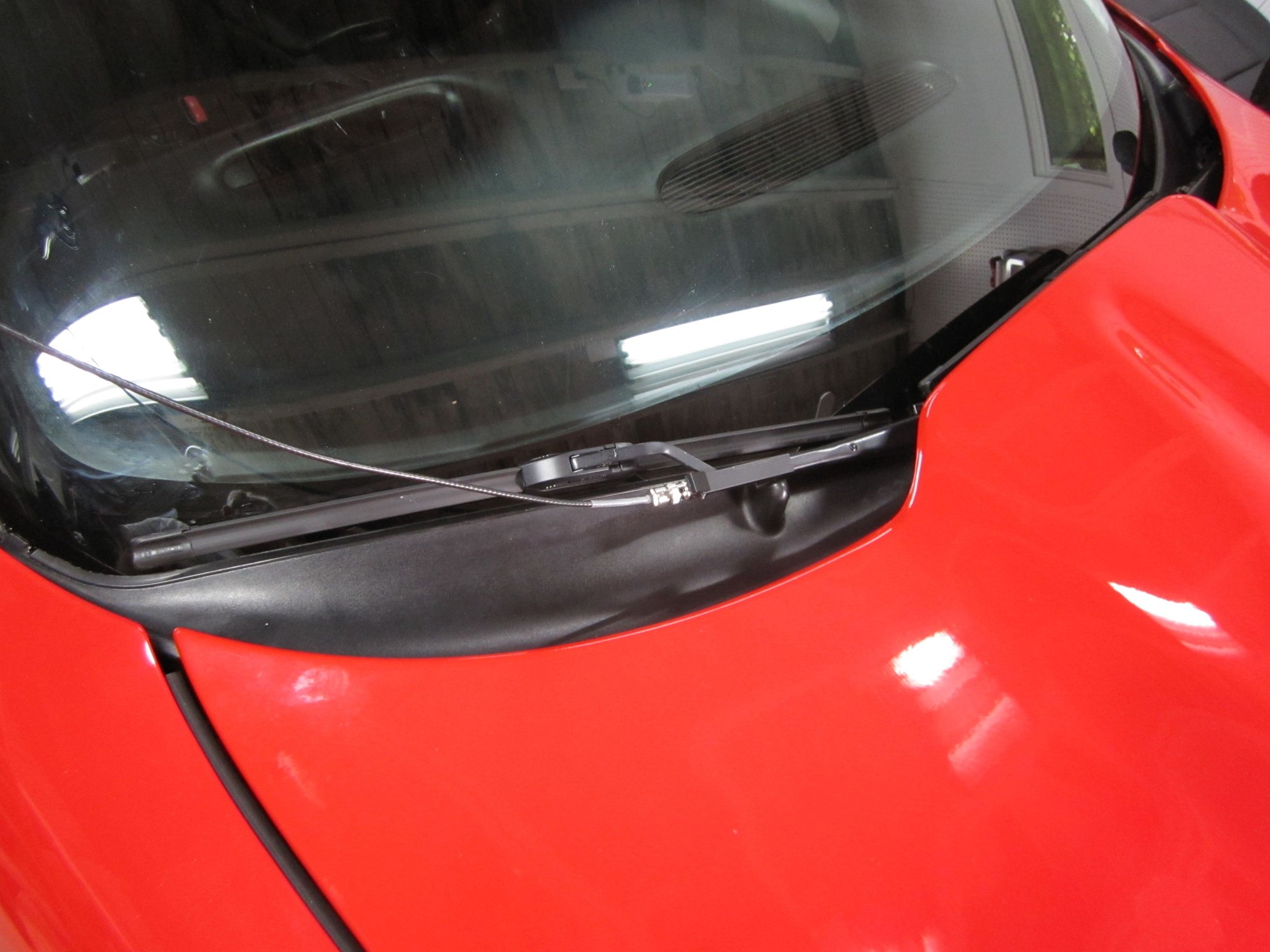

It's mounted on a retractable plug strip in the ceiling so it can easily be pulled down for use, the ouput cord loops over the plug strip before lifting when not used. BNC connectors were used to connect the charger output to the wiper arm, when plugged in it looks like a hospital IV.
A closeup of the wiper arm, the cord BNC has the outer shell removed so it can detach just by pulling it out in case the wipers are turned by accident when plugged in.

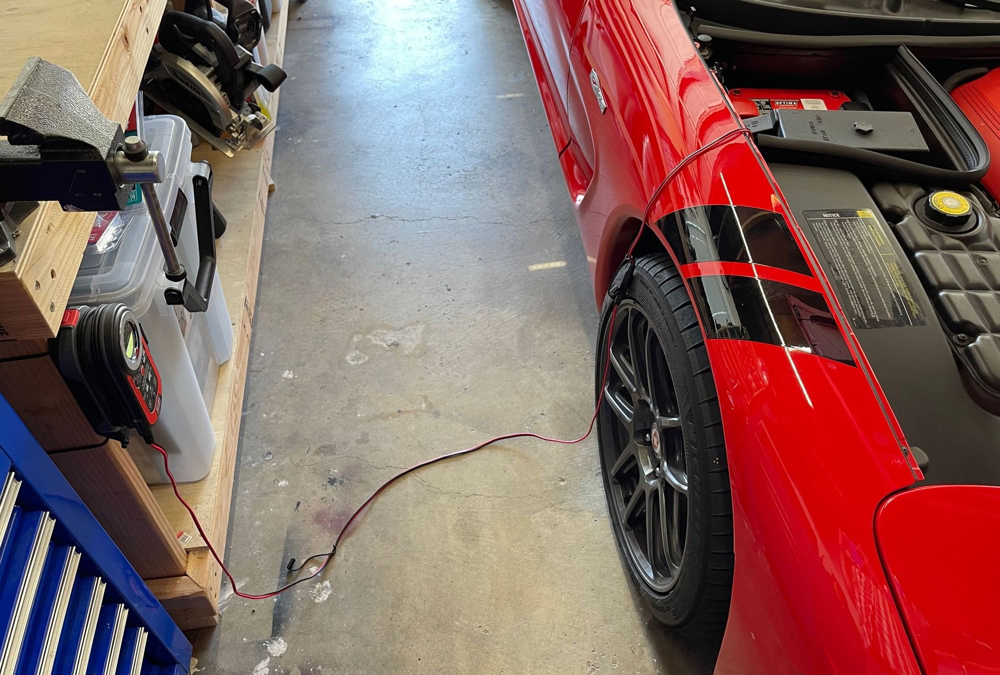

I run an Optima charger for my Optima Red Top battery and the pig tail is routed to/through the side fender cove.

See if this link works-
Amazon Amazon
Also-
AYECEHI 12AWG SAE Cable,SAE to SAE Solar Weatherproof Socket Sidewall Port,SAE Cable Quick Disconnect Connect Panel Mount Universal Flush Mountable Connector - with Mounting Screws [Male to Male]
Old Sep 27, 2021 | 12:13 PM
djohn3853's Avatar
djohn3853
Joined: Oct 2020
Posts: 389
Likes: 170
From: Rhode Island
St. Jude Donor '21
https://www.amazon.com/AYECEHI-Weath...7X1DCNK1&psc=1
Also-
The link worked for me. put one in my cart. Thanks for the info

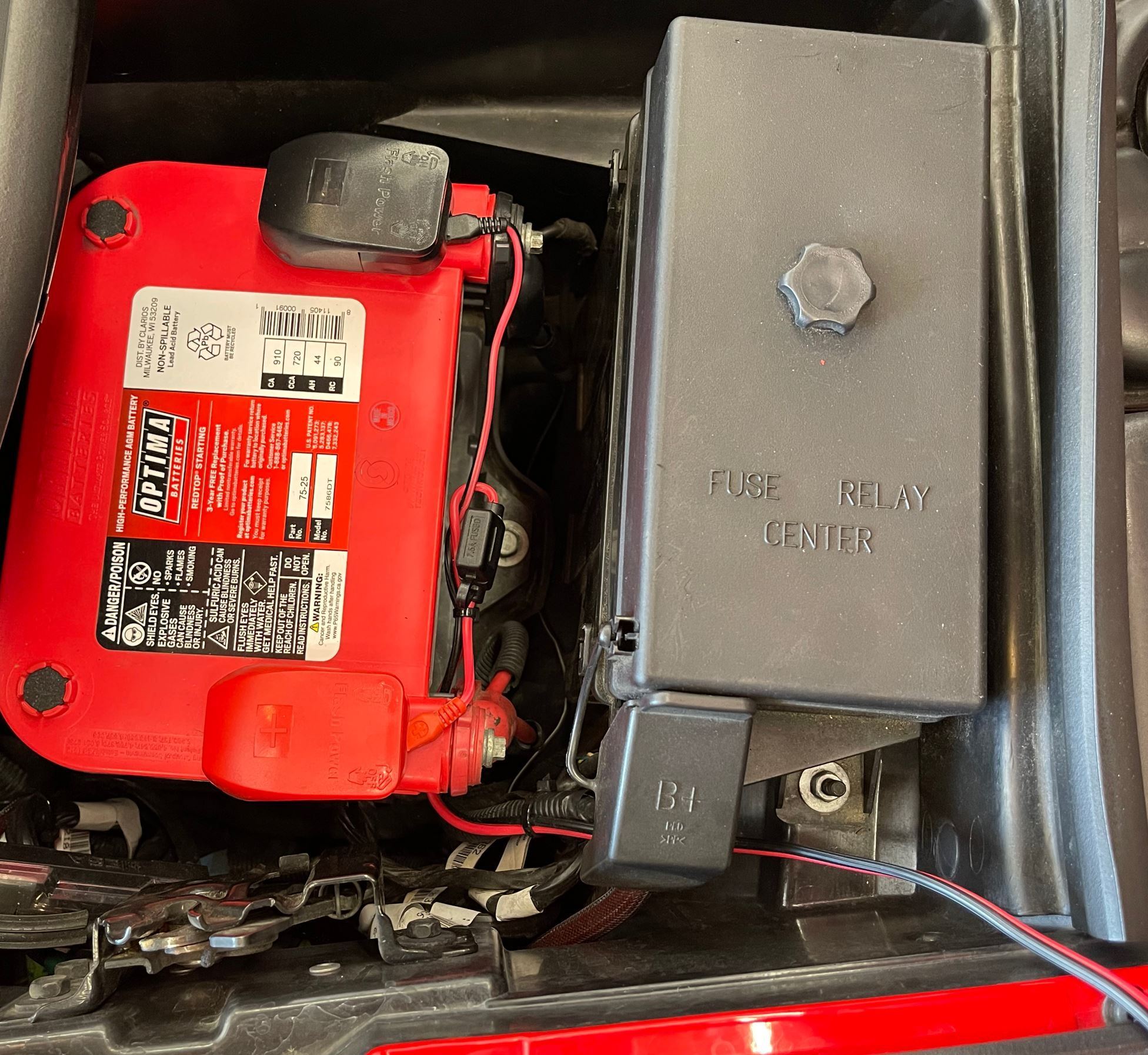

This is my setup:
