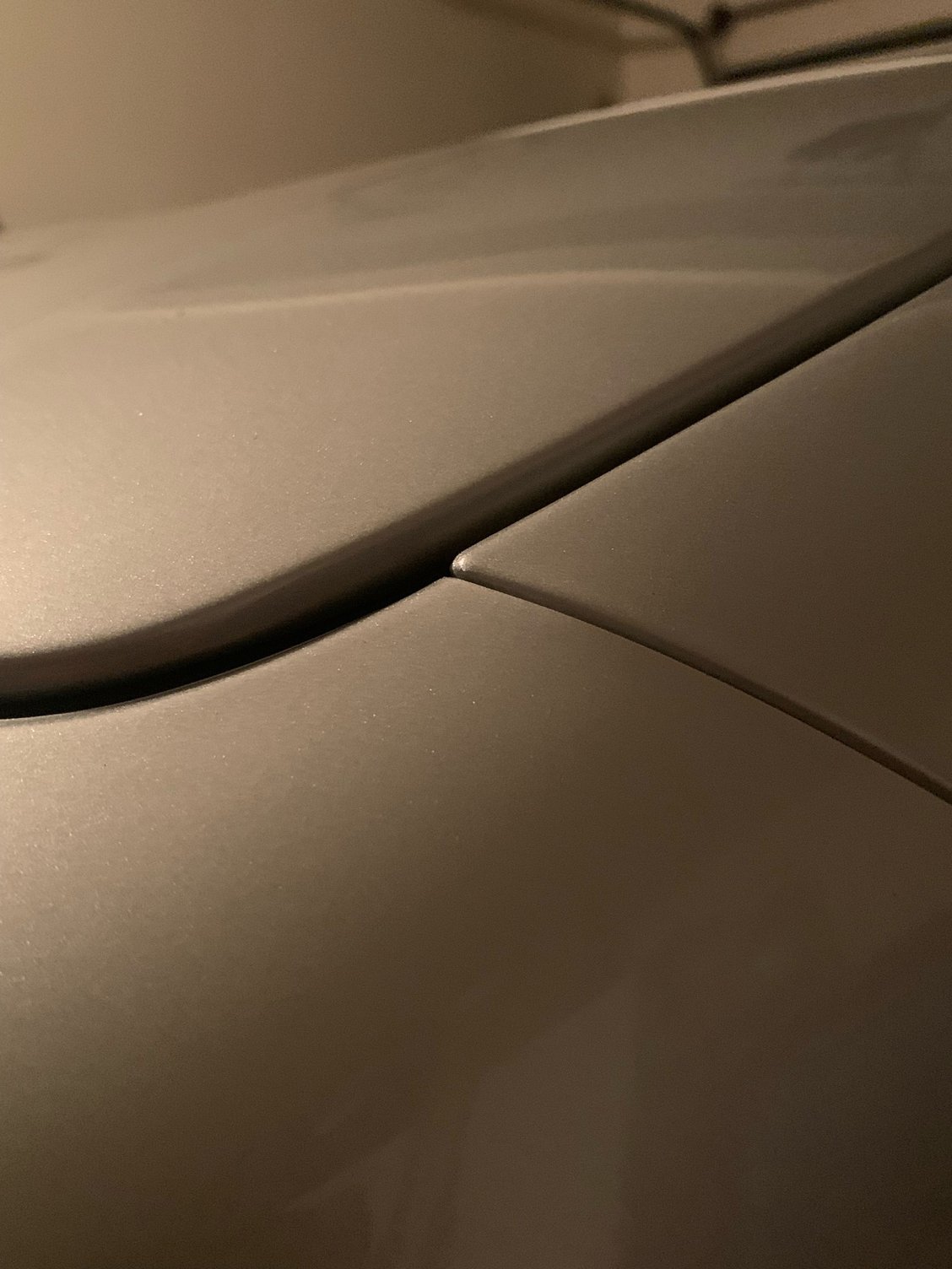

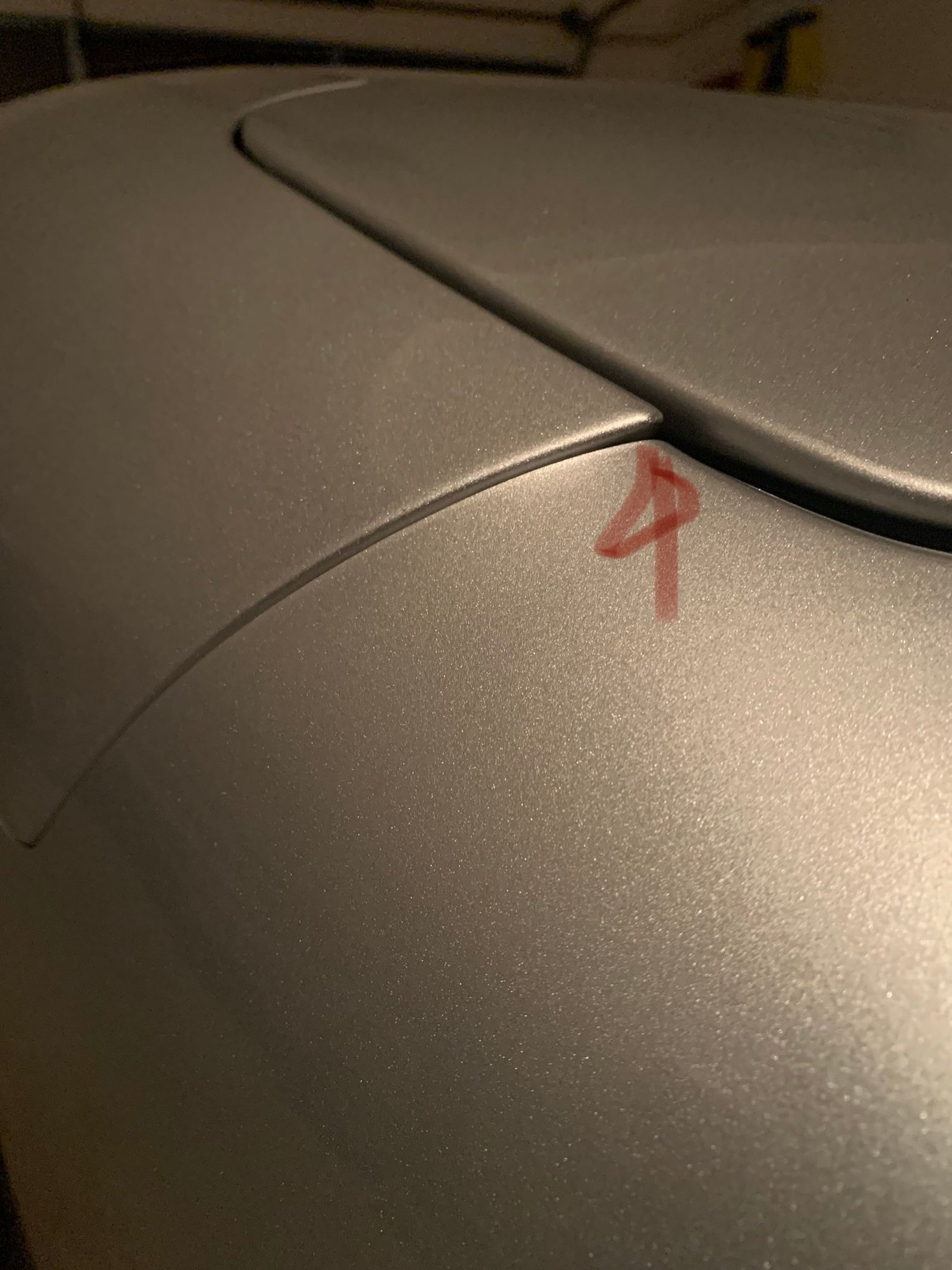

Default Does this look normal

Post a pict of the full front so we can see the bumper totally and the joints.

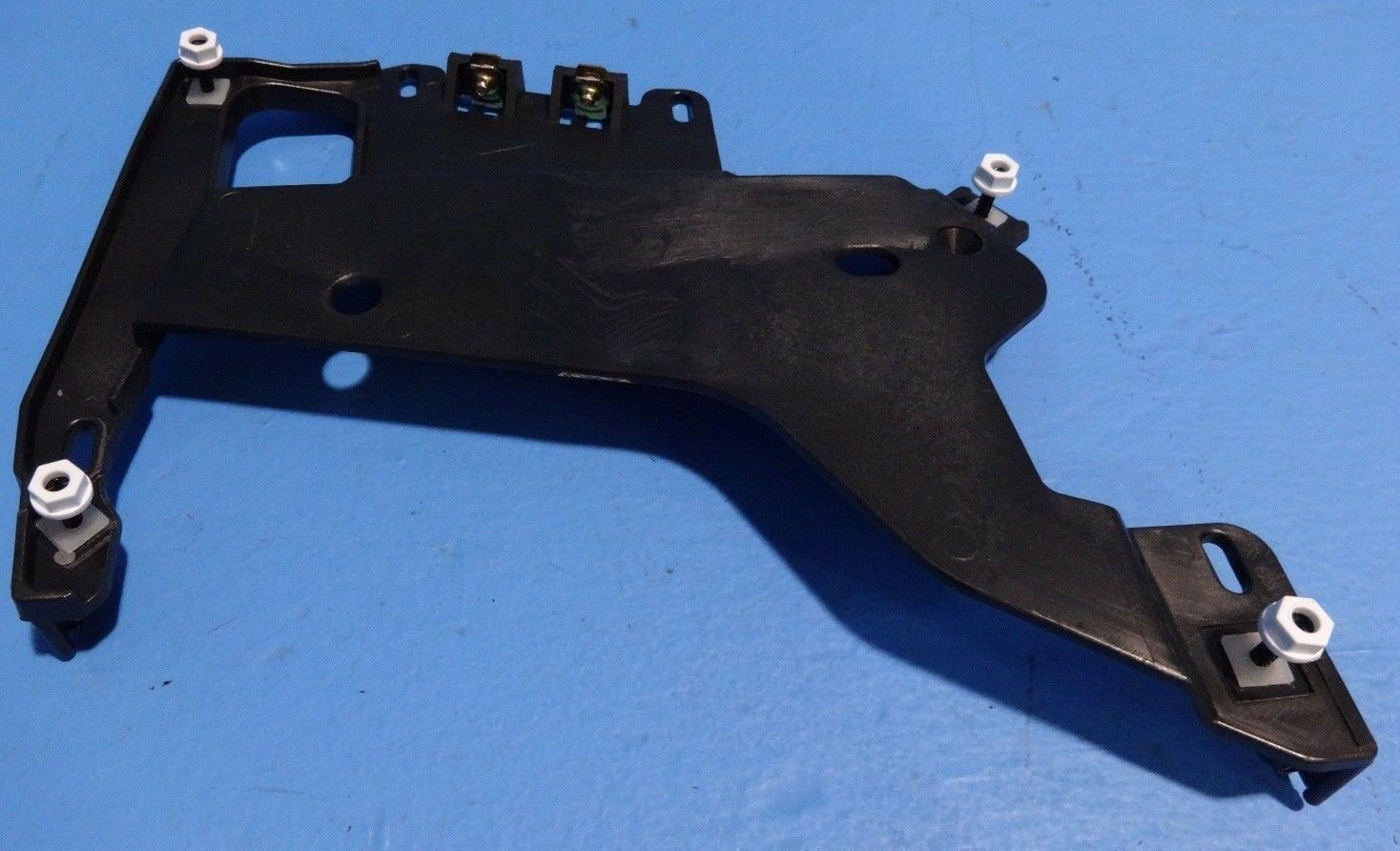

Take the painted cover off and you can tighten the 4 white screws to lower the lid clearance so it can sit lower/flush.

Needs some adjustment. It's really annoying for people with OCD to get the bumper/fender/headlight cover gaps equal and nice LOL.

As others have said, it can be adjusted to be better. However, I don't think there's anything actually wrong with the car. It isn't damaged or anything like that. You'll just need to play with it until everything lines up the way you would like.

it looks better than most, I tried to get my hood and stuff better and after a day of fruitless labor put it back where it was to begin with !!!

The alignment of the panels looks to be a bit off. Good luck with any adjustments you may try.

Originally Posted by J991
I picked up the car last week low miles everything works fine and just was going around and I noticed the right side fender which meets the front bumper sits higher than the left side. Could this be a chev thing and just the way it is.
I think you can make it look better by having the headlight covers adjusted.
