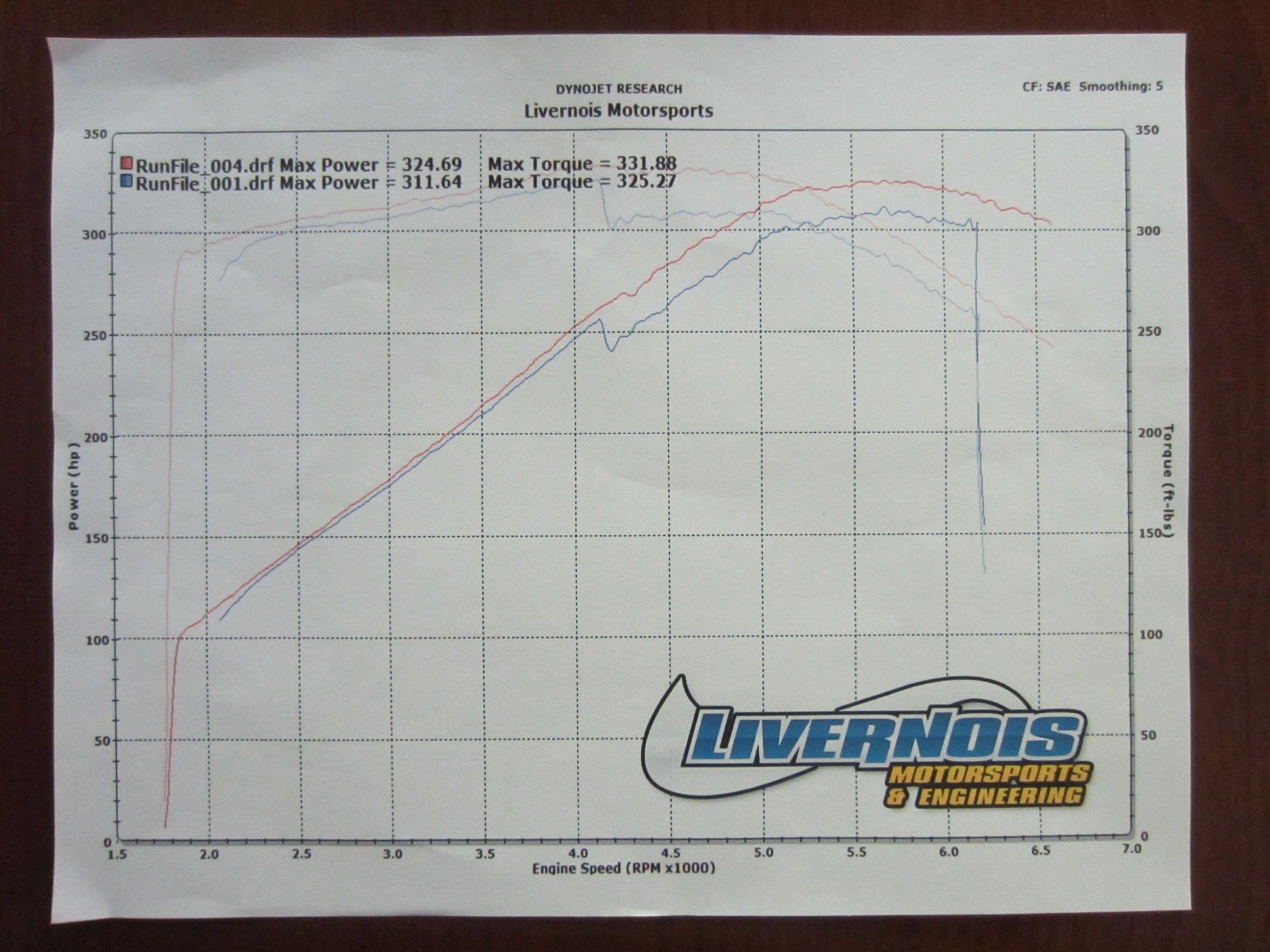

'97 MN6 w/Callaway Honker and B&B Triflow axle-back as the only engine related mods...
