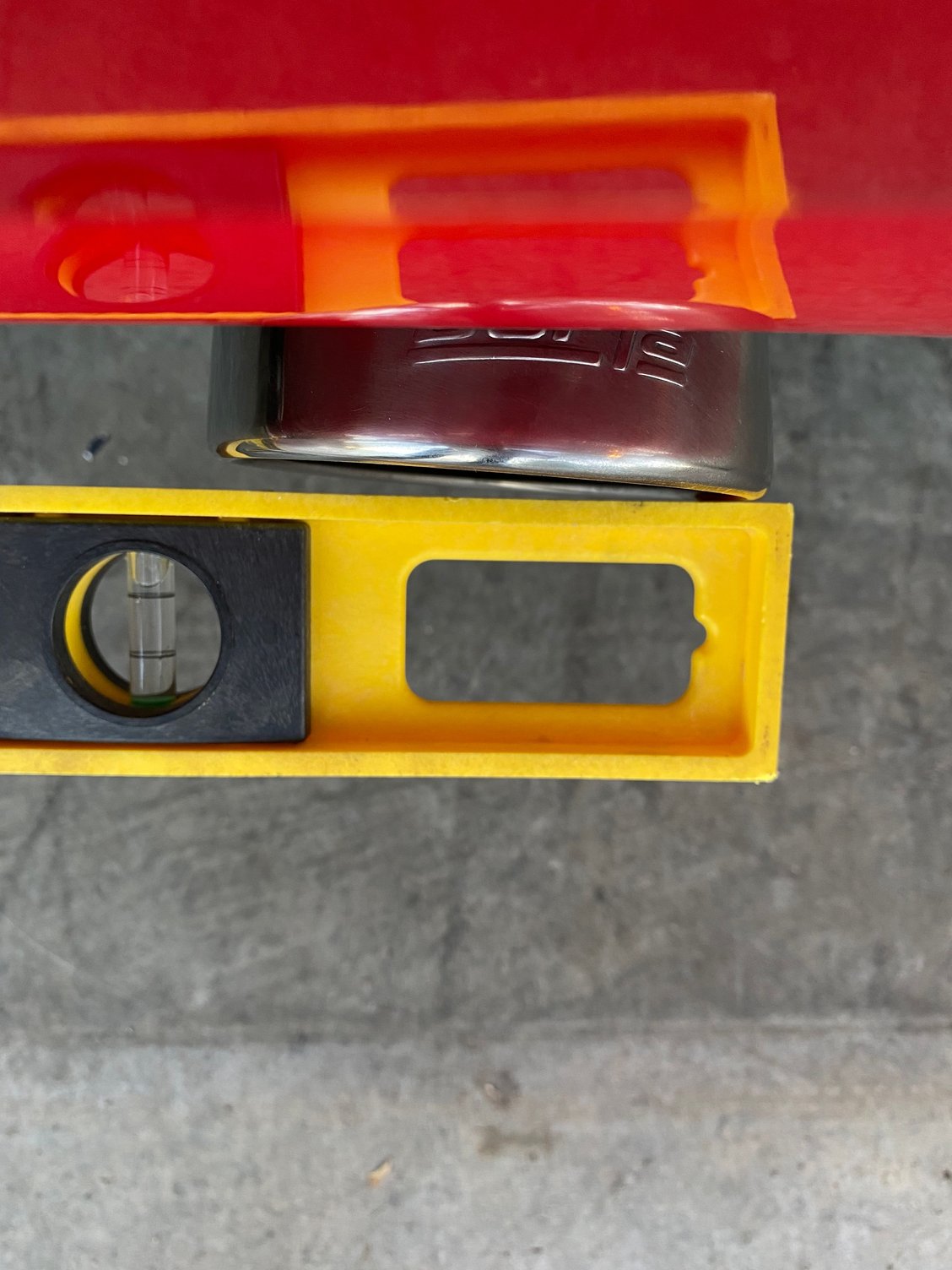

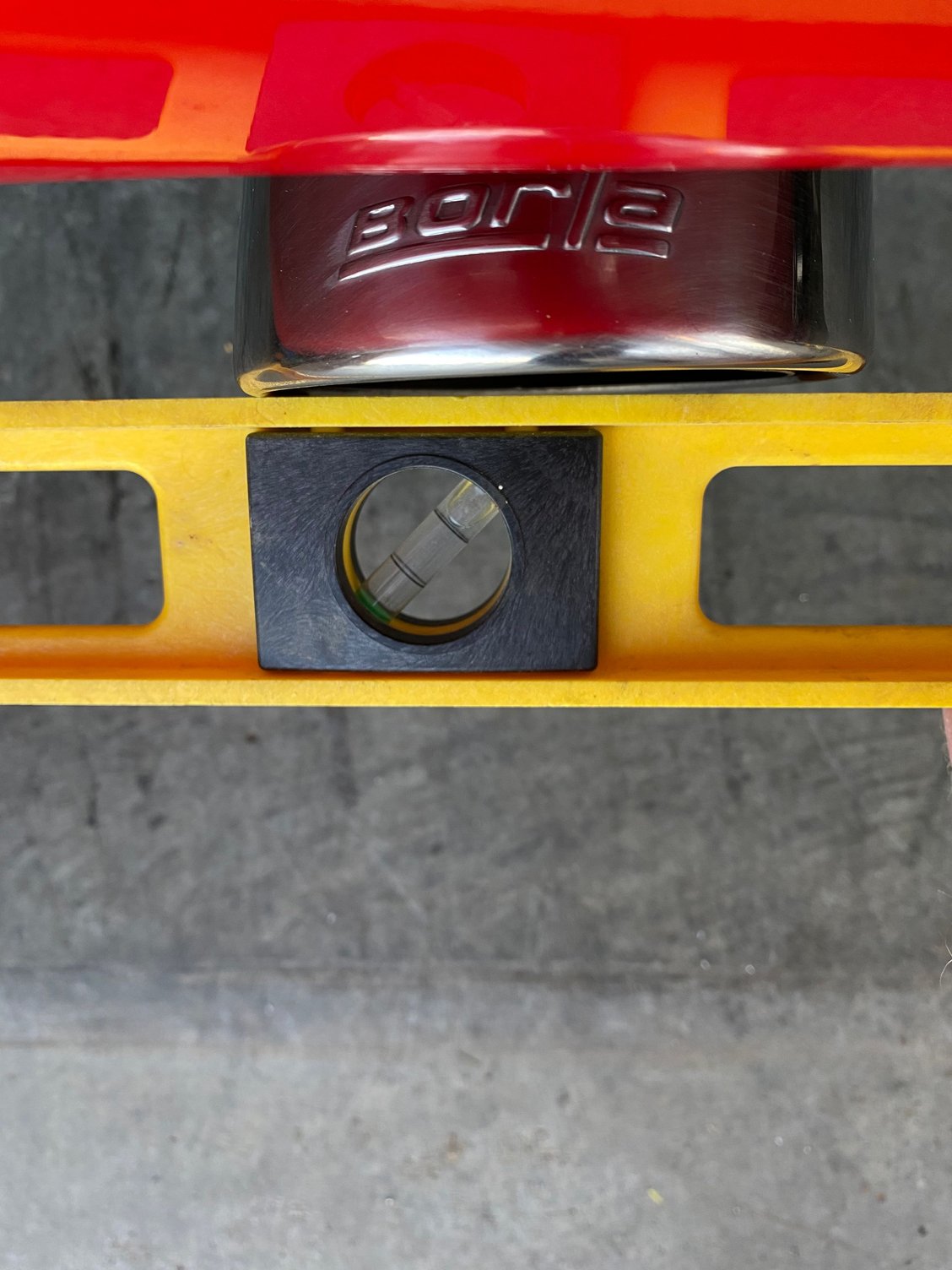

Thought I had these pretty even but I noticed they are off and can’t quite figure out how to align them. Any ideas? They are level up and down and side to side but Angled in. Passenger sided tipped in more than driver.

Manufacturing variations on both car and exhaust. I dont think youre going to get it perfect.

A true exhaust installer would cut the pipes and weld it straight. There is another way, loosen all the attachments and bang things till they are free. Align the pipes until the tips are true and tighten. Cheapest and fastest is to cut the pipes and re-weld

Had a shop install my quad tip Stingers, instead of using the supplied clamps, he welded each joint after alignment. So far so good

That would definitely drive me nuts. I've heard some people welding to brackets first but there's supposed to be some play in the exhaust pipes.
