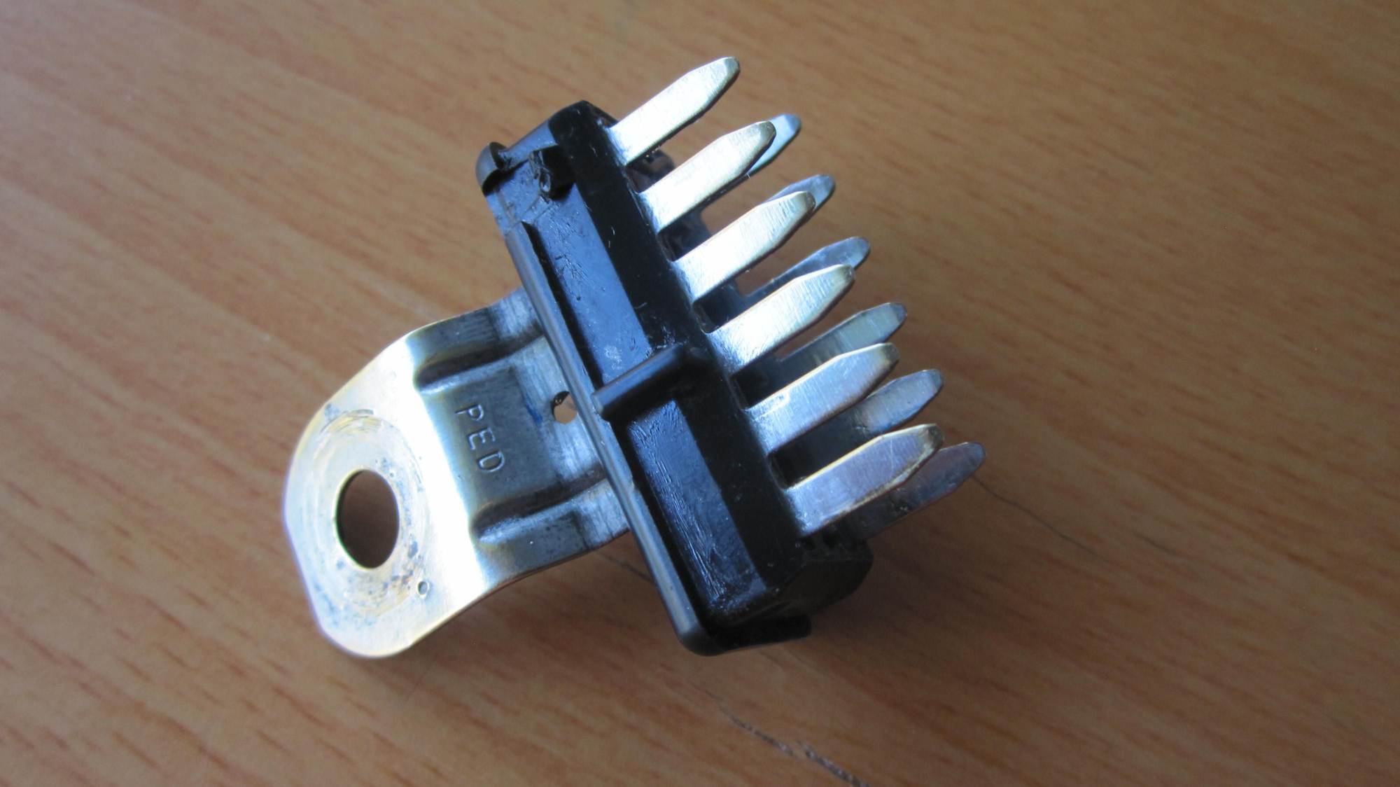

I removed the multi-pin (non-wire side) part of the connector and polished the metal with metal polish using a Dremel wool felt bit. Some "Super Lube" anti-corrosion and connector gel from Synco Chemical Corp. was added to the pins and main connection to the car frame.
Here's one after polishing and cleaning.

That is one clean connector. Nice job you did there.
