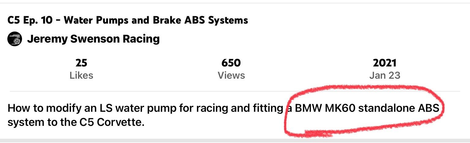

^ Been done. MK60 conversion.
https://www.corvetteforum.com/forums...nationals.html

Old Oct 30, 2022 | 03:24 AM
vette4fl's Avatar
vette4fl
Joined: Feb 2021
Posts: 6,469
Likes: 4,312
From: Florida
Originally Posted by Stingroo
BMW stand-alone abs. Scrub video to 10:45
