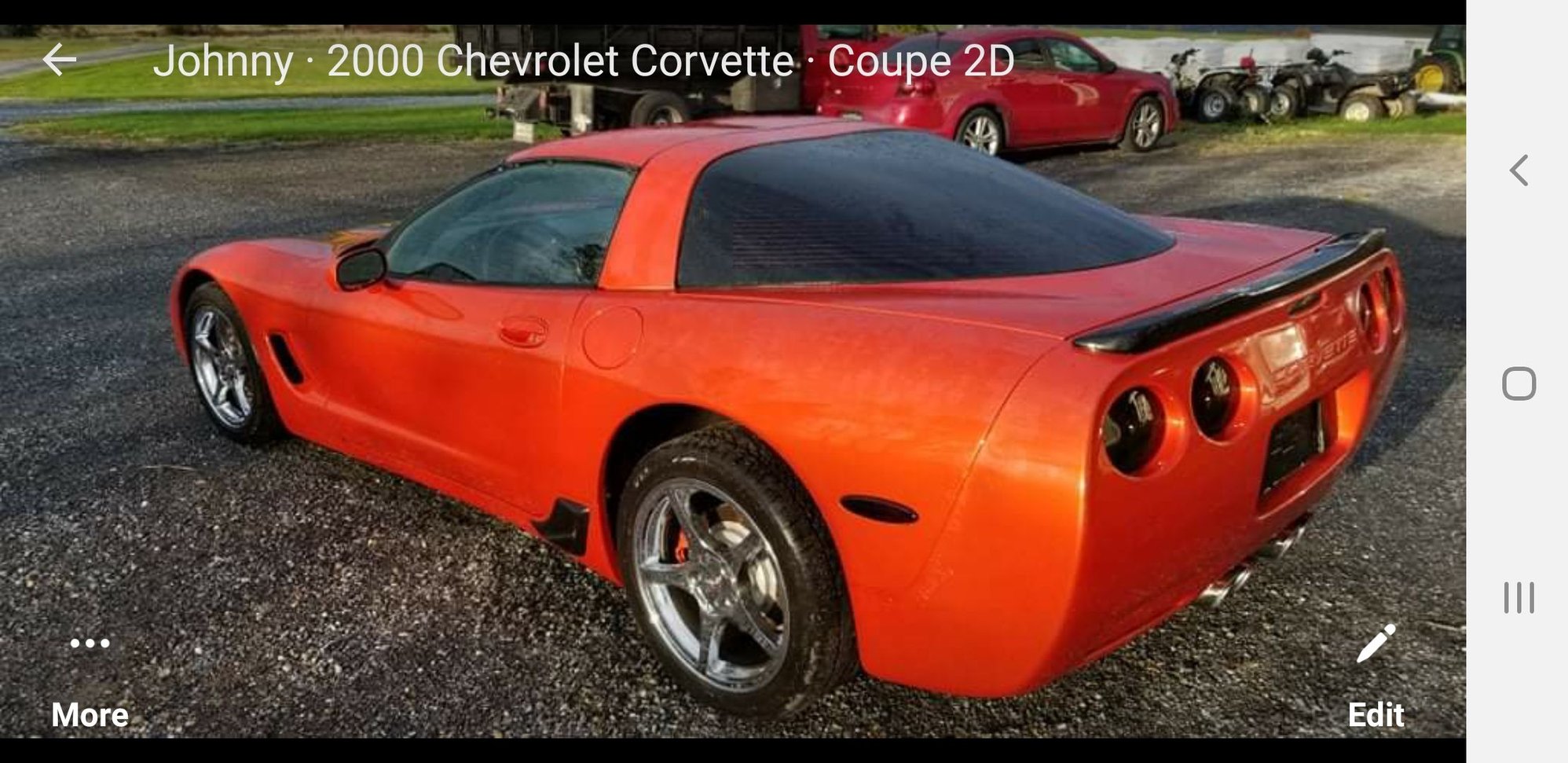

How can I find out the color my 2000 corvette when it was new. Bought in vermont with reg no title
Don't think this is stock color

That is not a factory color.
If that paint job (is it paint or vinyl wrap?) isn't crazy thorough, you could start by looking at door jambs, engine bay, under carpeting, behind door panels, etc.
You can also look at the RPO sticker in the glovebox for codes, and one of them will be a color code. Pic of that and we can tell you what color it was when it was new.

It is paint, checked jams, removed part of weather stripping checked under hood same color. They did a great job

I'm envious of that thorough paint job, I'm wrapping my car in spring to be orange.
However, the spiral gray shown in your code was available for 2003-2004, and you say yours is a 2000.
I'd pop your vin into a vin checker to figure out the actual year. There's a lookup table to find out what exact day your car was made as well.

I do like the color.

So first post says "don't think this is a stock color" but I think it technically is, just not stock for that car. My guess is factory daytona sunset orange from the C6.
