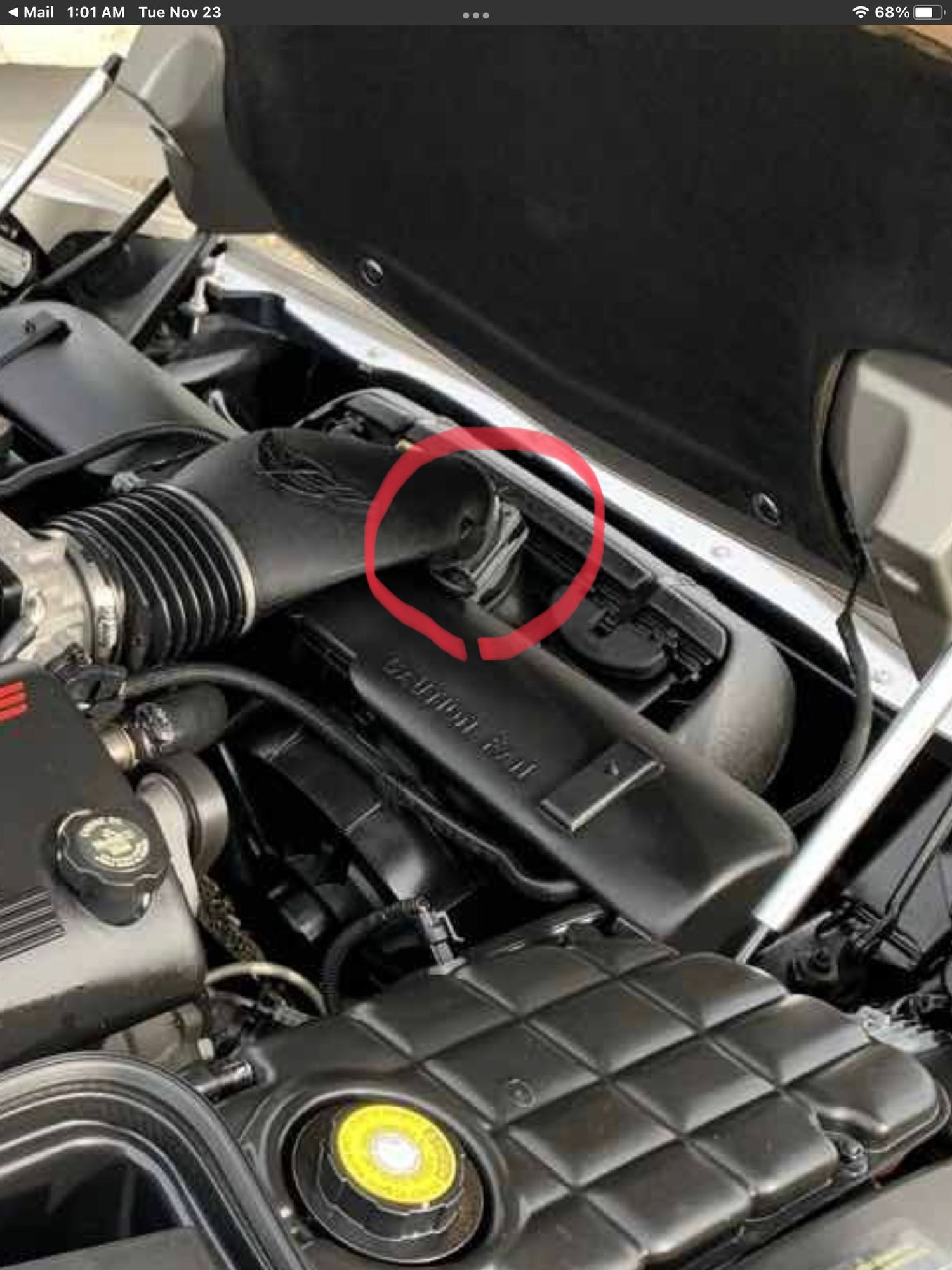

Something looks funny near the air bridge to air box connection. Is this just my old eyes playing tricks?

That's the MAF, looks normal to me.
