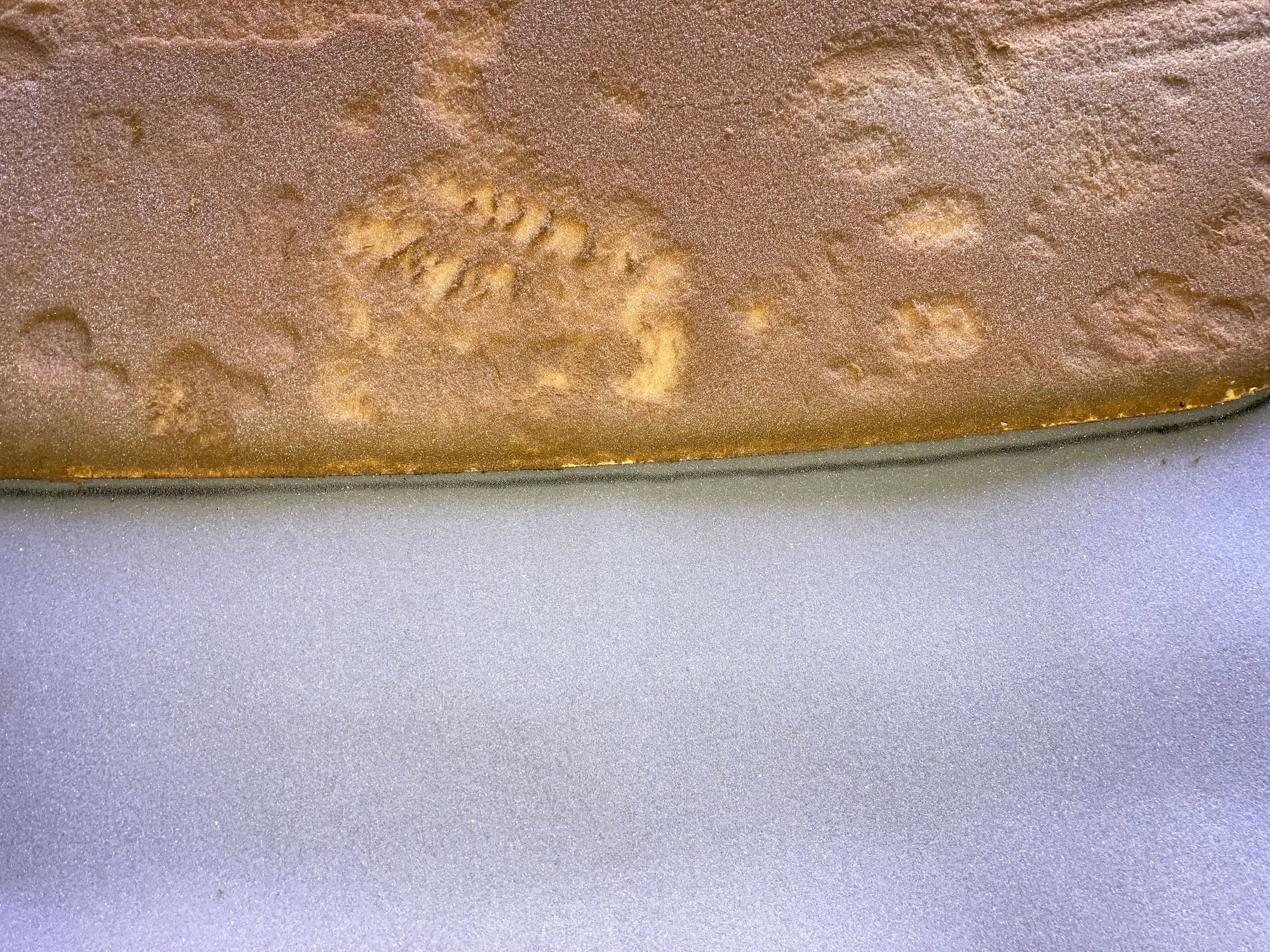

Just wanted to document my headliner replacement, in case it helps someone else. My headliner started sagging last year and I tried to use spray glue to glue it back up, but I guess the foam just kept disintegrating and it fell down again.

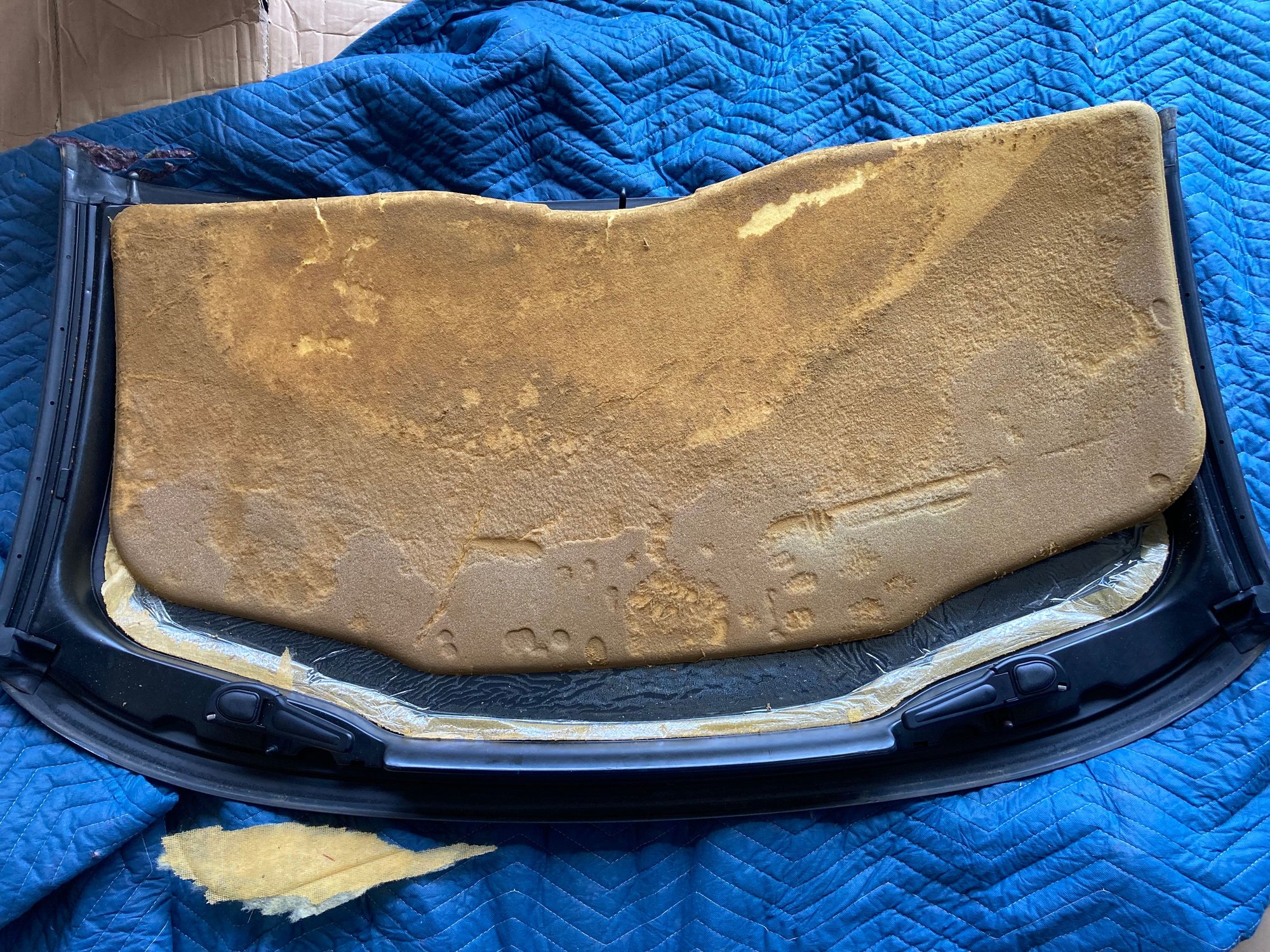

The stock headliner is composed of a formed foam layer with a layer of fabric basically glued on the outside. The fabric wraps around to the back of the foam, and the thing is stuck to the roof with basically a huge piece of double sided tape.
I pulled off the fabric. It came off real easy because the outer layer of foam was disintegrating—just getting old. Here's the foam piece without the fabric:

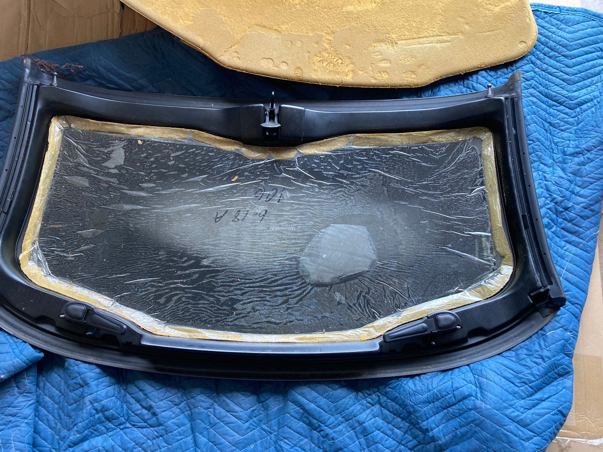

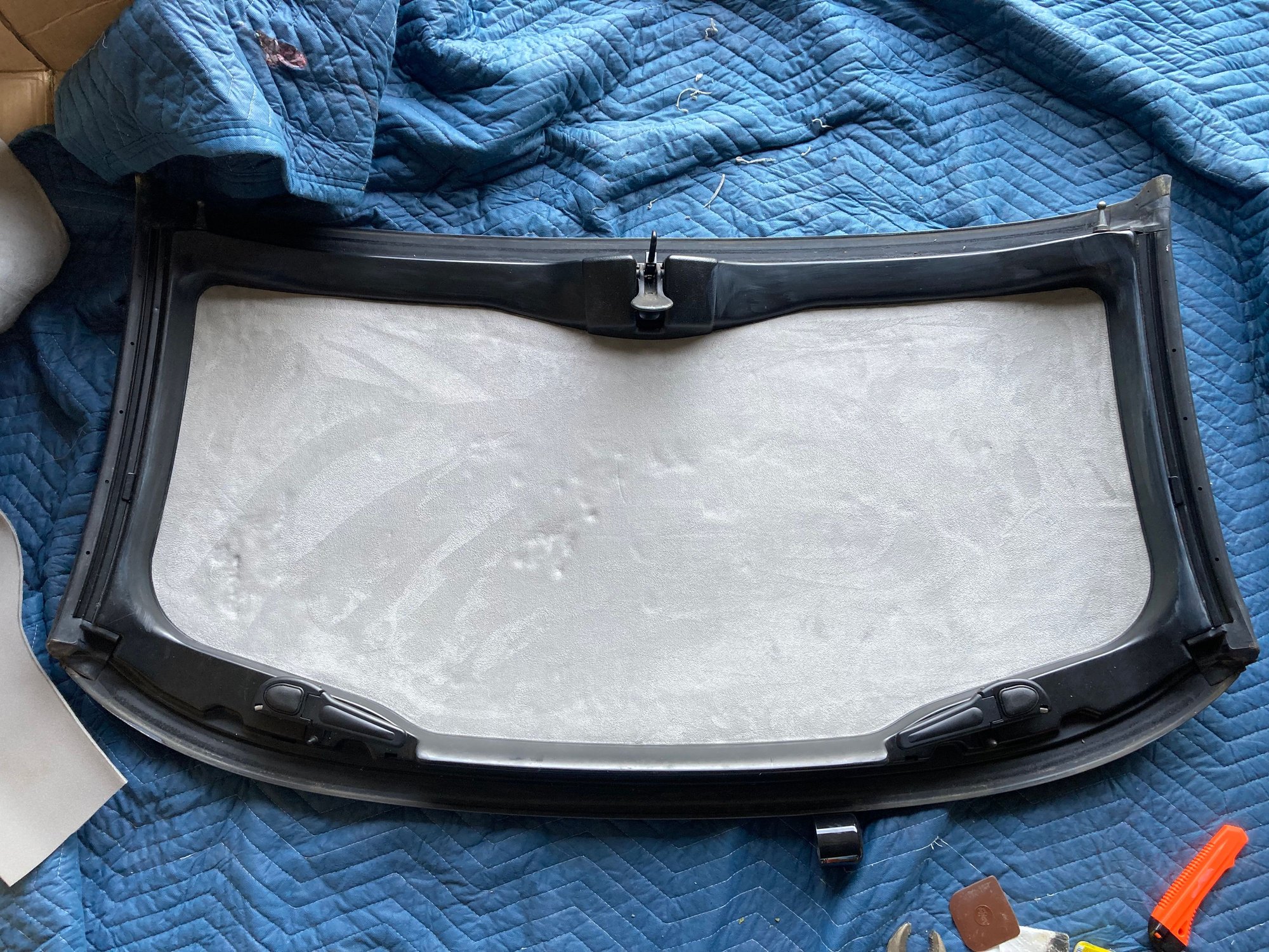

Here's the huge double sided tape:
The adhesive loses power over time, especially where the foam starts to disintegrate.

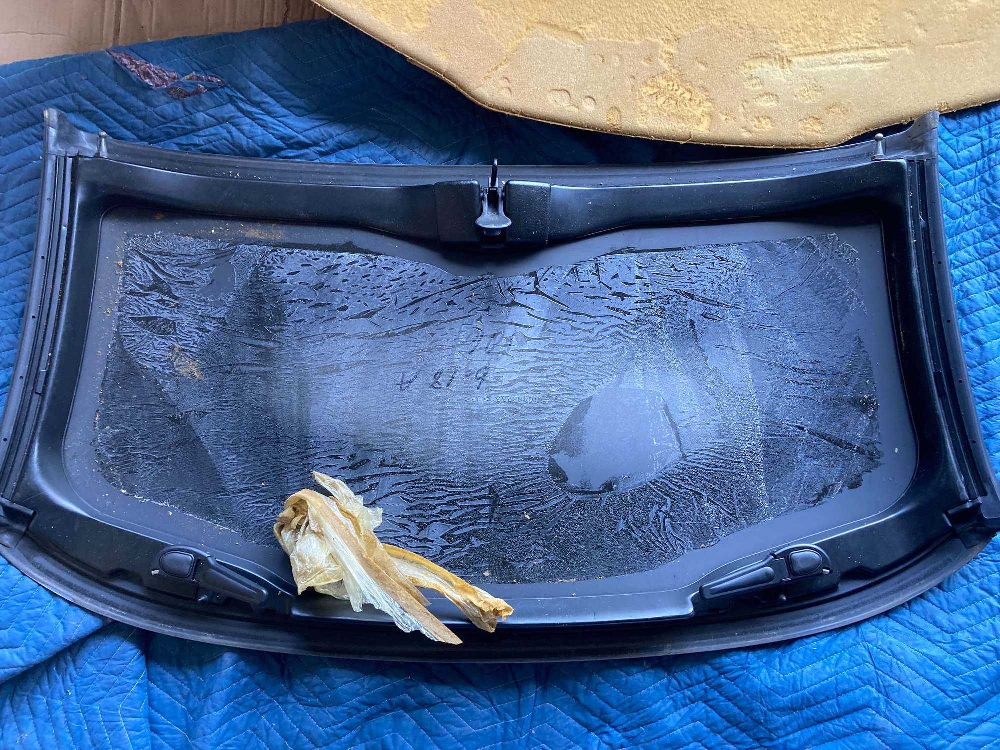

I used my trusty HF heat gun and heated up the tape to help peel it off. The wadded up tape is at the bottom here:

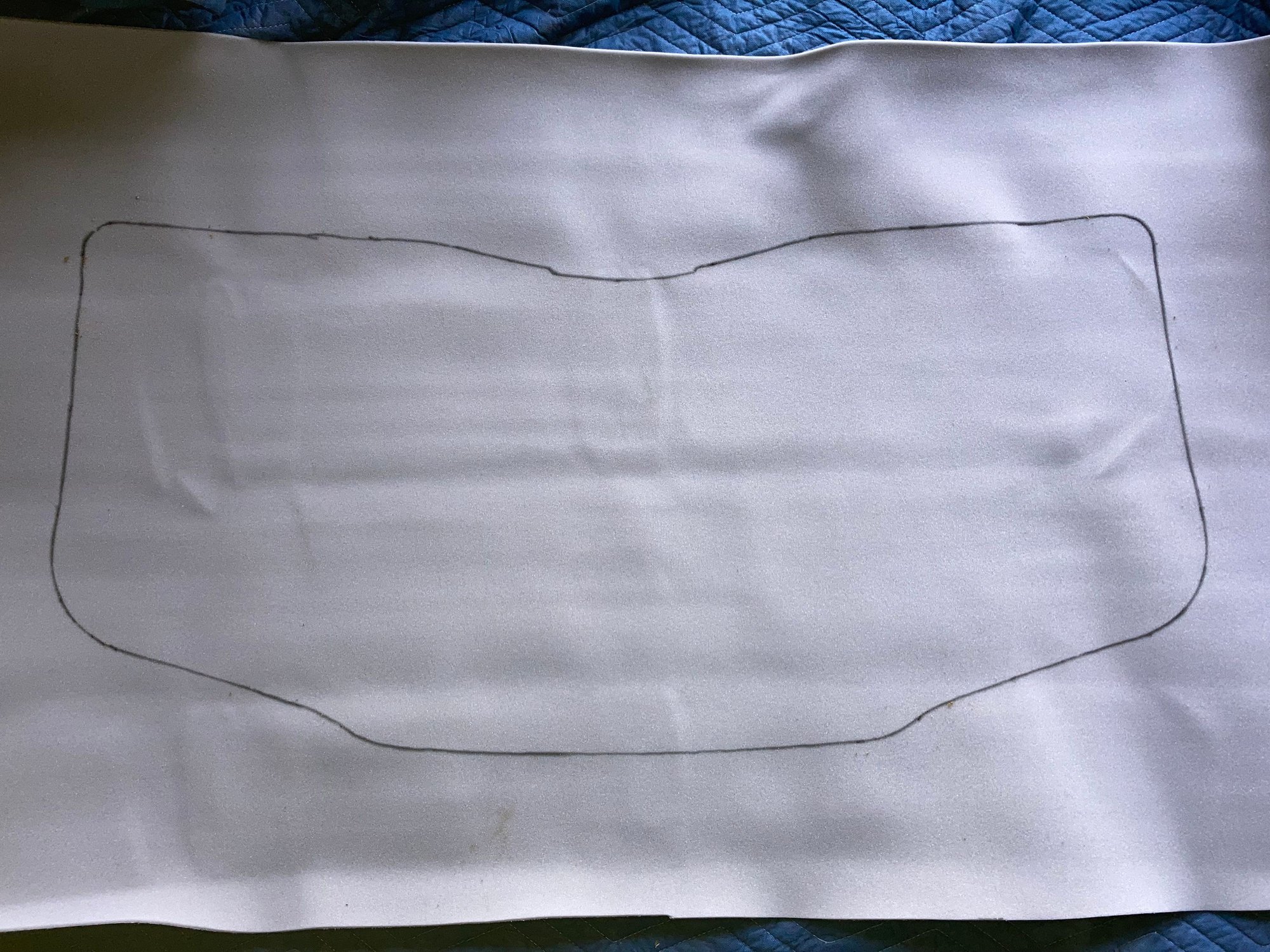

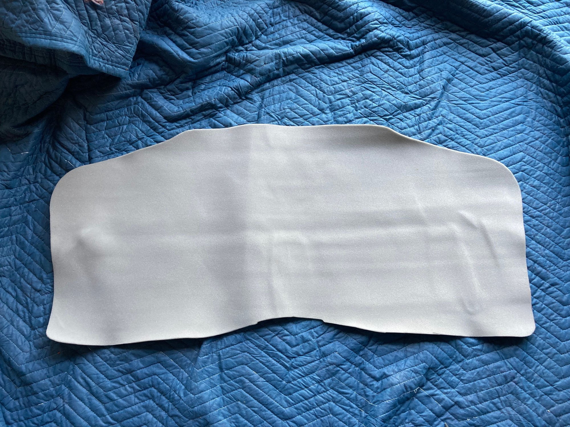

I laid the foam piece over the fabric and used it as a template to draw with a Sharpie on the back of the headliner material, which I got from
Amazon Amazon
I cut it out with scissors:

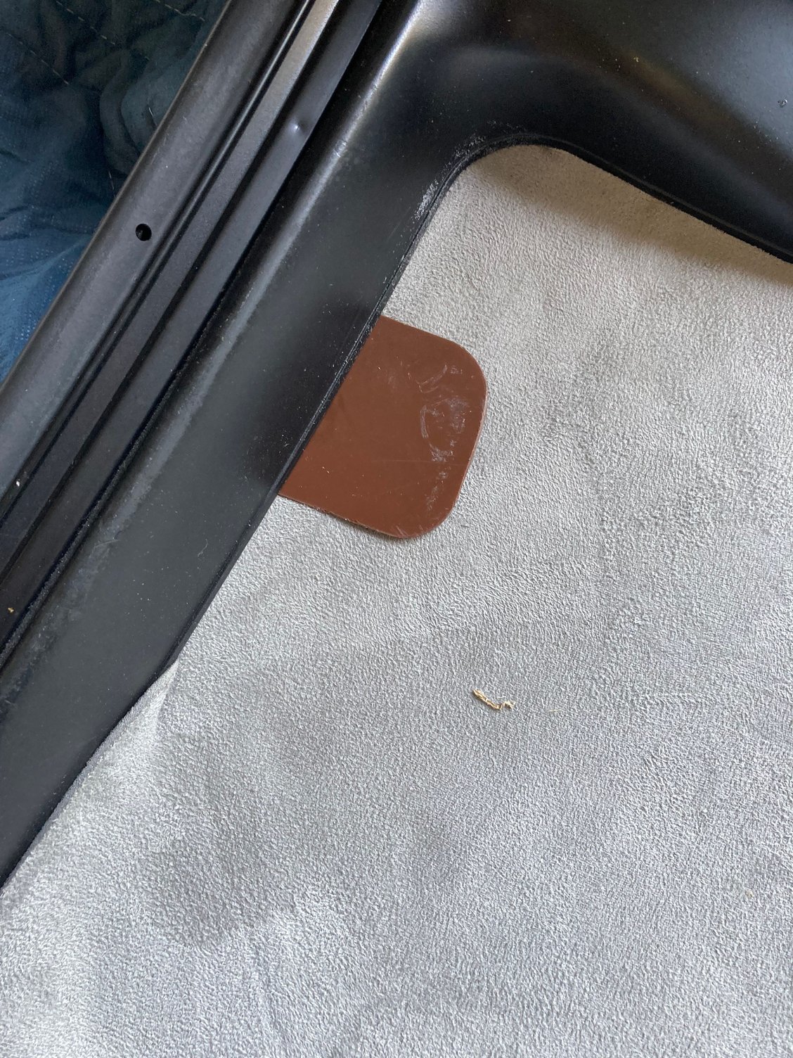

I sprayed Gorilla Spray Adhesive on the top and on the back of the headliner, and folded it back over onto the top. I'd cut the edges just a few millimeters larger than the "hole" in the top, because the edge of the headliner gets kind of tucked under the molding of the top. I used a plastic scraper to tuck the headliner edge under:
Part of the top, near the back didn't really have much room to tuck, so I just used a utility knife to cut off any excess there.

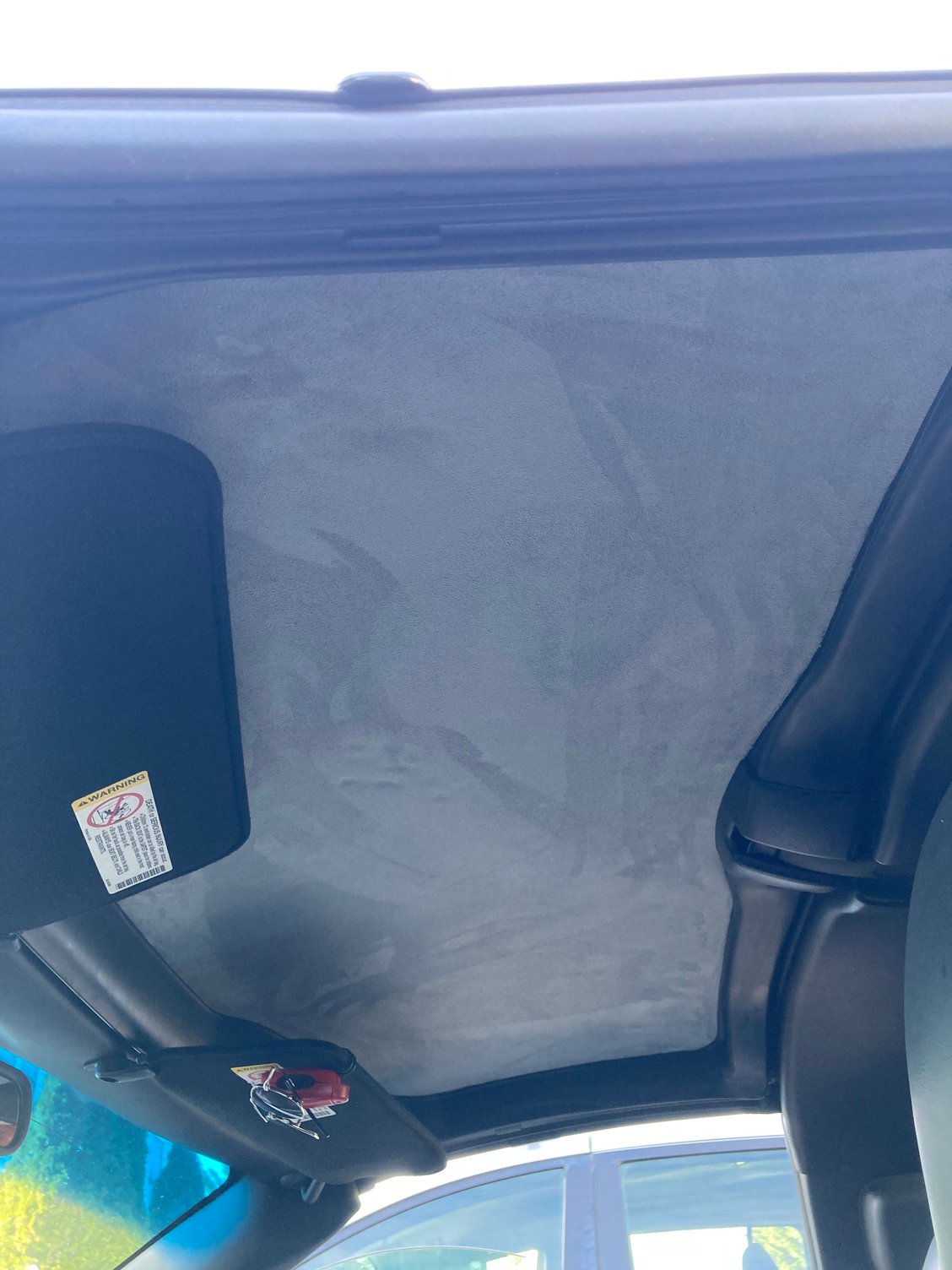

Finished product:
In place:
I used a grey headliner instead of the OEM black, because I thought it might make the car feel less dark inside.
