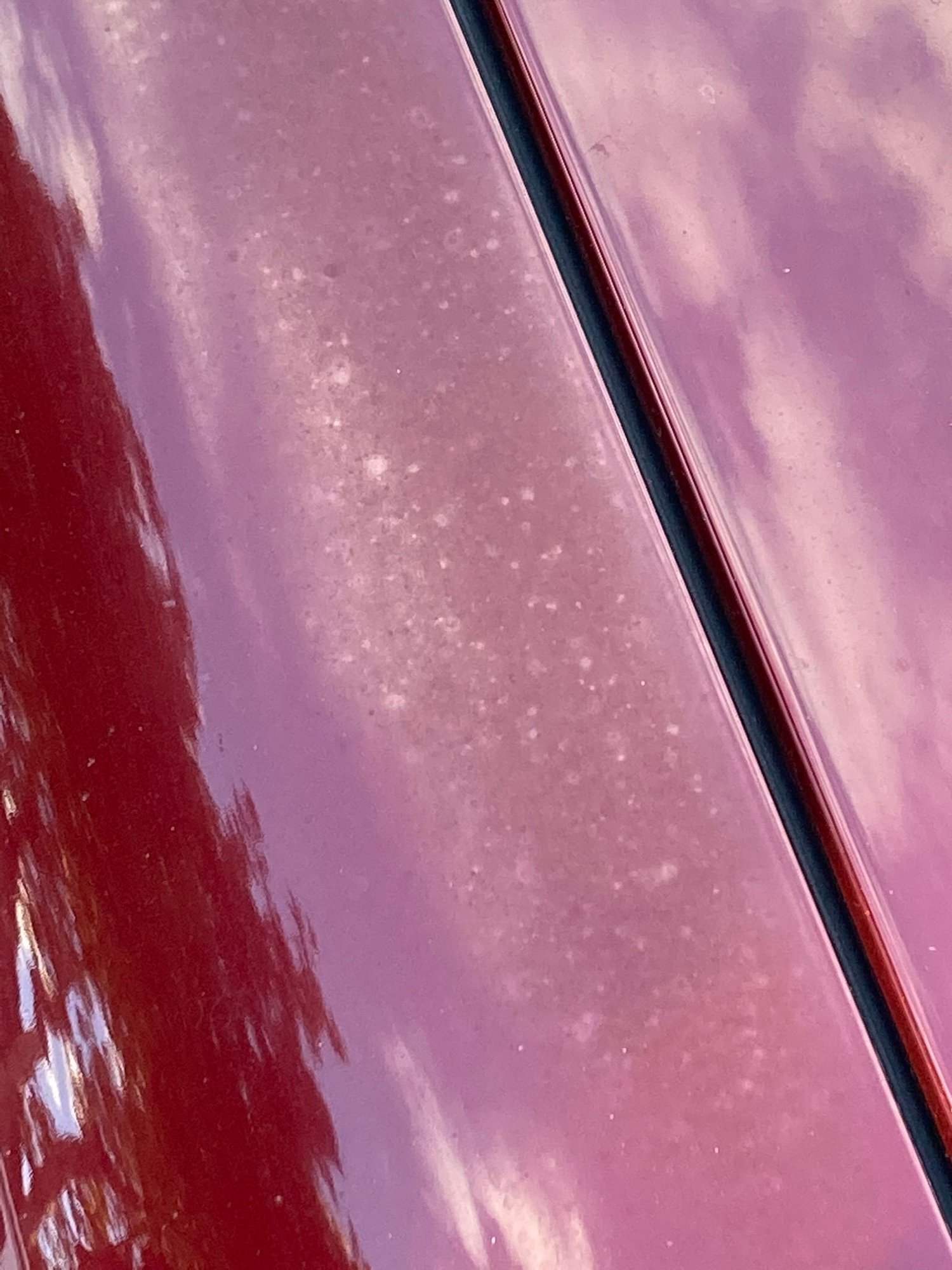

My 03 AE Vert Vette sit outside 24/7. Have it professionally detailed every two years besides doing it myself. Last detailer used Rejex, not happy with the jb at all. Still very shiny but thinking a Color Correction is about due. May even consider a 2-3 year Ceramic Coating possibly 5 year but serious doubt I will have it that long due to failing eyesight.
what should I expect to pay for a GOOD color correction and then a ceramic coating. Please price each out not total. Been told if a ceramic coating be done a color correction must be done first.
I have been quoted over phone after answering questions the each would cost $300. each and can be done outside under a canopy in the ceramic is done, not if only correction done.
have searched the net for pricing, ranges from 300-600 for correction and 300. - 3,000. for coating.
total for both 600-5800, totally confused.
Vette looks great except for a little dullness in areas and marks. No paint missing at all.

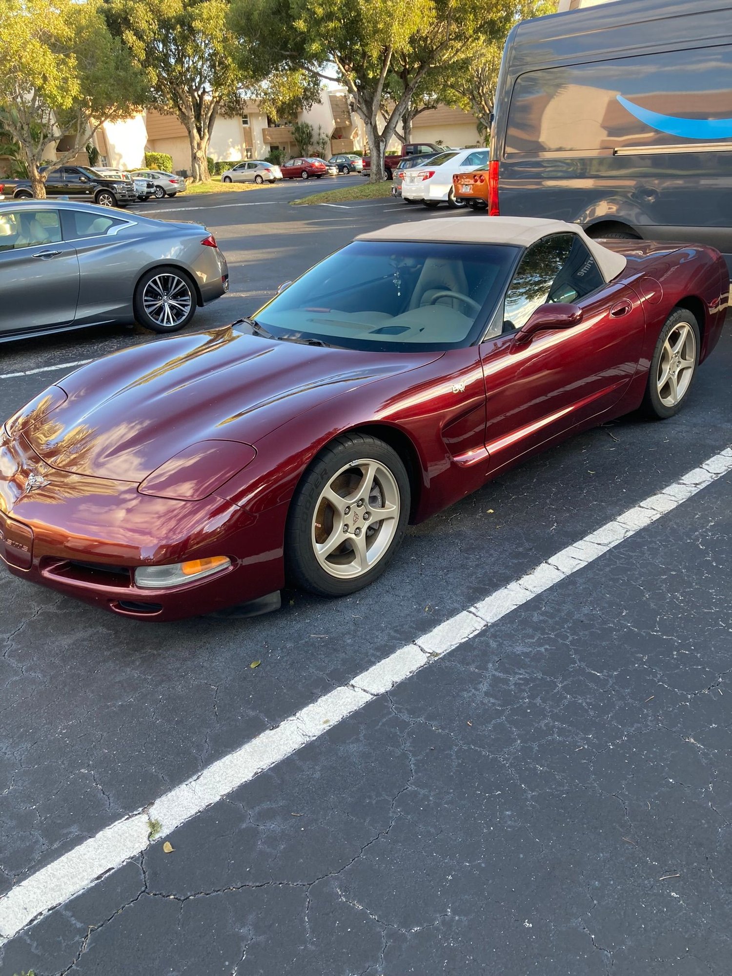

most recent photo.

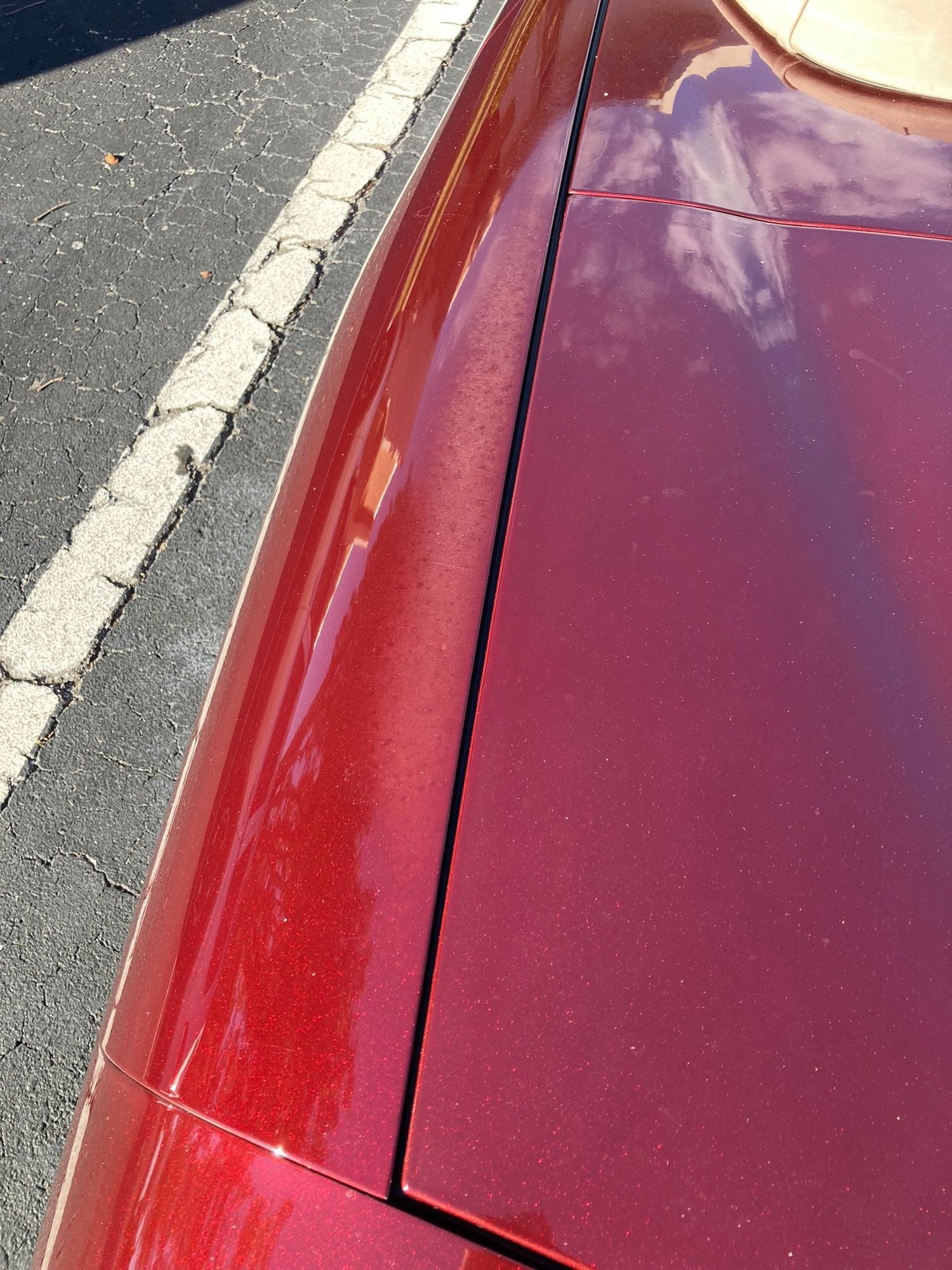

First photo today, second, today showing driver side rear fender with markings on the top of it. Last photo taken a month after last detail I did.
Thanks for any suggestions or replies.
Sorry guys, she is dirty the last two days. Had a tornado event a few miles away. Heavy winds to say the least. 75 mph. Washing for Xmas day 😀👍

I used to work in a body shop and I still practice detailing and paint correction
The term “color” correction is a method of the removing the top surface of the paint thats severely damaged. So much so that the only way to disguise the damage is to cut polish or sand down the damaged paint so its less noticable.
Don’t shoot the messenger. I’m only going off what the photos portray which for your sake I hope don’t look as bad in person but;
From what the photos show: you have no topcoat left which also shows the base paint spotting thru. Whoever detailed your car ate right thru the clear exposing the base paint. If you have it re detailed like it is shown; from a less than reputable detailer they will either end up completely burning thru the clear and never have decent looking fender or stop and leave it partially spotty and slightly cloudy or they will tell you its already toast and cant be touched up
From what you show (maybe it looks savable in person but the photos make it look unsavable) the best and final option is a respray
If you want the truth, take it to a couple body shops and ask what your best option is
Good Luck

That "detailer" should be hung by the ***** if the top of that quarter panel did not look like that before they touched it.

Glad someone else said this first. Every time you buff your car it can remove a tiny bit of clear/paint
Had a 5.0 mustang I waxed all the time I eventually wore right though. Factory doesnt put a ton of paint on
That spot is probably from years of doing a little too much/often Id bet. At some point thats bound to happen

I agree that the top of that fender looks like it needs to be redone. Best bet is to speak with a good body shop (or several shops) and see what they recommend. Good luck with this.

Thank you all very much for your input. Correct the second to last detailer did this along with another small area on passenger side right below rag top. He used Rejex on it without my knowledge, I was pissed. Did not pay for job and took finish off front and rear logos and a few pieces of both logos. Last detailer did the best he could and helped some. Does not nearly look as bad in person as it does in photos. Have to really have to get up close to notice it. OCD about the Vette and boat. 😀👍
