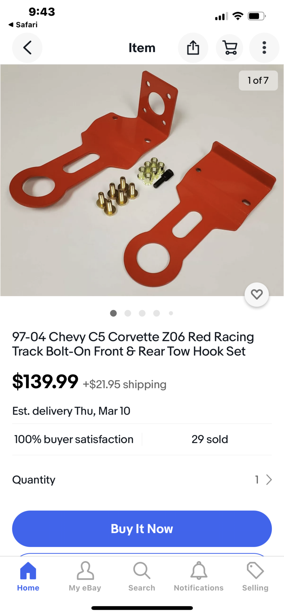

I was thinking maybe the set with the front hook. Looks like it bolts on study. This is the easiest way to get the vehicle out of the road without having to push too hard on the flexible bumper. 97-04 Chevy C5 Corvette Z06 Red Racing Track Bolt-On Front & Rear Tow Hook Set | eBay It is pricey thought maybe just the rear hook.

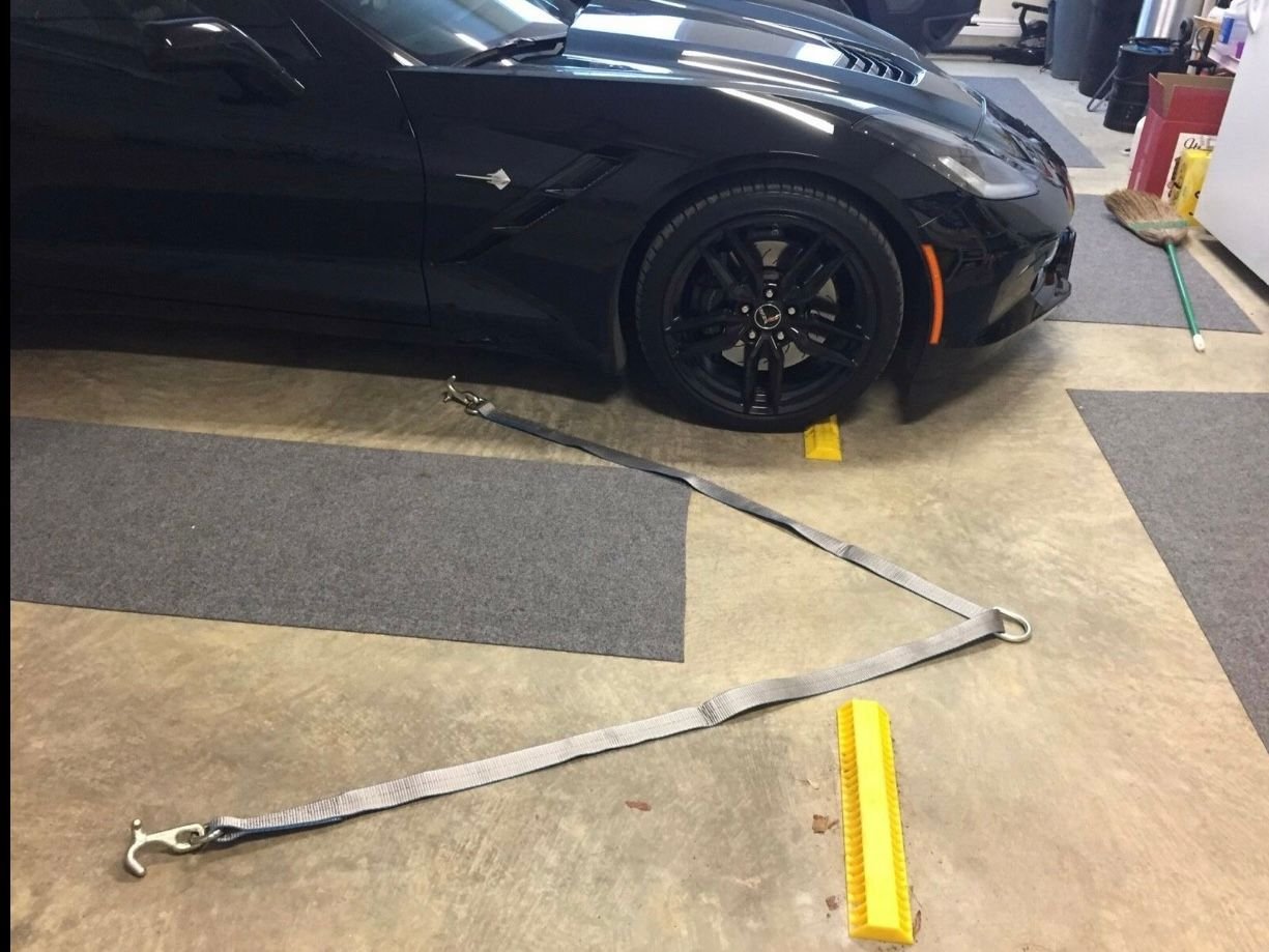

It's towed from the jacking puck points, not the radiator support

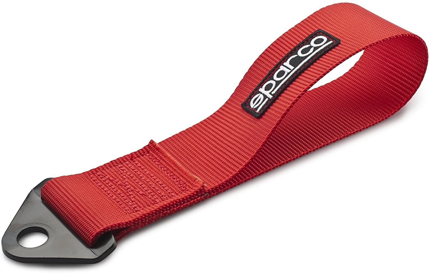

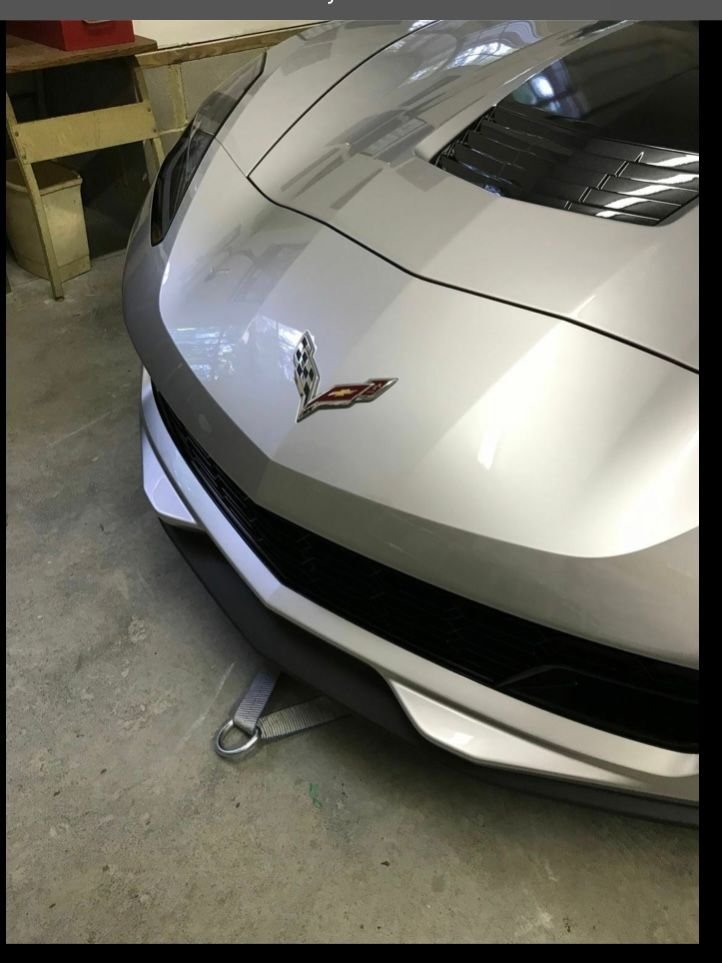

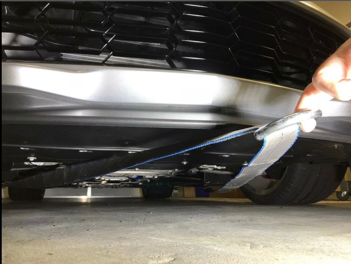

OP, to answer your question, I picked up a tow strap like the one pictured below. I have not installed it yet, but I plan to attach it to the front bumper (the metal bumper itself) behind the front license plate cover with a decently sized bolt. I'll need to cut a small hole or slit into the section of the front bumper behind the license plate cover for the strap to feed through. With the cover on, the strap will be completely tucked away and hidden. Should I ever need a tow in the future, I can be pulled onto the flatbed by this strap without any unnecessary straps underneath the car. See post #14 in this thread, which is essentially what I plan to do.
To tow hook or tow strap

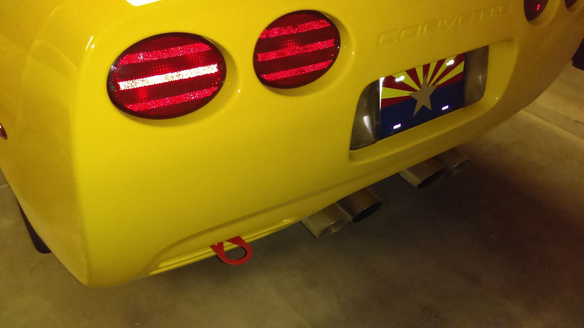

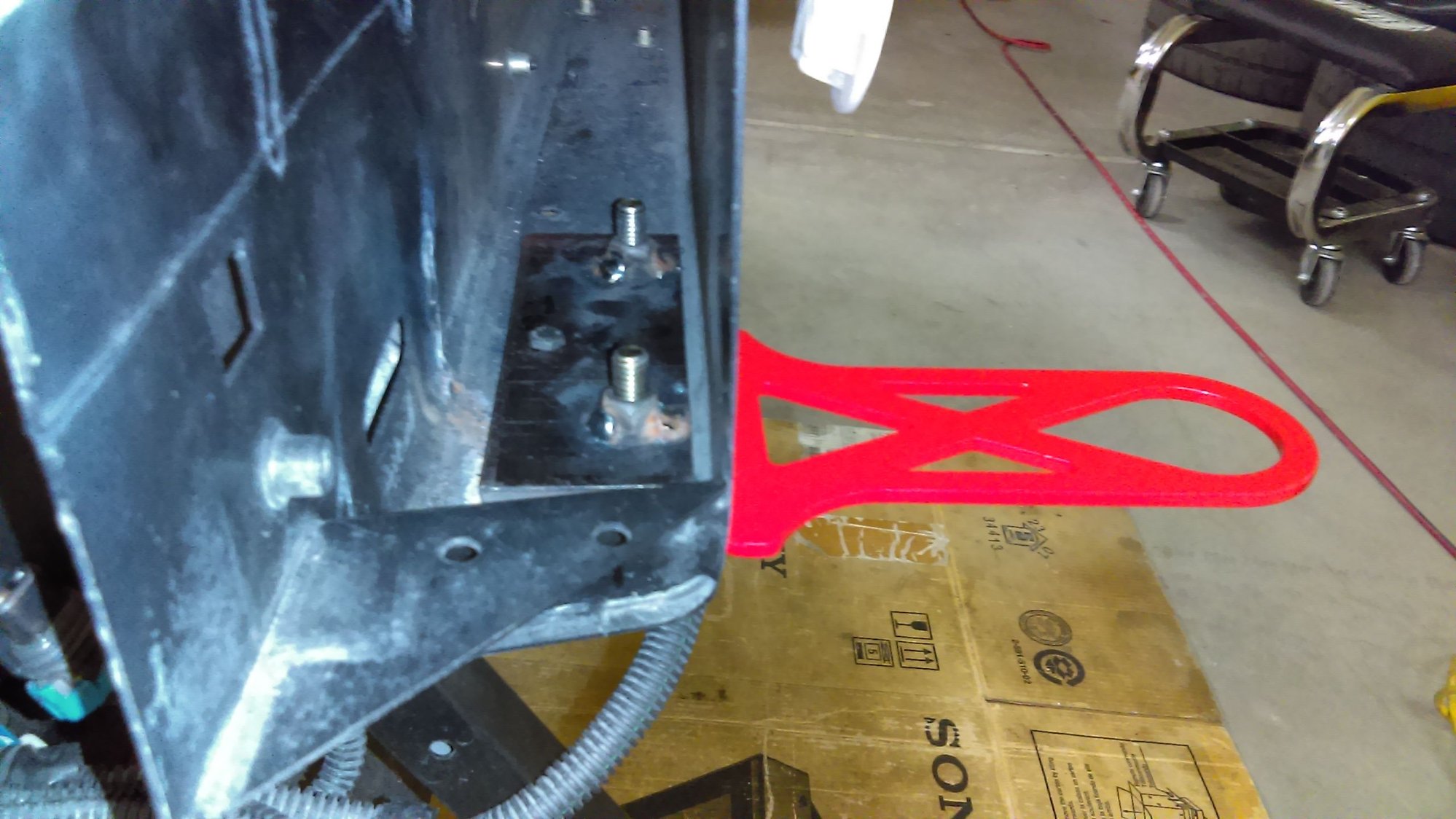

Pfadt front and rear tow hooks for my track beast. I didn't care for the Nutsert fasteners so I fabricated a doubler with grade 8 hardware. This also extended the hook slightly as it seemed a bit too short. You've got to pull the snout off to install the front but the rear was fairly straight forward with the exhaust hanger mount.
