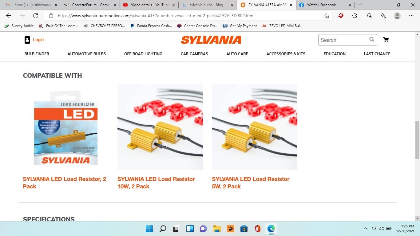

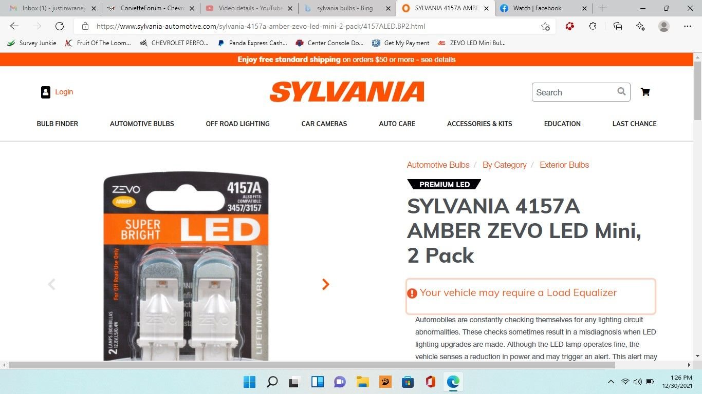

On sylvanias website it says with the 4157 zevo has a lifetime warranty and that the car may require load resistors to prevent hyperflashing. Mine hyperflashes but isn't a problem one bulb does have an intermittent or cuts out when blinker on headlights off but functions good with headlights on. So with the hyperflash relay harness that plugs in directly to the headlight switch draws the current as if it were reading standard bulbs from all areas and prevent hyperflash and wouldnt need 2 resistors for each bulb? Would require 12 load resistors to correct each led light and a hacked original harness if im not mistaken? If only the corvetteforum had a thread delete button to completely erase certain threads would be nice as ls1tech does have this feature.
