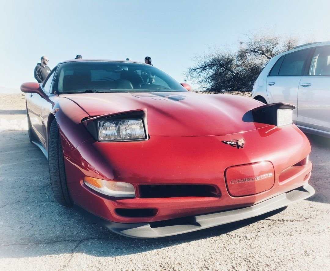

Hey guys I have my corvette lowered on aftermarket lowering bolts,
front is all the way down,
I would like to give it an inch lift back up,
my car handles amazing, I spend over 200 miles messing with Ferrari F8 Tributo yesterday,
but it’s much lower than I would like and very hard to drive safely without scraping front lip.
what’s the process of lifting it back up ?
can someone walk me the steps please.
thank you.
