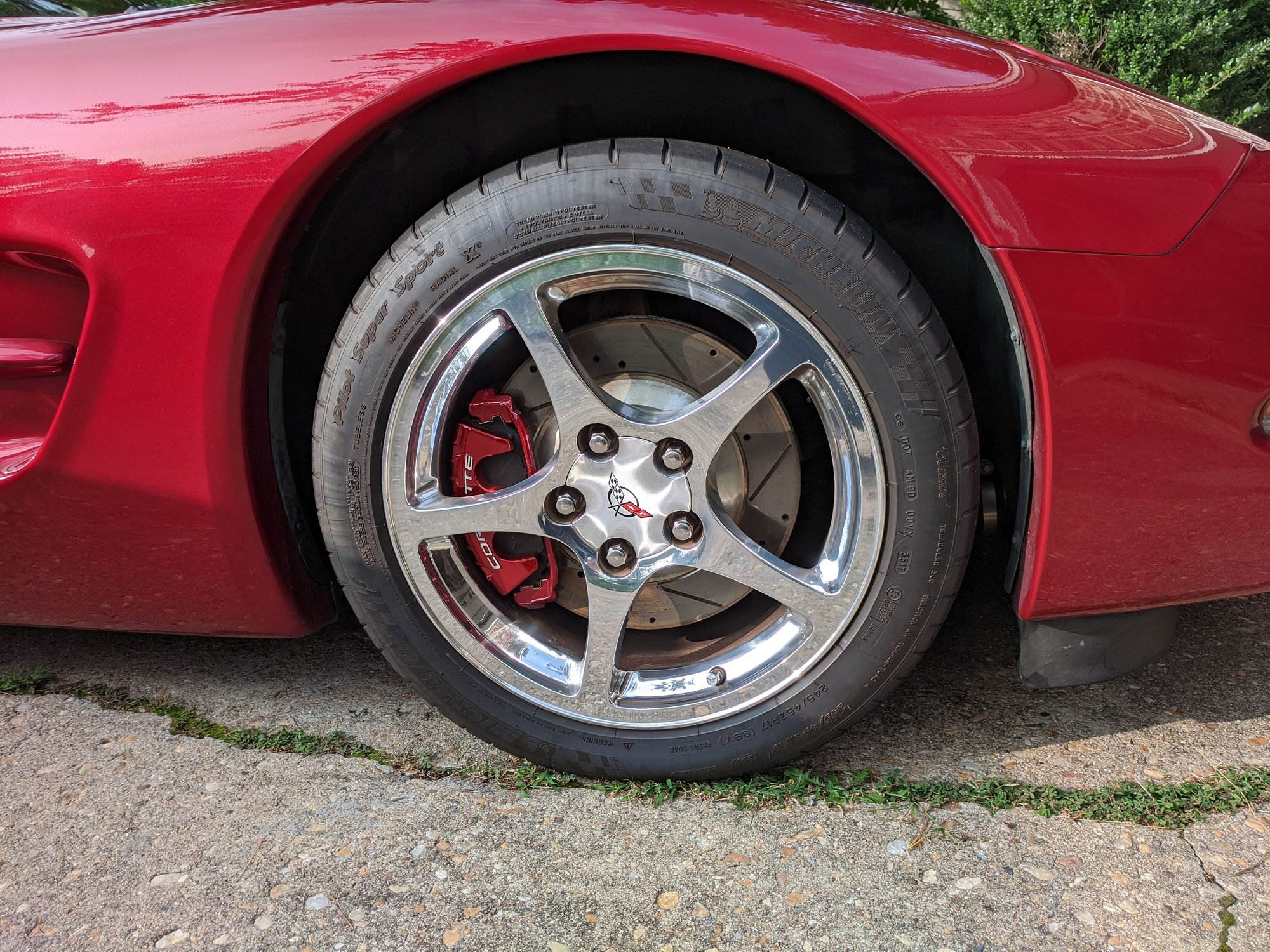

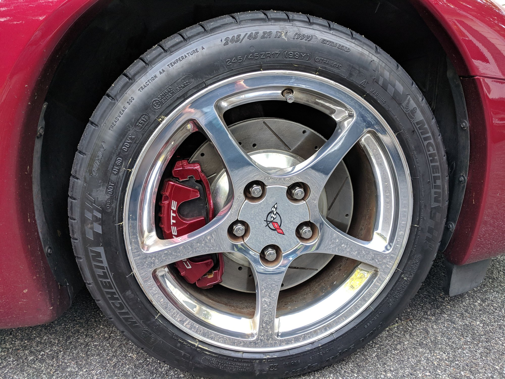

As for calipers, I have a mag red II convertible. I think these match pretty well.
They are candy red.
