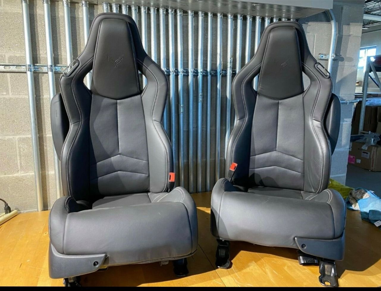

Here's a quick photo of the results!! I'm going to make a new thread that about the installation so other have guidance if they try. I love these seats. They have transformed the car!

Here's a nice pair that sold about a month ago
https://www.ebay.com/itm/22471678358...p2047675.l2557
Hopefully they work out for swapping into a c5

I also encourage you to SIT in a set first. Those GT1 seats, in my opinion, suck. The headrest (using that term loosely) is as hard as a rock and not somewhere I would want to spend any time.

Well they are asking $2,500 + shipping for C8 competition seats. That is a good deal, but I'm not sure it's in the cards. That's way too much money for me.
Thoughts?
