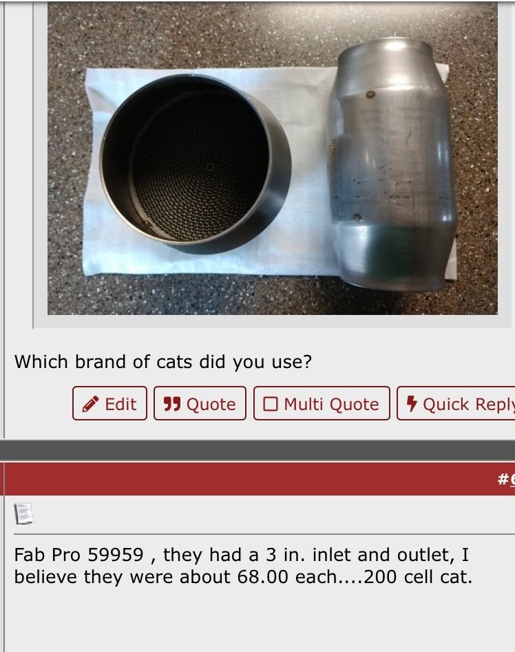

So I'm assuming these universals will work? Also if so then I can sell mine. Do my sensors plug into this or will I need to bypass that?

What does the number of "cell" mean? And can they just be clamped on?

The cell count refers to the density, or number of cells in a standard area, Lower cell count results in less flow restriction.
Can they be clamped on? Don’t know, but they look like they were intended to be welded on.

Common sense I figured it out. Catalyst amount. I'm assuming by the pic that it is a weld on. How do they sound? What mufflers r you running? Did you tune? I know that sounds stupid but I drive around 1200 miles a year so that's why I ask. Also does the lack of back pressure exist when doing this?

This info was provided to me in another thread, so I can’t answer all your questions. Still I have researched the subject and found there is some back pressure from the cats, but not much. If your installing headers, the pup cats will be eliminated anyway.

The OEM cats have a different inlet and outlet diameter. I think 3" in and 2.5" out. Also, the inlet and outlet are not in line. The out is offset to the center of the car by an inch or so.
Universal cats are definitely not a cut out the originals and clamp new in place kind of swap.
