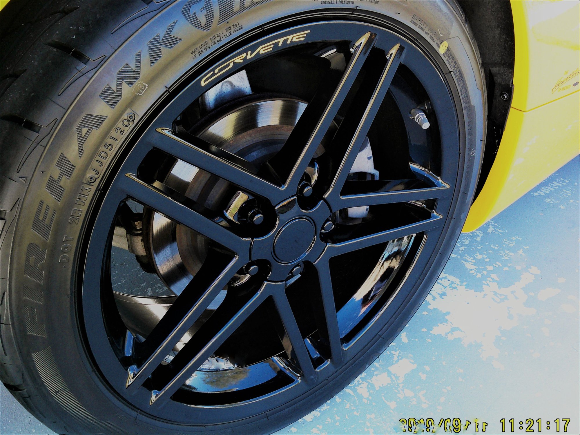

Old Feb 20, 2022 | 06:51 PM
KY Colonel's Avatar
KY Colonel
Joined: Mar 2021
Posts: 216
Likes: 56
From: Weeki Wachee, FL
OE Wheels LLC 19x10 front / 18x9.5 rear OE Wheels LLC 19x10 front / 18x9.5 rear
Firestone Firehawk Indy 500 Ultra High Peformance Tire 275/40R19 Firestone Firehawk Indy 500 Ultra High Peformance Tire 275/40R19
REAR
Firestone Firehawk Indy 500 Ultra High Peformance Tire 245/40R18 97 W Extra Load Firestone Firehawk Indy 500 Ultra High Peformance Tire 245/40R18 97 W Extra Load
FRONT
