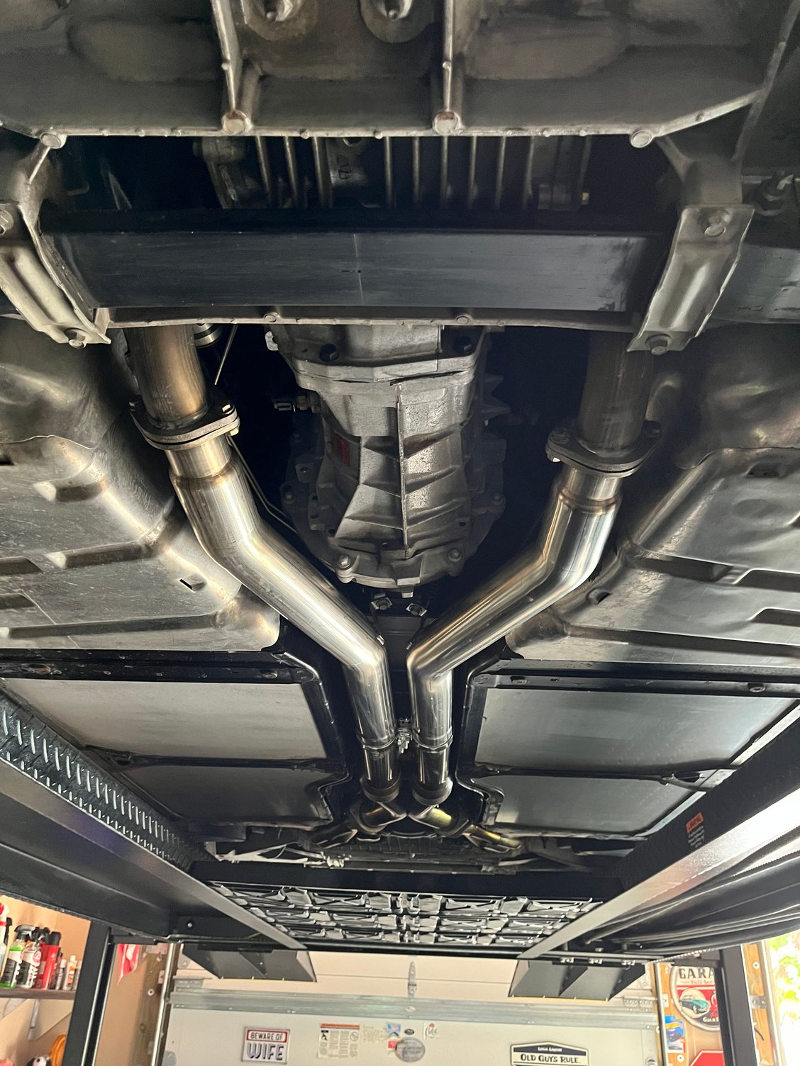

I did the American Headers high flow cats and x pipe. Stainless and attached right to the stock axle back. Nice quality 3 inch piping.

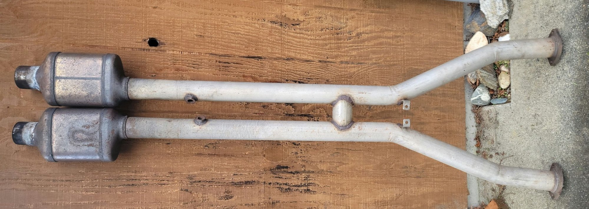

You'd think, but then you must've never tried to have this done. I did, and learned the hard way that there are three problems we face with obtaining suitable replacement cats - one, the stock converters are low-profile, rectangular and nearly flat to the pipe height. Two, they have no heat shields. Three, the pipe inlet is offset from the outlet by a good inch and a half. See the following photo of mine after I removed it.
GM has discontinued these. There are few if any good options left to maintain proper ground clearance and fit within the center tunnel. Catco and AP Exhaust both used to list similar parts, but are now both owned by the same parent company and are no longer producing them ("obsolete" was their term for it). My C5 is highly modified and supercharged, makes more power than any human should rightly be allowed to possess, and my state no longer has emissions testing at all. But not only do I NOT want to be the guy with the Corvette with the stinky exhaust polluting the environment and everyone around me, it is a convertible and I can assure you that NO female passenger wants to inhale toxic exhaust fumes at every stop sign or stoplight with the top down on a nice sunny summer's day any more than I do. Not having cats is simply not an option, and I've been trying to find the 645856 upgrade with the California pup cats for months with no success.

Best bet is to buy stock used setup. I know most people want an arm and a leg for them, but not everyone. Helps that you don't NEED the pup cat model and I can't think of a logical reason to seek one out since it's more weight, slight reduction in power, two more cats to clog/deteriorate, and no more efficient than the later 2 cat setup.
If you're not lowered a lot, you'd be fine with a not-so-snug fitting aftermarket setup as well. Although with the blower setup, most tuners/shops would highly recommend ditching the cats if you don't absolutely need them. I understand the desire to want to run them though, no judgment there.
