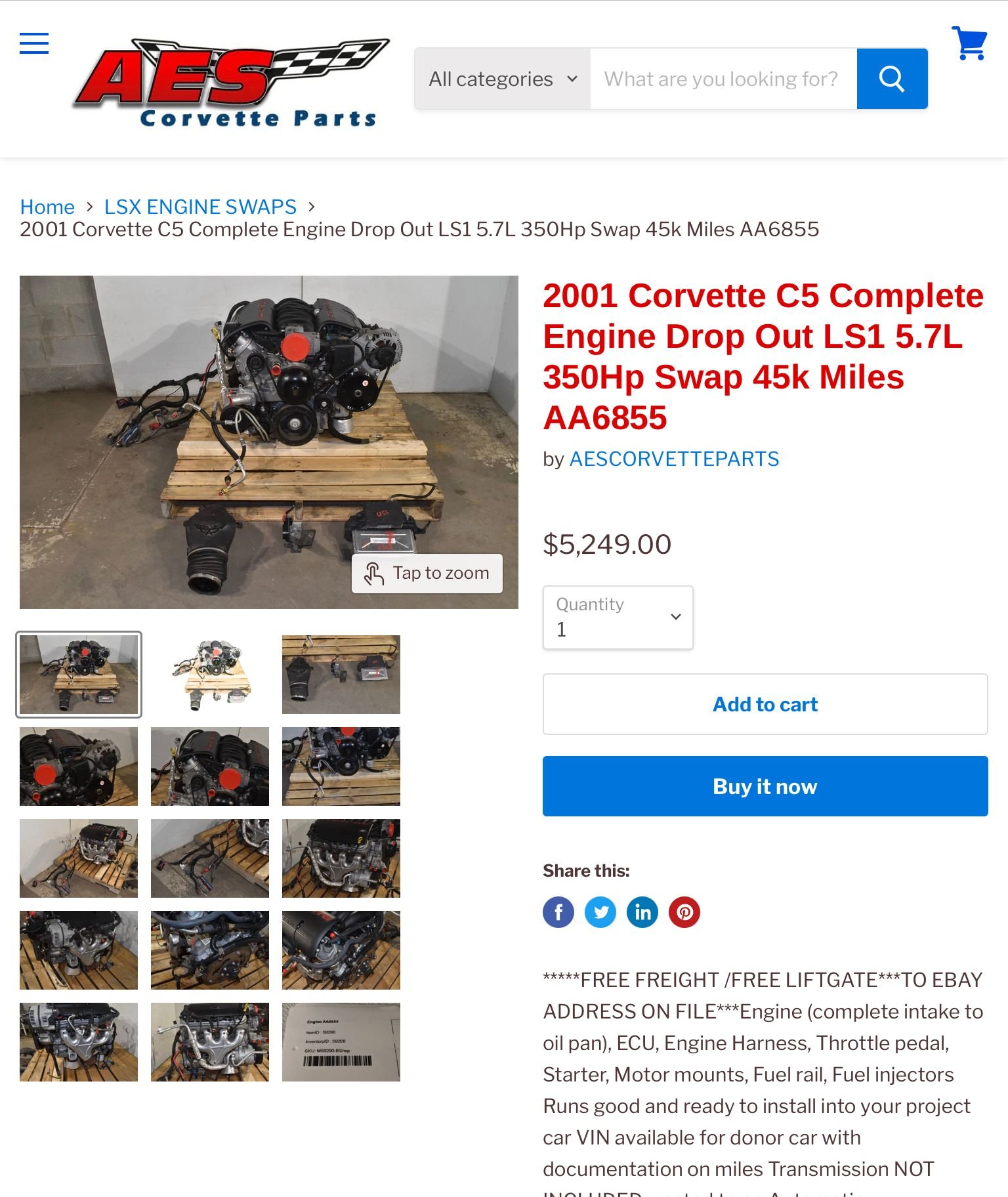

AES stocks used Corvette parts, including complete engines. Based on your budget alone, here’s an example of what you can get:
https://aescorvetteparts.com/collect...k-miles-aa6855
