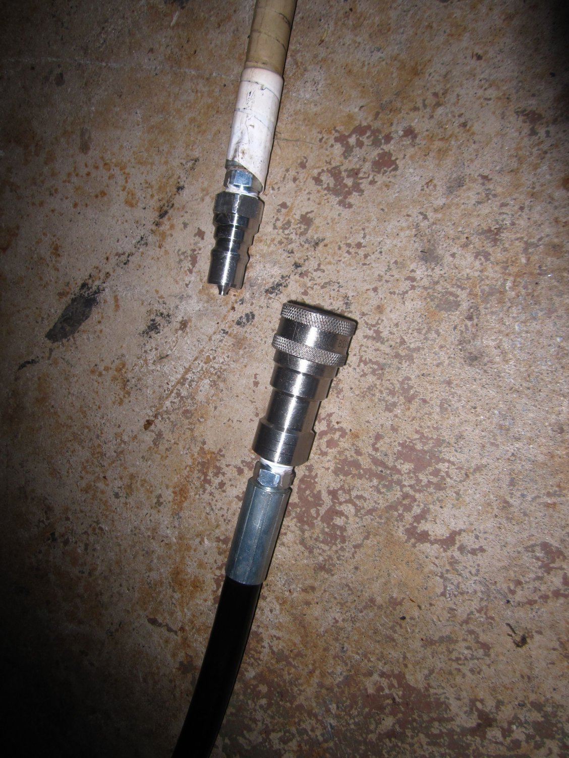

They'll probably send you a new connector for the restricted pump port for starters. The factory connectors don't leak when putting them together, disconnecting or storing them but that feature and them being aluminum can cause them to bind. One of the connectors on my QJ became difficult to plug in and finally it couldn't be plugged in at all. I bought a complete set of stainless steel connectors on e-bay for around $100 and replaced all the factory aluminum ones. The new connectors leak a drop or two of oil at assembly or disassembly but there's no binding and no side pins to align, they are much easier to use and when the jack is needed it can be used without dealing with connector problems. Here's a picture of the new fittings:
I have my quick jack in my moving pod at the moment, so are the connections the 1/2" or 3/4"? I'm going to assume they're the 1/2" version. If you happen to know off hand then I'll order myself a set too. Mine are getting hard for connect too.

Mine appear to be 1/2" but it's an older jack so they could have changed.
