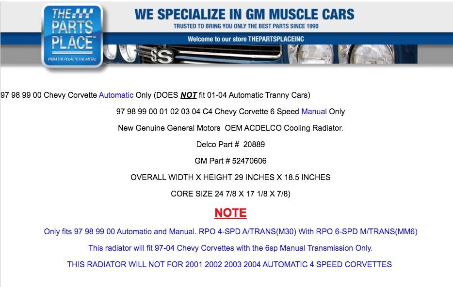

I need to replace my radiator on my '98 because the drain housing cracked. All my orders for p/n 52470606 come back "out of stock". I saw on Amazon p/n 20889 available. What's the difference? Is this an OEM GM part? Wiil this work? Thanks for any recommendations

Found this in an fleabay description - looks like same fitment and one might be the GM PN and one the Delco PN

I looked into this when I replaced my radiator. I became aware of the possible different radiators because I have a stick shift convertible, which required a passage hole configuration other cars didn't need. I think there were at one time three different radiators produced, and with the newer parts, they just added enough passage holes so that one part fits all. The radiators are all the same, the holes are below the cooling area in the plastic.
