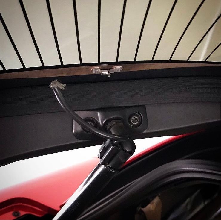

Anyone come across a solution for this?

Just fixed mine last weekend, just go to your local auto center and get a female spade log (I think it’s called) or a speaker log and you replace the broken one.

I bought a defrost grid repair kit. It includes conductive adhesive to reconnect wire contacts and a copper based ( I think) paste to repair any of the grid lines.
Permatex 21351I believe is just the adhesive
