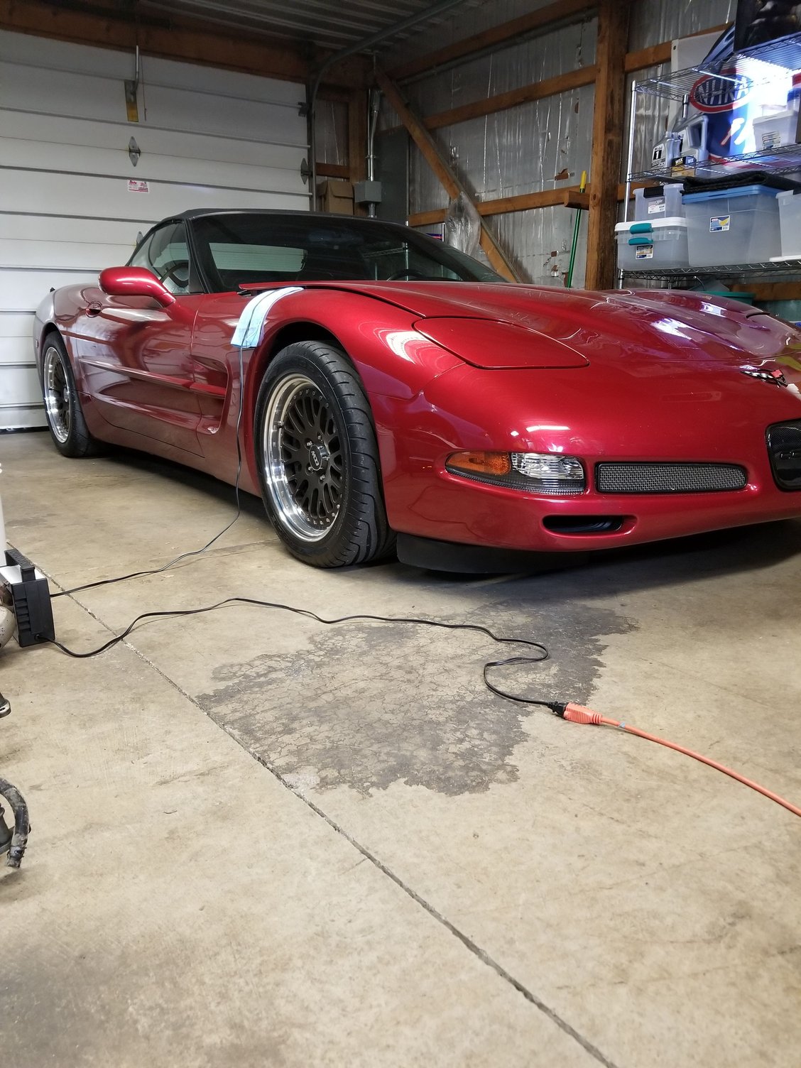

I have these and they are a very high quality product:
http://racemeshgrilles.com/CHEVY-C5-...tyle-_p_9.html
Boy, That really suits the car
Thank you very much !

I added my screens using velcro.
All I did was place three pieces of velcro (2” lengths) on both the top and bottom of the screens. First, just install one part of the velcro on the fascia opening, then place the screen in the opening and determine where the other pieces of the velcro should go so that the velcro latches together in the three upper and lower areas when placing the screens.
Easy peasy and also easy to remove for cleaning should you have to.
