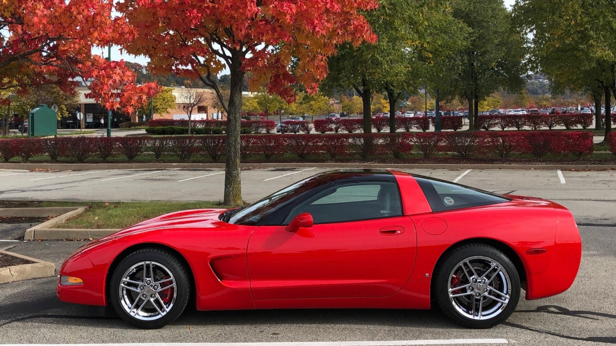

What we have here is a 1998. Just pulled it out of the garage after 7 months. What a great car. Runs just as good if not better than the day i bought it new. I fell sorry for people that come on this site for information about C5s. Because they stay away from this type of car, and I don't blame them. But I'm sure that because of what they are told and see, a lot of similar great cars like mine are past on.

yea, I bought my 2000 vert in Atlantic City. Even modded with cam, lt headers, Corsa, cold air intake etc it has been trouble free. Now with 105,000 miles.
