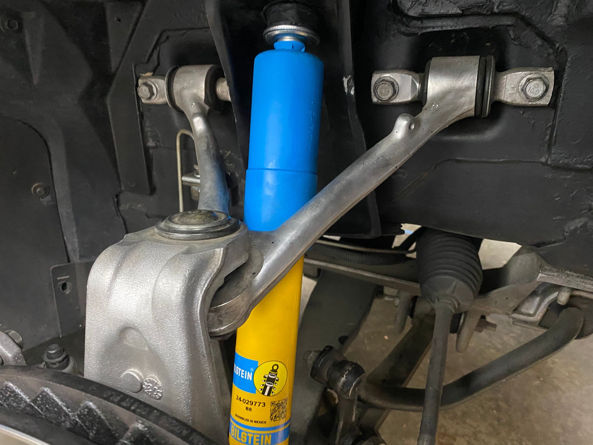

I’m finally able to work like I have before.
The shocks are now going in well! I didn’t have to pull anything else apart on the front end. With a little articulation they fit in just fine as is.
Rears are next. I also have to adjust the DS muffler section. Somehow it shifted and needs to be re aligned.
FWIW; the bottom cross bar mounting attachment fit like butter. No alignment issue. Bolt holes were the same width as OE

Install done and torqued. Went for a short ride and I like how they feel so far. The test was only low speed and a couple miles but the ride was much better overall.
