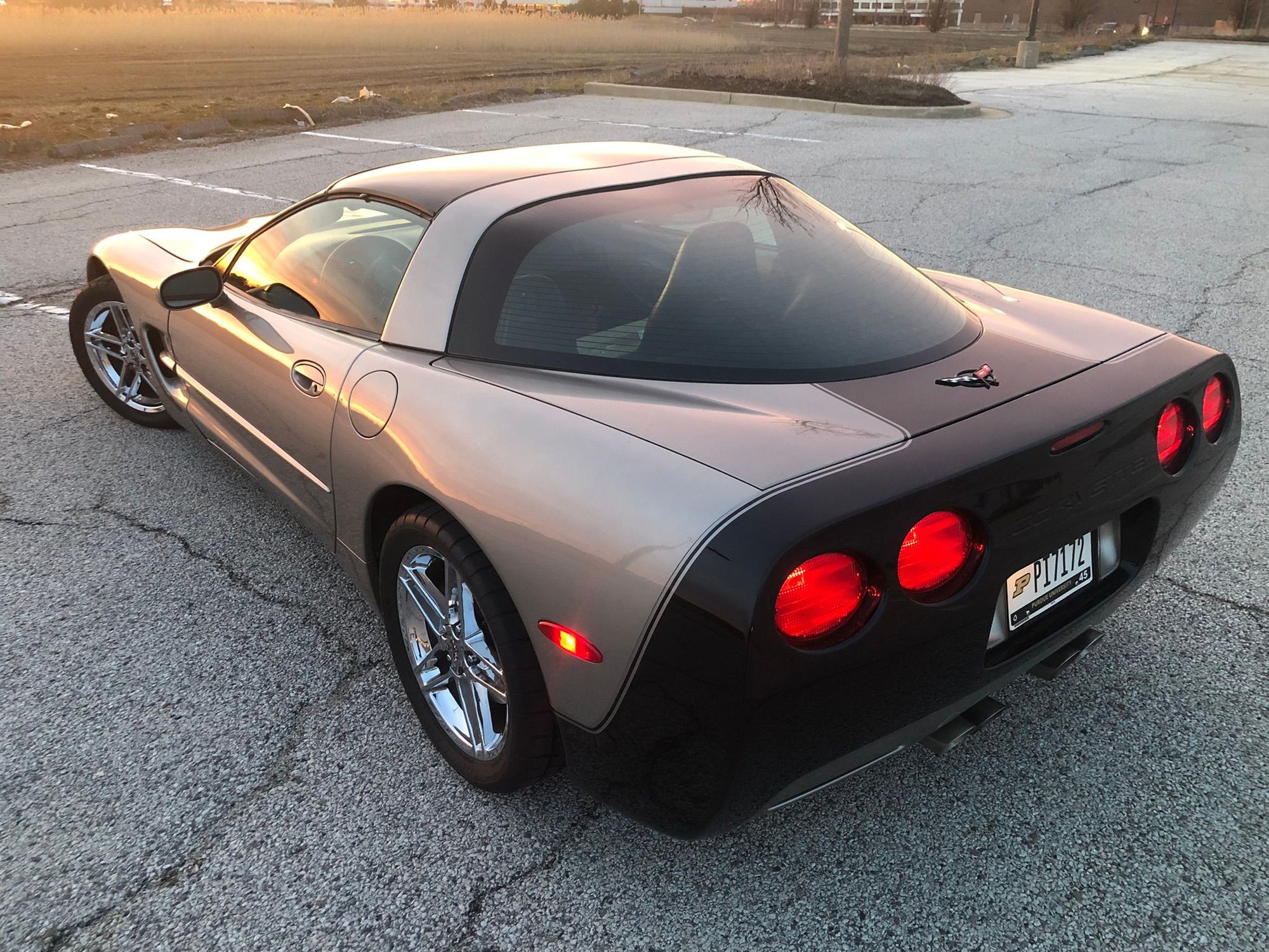

I just did 275/40/17 and 295/35/18 on mine. Happy with it.

I had a lesson in tires when buying mine. I thought when buying the 295 it would be taller than the one I took off. That was a 275/40/18. If you go taller, and you go wider, the tire height stays about the same. So the 295/35/18 is just about the same height.
I wasn't going to do tires this year but figured since they were in stock better get them while I could. During WW2 you could not buy tires. Gas was rationed. Think that can't happen again? The next depression will make the 30s look like a picnic.

I think you're going to find your rear tire will be shorter than the one removed. I wish I would have gone to 305 or 315 but I didn't think the rim could do it. It already kind of wraps around the rim. These are Mickey Thompsons. I think they are middle of the road as far as price. Not tracking the car but I wanted as wide as I could get. I could have gone to 11 so to speak but didn't want to end up with tires that wouldn't fit the rims.
