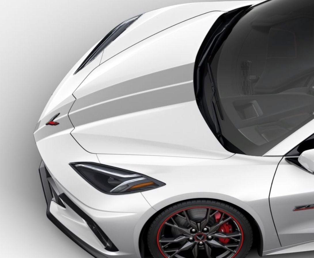

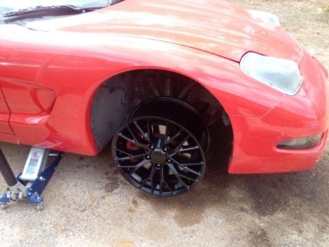

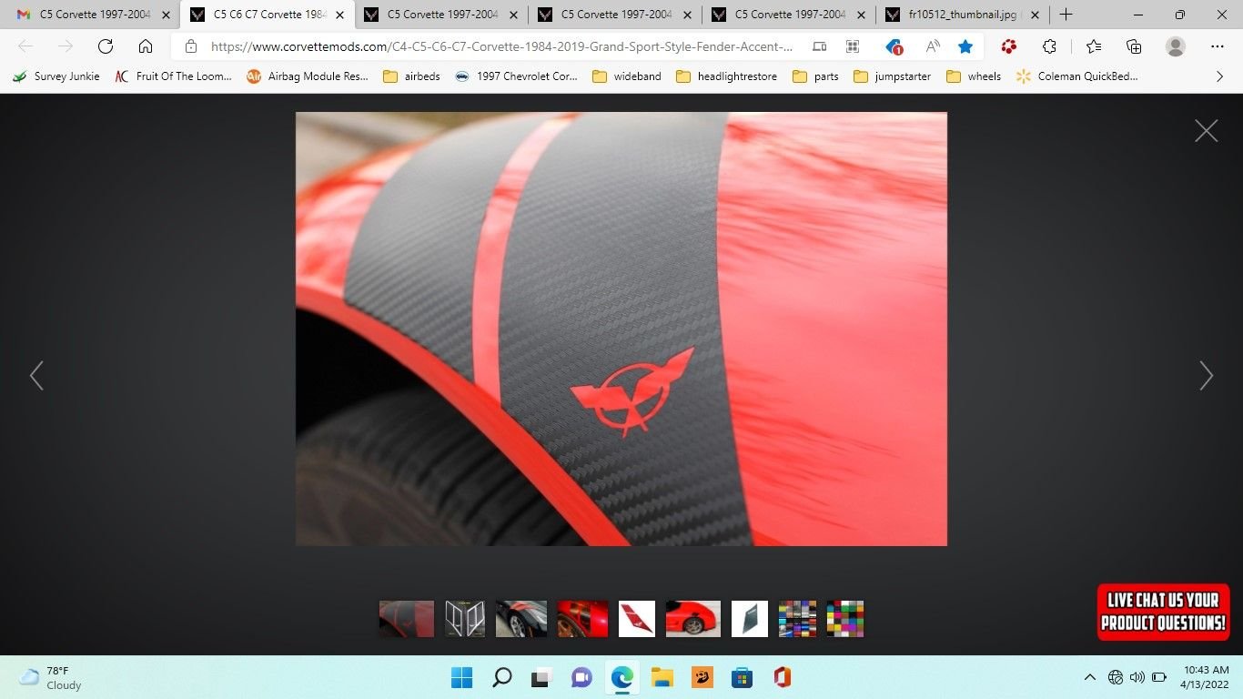

My oe wheel replacement from jegs arrive midweek so im hoping to get the front wheels mounted then on to the fender accent srtripes. Does anyone have have photos of them on their car or experience with them and how long did they last regualr monthly carwashes or at home bucket washing and can you turtle wax right over them or spray wax. I suppose any decal experience on paint with washing and waxing would pertain to what im asking. If you ask me im looking for a permanent solution for this look.
I found a place on ebay or amazon that sells them each side is 30$ so you wouldnt have to wait from corvettemods to get it. A few people told me they took a way long time vs the few days it takes to get stuff shipped from amazon or ebay.
Is there anyway to seal in xpel? or protect this type of detail work or are they pretty durable. Looking to get these and some precut window tint and tackle the job at home after fitting the c7 z06 wheels. Now they also have black vinyl stripes or grey carbon fiber that wrap around the top and bottom of the fenders. Yes the main question is what is xpel and it uses i also have a wolf bra i was going to attempt to mount but carbras.com told me the bra should self dry within a few days if not you had to remove it to let dry so im not sure about mounting a bra just yet. Colgan looks the best and lebras mounts a little strange i had spoke with carbras.com about this as i was curious he sells a few different brands and would know exactly issues with them driving in the rain and such. The novistretch bra looks see thru so im not too interested in those but which set of mirror bras are a nice black vinly or good material and mount directly tight fitted over the mirrors without being bunched up i had seen a set on google images when i was searching but dont think i found where they are sold just simply browsing car bra pictures. The reason i was looking into bras was for the black on red look and the accent stripes has the nice c5 logo so do you guys with grandsport accent stripes is it a painted finish from the factory or factory decal thats suppose to last a long time and whatever xpel is a clear film spray protectant couldnt be sprayed over these accent stripes?

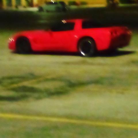

I think the c7 z06 wheels up front are going to make it look pretty good now after i was planning doing the carbon fiber accent stripes, window tint, spoilerking 284p "not sure if cerakotes trim restorerer would keep it a nice gloss black sealed and protected or if to rattle can it with good gm spray can black paint with 2x gloss 25$ for the spoiler but ill see when i get that far, If the front wheels look good ill look into getting a rear set when funds allow.
Yes the main question was in regards to xpel some film protecting the front bumper from rock chips if it was a clear layer film that could be layed over the fender accent stripes to protect from flaring up or pressure washing.

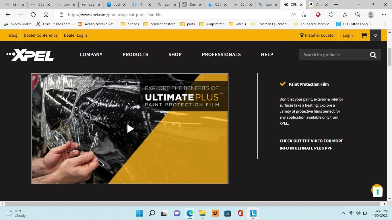

So you cant apply it yourself? Yes i think another forum member had it applied to his bumper. Can it be applied to spot sections you want protected and does it blend in with the clear coat or is it a whole film that would require say the whole fender covered. It couldn't just be applied over the fender accent stripes in attempt to seal and protect them when washing, waxing etc from peeling off early and giving them a permanent look or extra added protection? Mainly looking to cover the fender accents in spot sections with this xpel or other type of clear film thats blends in with clear coat and doesnt leave edges. 3m edge sealer for vinly decals is to be applied over any of the decal edges to seal the edge from water getting undeerneath but does leave the application layer or simply gloss coat of brushed clear coat type of paint where applied from the videos i watched.
Xpels website has it directly where i would want it advertised over the accent stripes but not sure if that means the fender has to be fully covered or it it can simply be applied in a sqaure section over the stripes and edges blend in seal with the cars paint clearcoat. Not sure looks like hes applying the film how it would work when applying the same way you apply fender accent stripes. No ones messed with fender stripes or other decals and seen how long they last under normal conditions of car washes, weathering and sun.
I don't know how you'd buy sections of xpel, if you can, try it. Like I said, it's a pain in the *** to get on... and even more of a pain in the *** to get off. It is optically neutral if done properly, but you will see the seams. other than the seams, and assuming you prepped properly and have no bubbles, it is invisible.

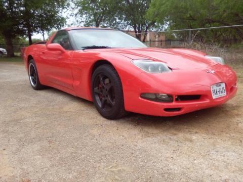

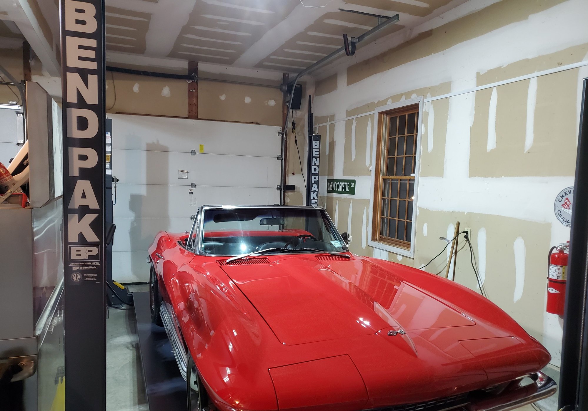

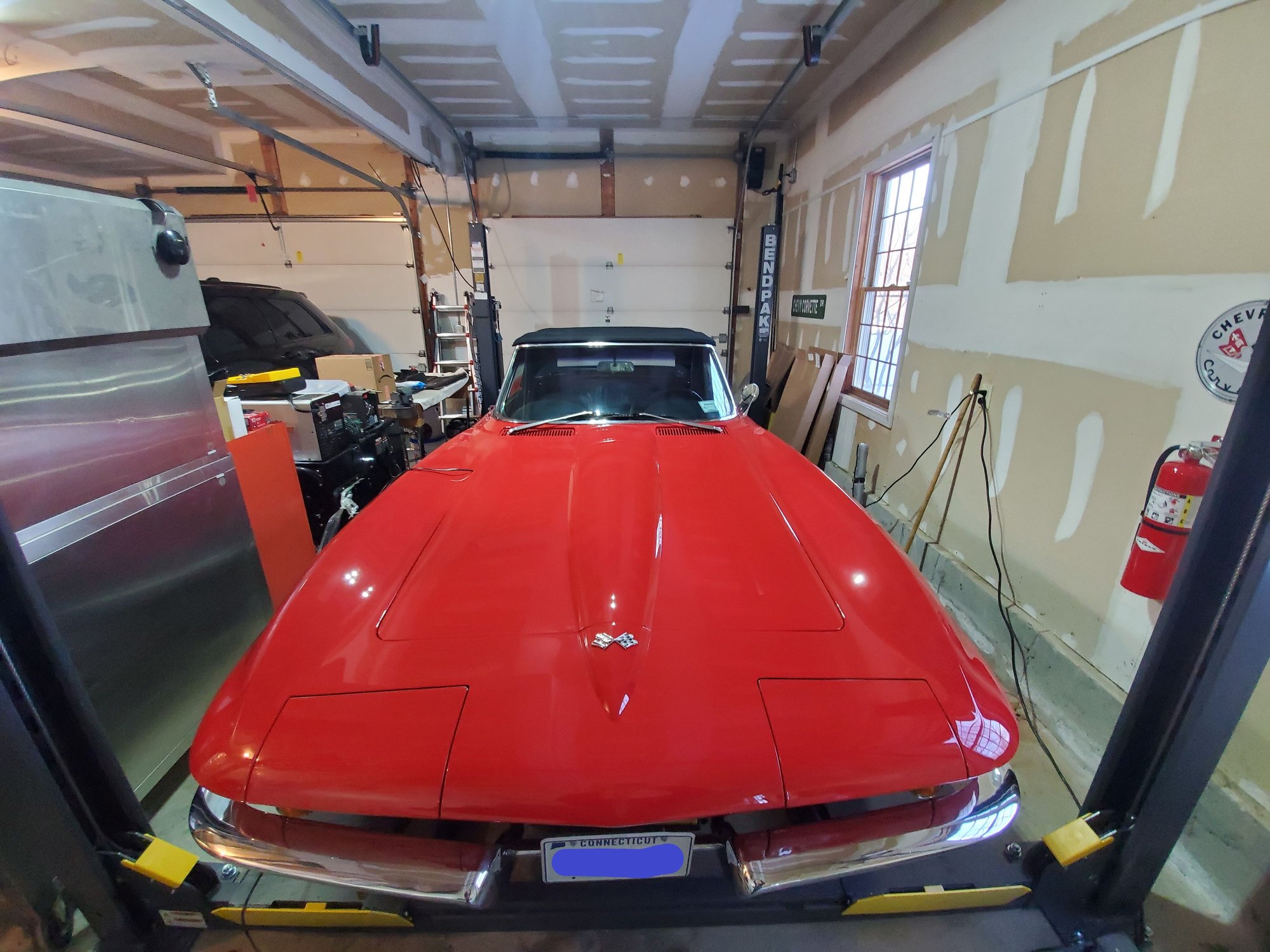

Anyway, here's my c5 and c2, both have xpel over the entire car. There are more edges on the c2, but unless you're standing right there, impossible to tell.

So it appears ill gamble installing the decals with no protection film. Even in the picture you can see part of the decal bubbled up on the edge. I watched one video where they use a heatgun to go around the edges or somewhat shrink the film as its applied around edges. Now for the decal are the grandsport stripes painted into the corvette and not decals similar to what im looking into doing. I looked into wrapping or superwrap layering the targa, sail panel and mirrors black. Not sure but i look the look of the c5 logo accent stripes.
I looked into the vinyl decal 3m edge sealer and adhesion promotors. They look like they leave a mess and you would simply want to install the decals as instructed. Same with the 284 wing. Im wondering if you can cerakote it the trim restorer and have it stay and colored paint black color for over 200 washes. Could also look into duplicolor car black paint wirth the 2k aerosol for the wing. Sometimes i think the black or grey carbon fiber stripes that go around the top and under the fender look better then looking at pictures of these carbon fiber accent stripes. The full stripes recommend 3m edge sealer and adhesion promotor which leaves a mess after around the top and bottom but my fenders are in pretty good condition paint wise so i think just a set of decals i may give a try. Yes i am worried about the standard carwash pressure washer flipping up the decal but it says 25% alcohol with water will help it adhere better. Yeah from the photos on amazon looks as you can see the film ending in you did apply it simply a sqaure layer over the decals and not the whole fender.
