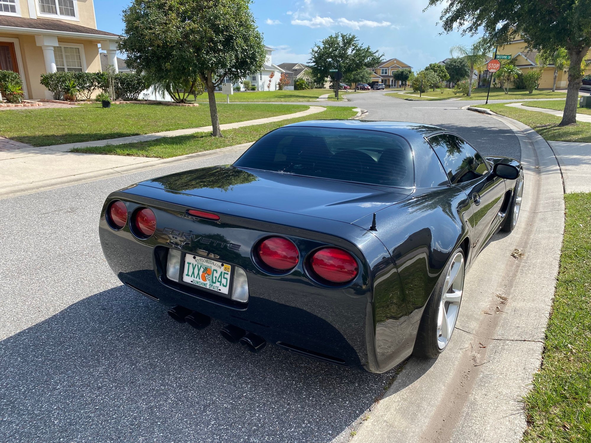

Anyone running C6 Z or grand sport wheels on their C5 with wide fenders ?
What size tire and spacer you go with ?
I plan on using the ones I have until I decide on new wheels. Looked at several wide fender posts and looks like a 3/4” to 1” spacer is where it’s at depending on what fender. I went with the 2” Corvette Creationz TPE fenders.

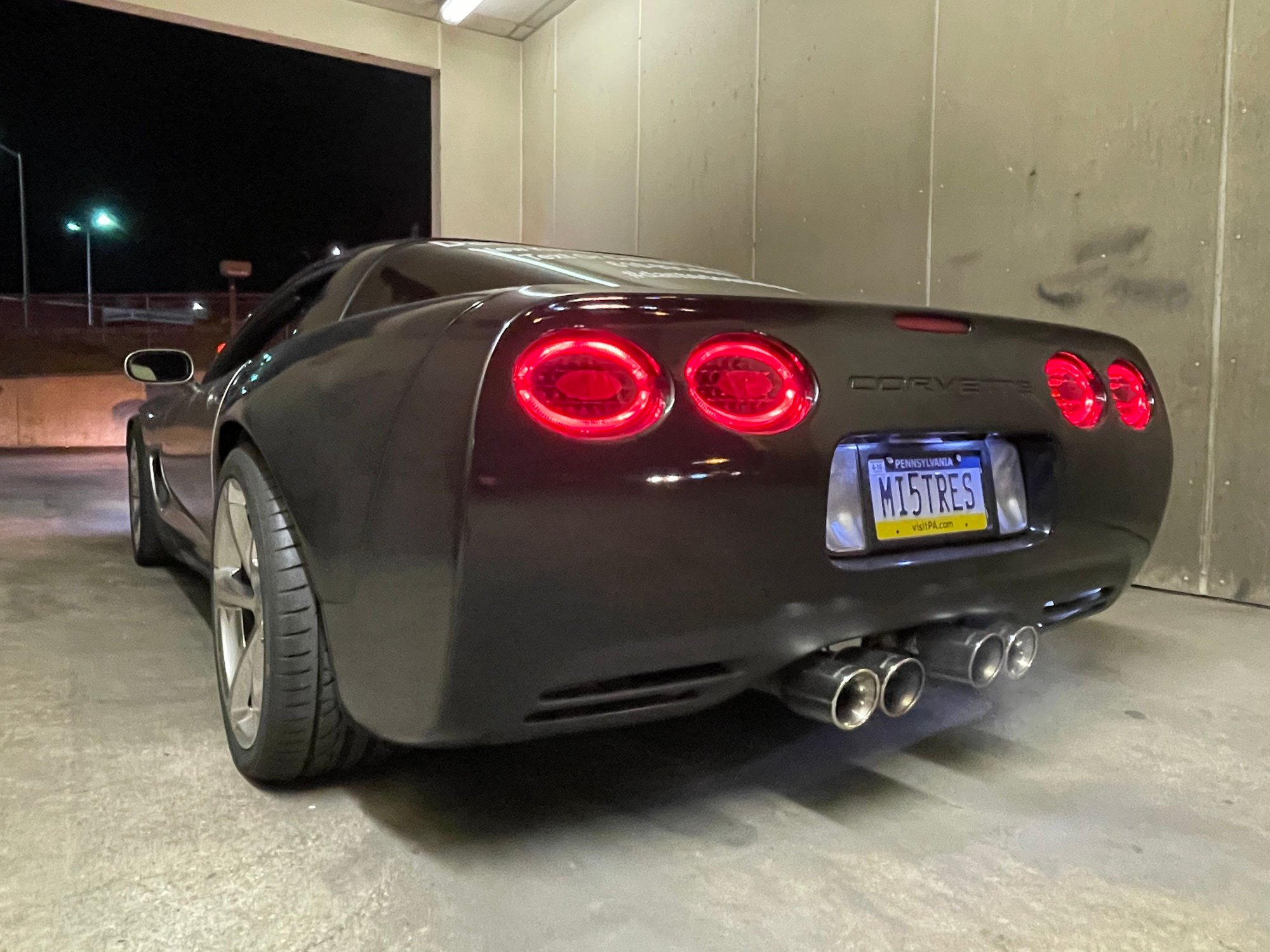

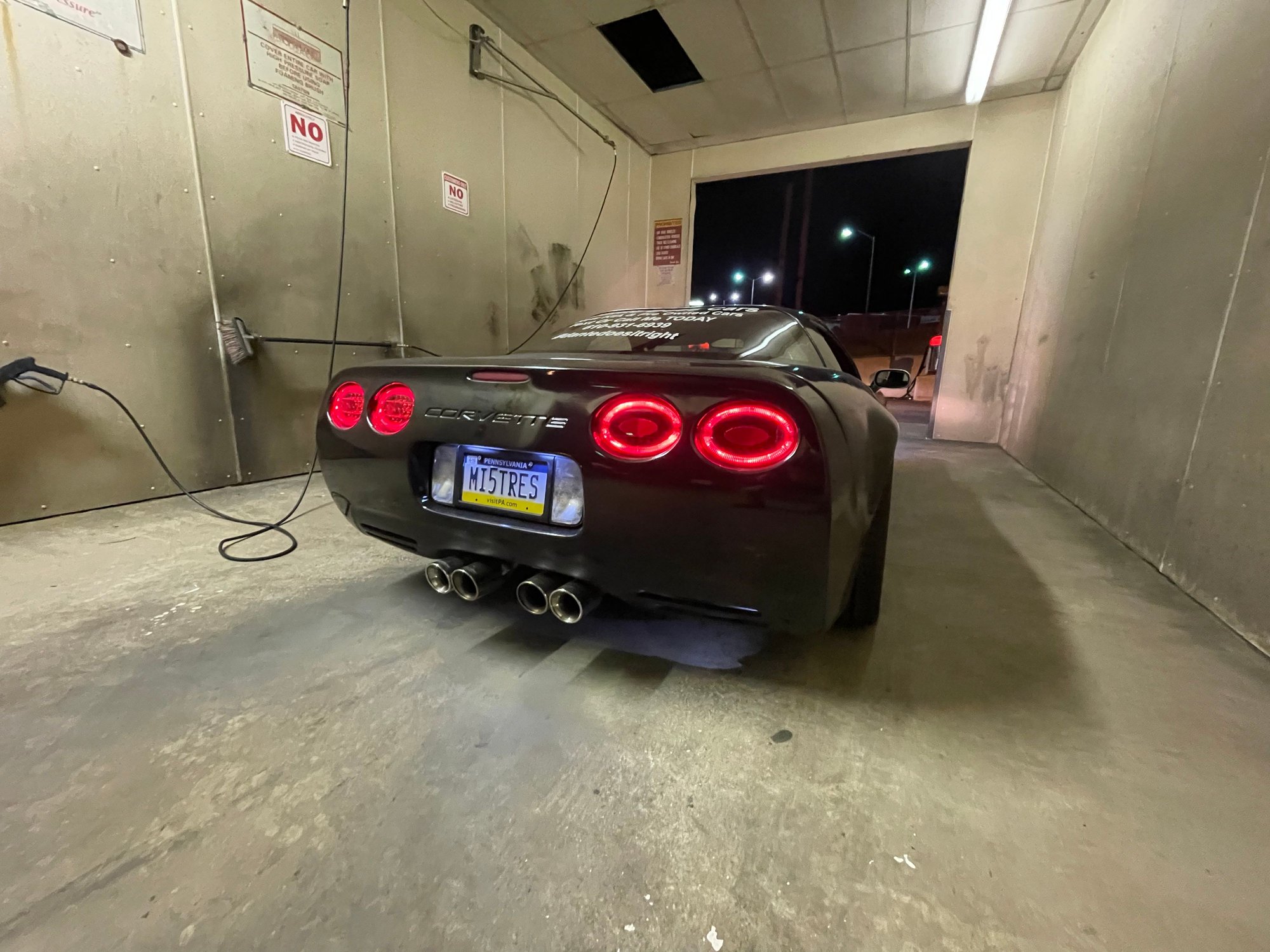

I man running 20MM spacers with the tpe style from Pete and a 325/30/19 tire.
Old May 12, 2022 | 04:04 PM
rob-cyn's Avatar
rob-cyn
Joined: Aug 2007
Posts: 1,846
Likes: 129
From: Orlando Florida
That looks to be right on the money !! I want flush but with no chance of rubbing

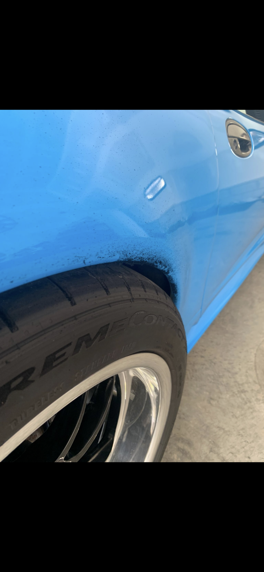

1.5 was a bit much for me
