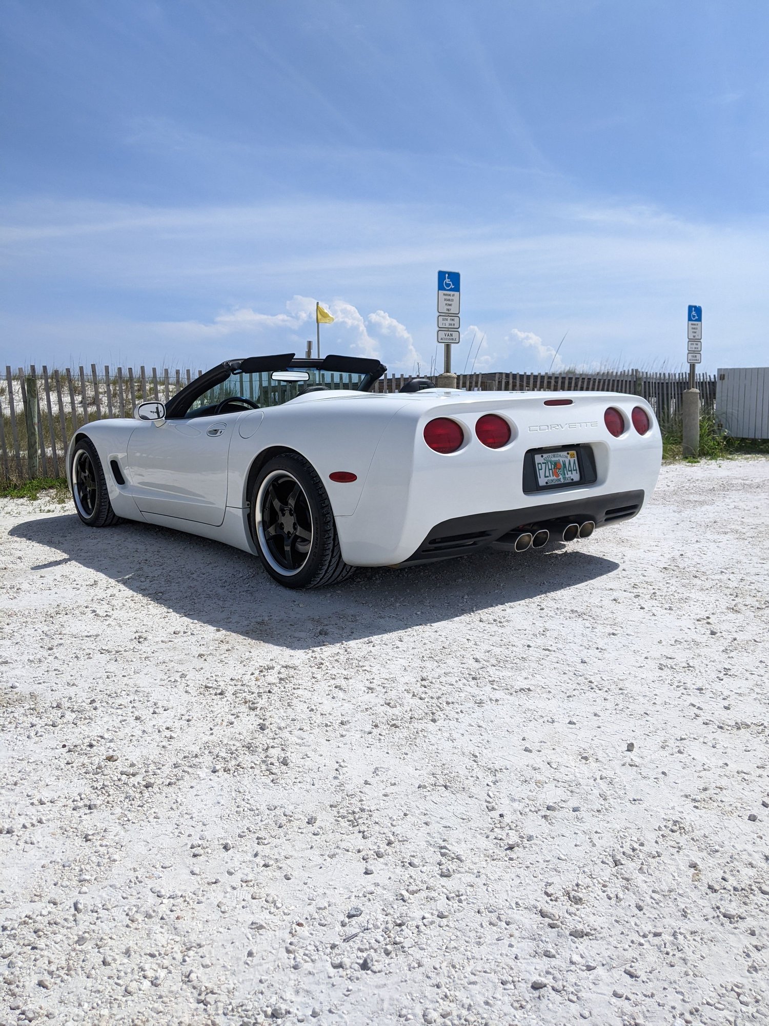

thanks. I really like the look of this users rims /tire setup. He has 305/30/19 rear and 265/35/18 front.
The problem is with all seasons I don't have that option. What my options are is...
Option 1: Any all season tire (except Cooper) the biggest I could get is 285 rear but I could get the 265 front
Option 2: With Cooper tire only I could get 305 rear/ but they don't sell 265 and I could only get 275 or 255 front
Which do you think would be the better option and look most similar to the post below? I'd like the rear to poke ever so slightly with the front tire being flush.
