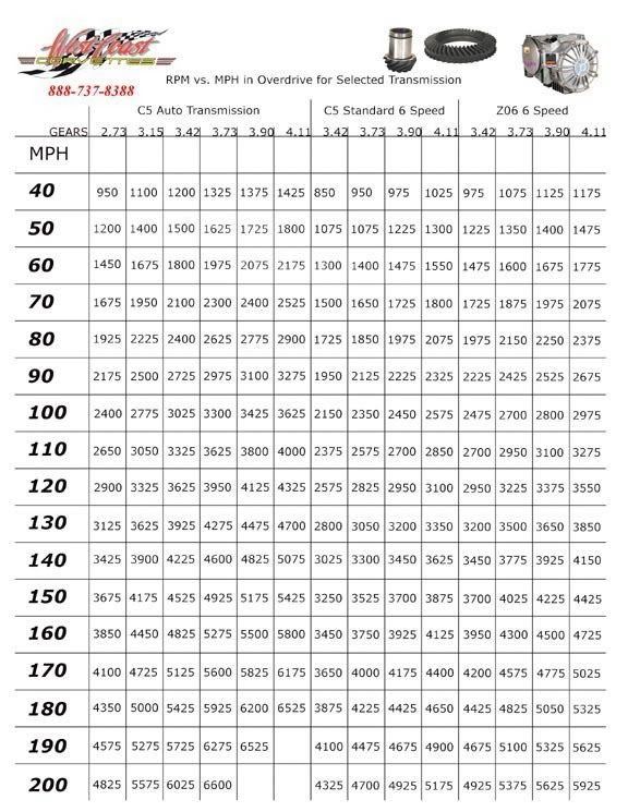

Here's a speed v RPM chart
I see the final gear ratio mph vs the standard c5 and z06 are different are the z06 c5 transmissions different from the standard c5 6 speed and not .050 overdrive? I see 1-2-3 are shorter gear ratio and od are shorter as well.
Yes the transmissions are different. That's why you see the gear ratio variance between the MN6 C5 and the M12 transmission equipped Z06 with the same 3.42 gear ratio.
The M12 in the Z06 with 3.42 gear is like the MN6 with a 3.90. Almost like for like on the RPM band.
