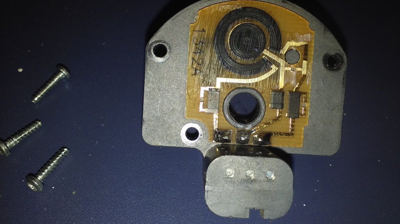

Old May 17, 2022 | 12:19 AM
jim993's Avatar
jim993
Joined: Sep 2009
Posts: 1,862
Likes: 594
From: Prescott, Arizona
Try running the seat all the way back and forward 4-5 times. The contacts in the seat motor that allow the memory to work can get gunked up and not make good contact.
