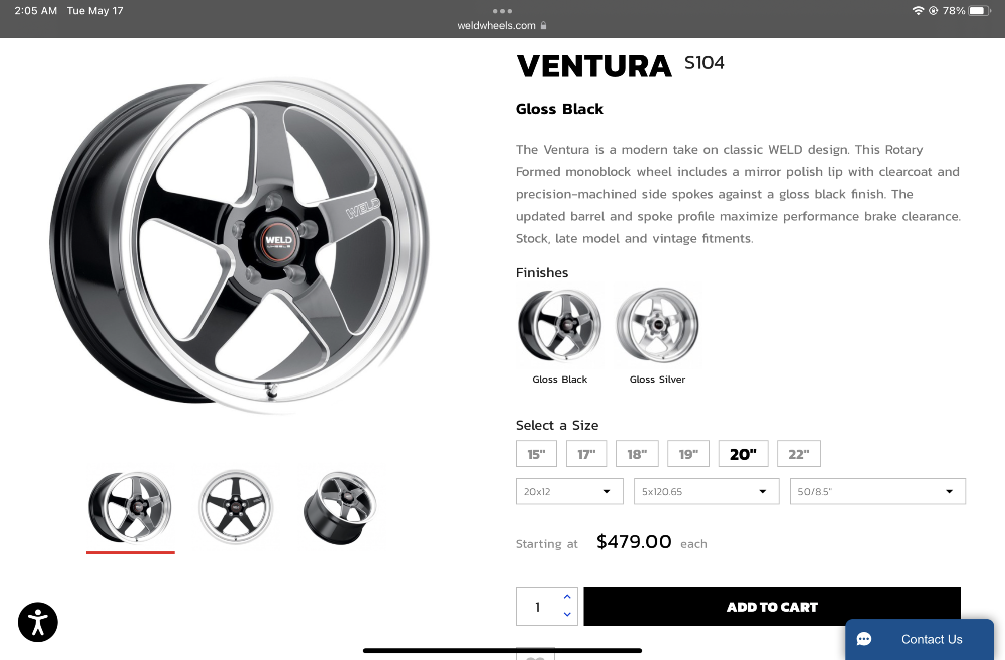

Does anyone have anyone have pictures of weld ventura s104's on their car. I have not really found any pictures of thoes wheels on the car, mostly just the s71's. I am thinking about 19x11 for back and 19x9.5 front. The pictures do not have to be this but please list what tire and wheel size you have. Do 19x11's with 70 offset even fit? Do I need wheel spacers? Any input is apreciated thanks.

70 offset will definitely need pretty big spacers (3/4")
If you went with 19x12 or 20x12 +50mm weld S104s for rears they'd poke a little w/stock but would work great with flared quarters.
345/25/20 tires is what I run now with 20x12 +50mm rear wheels 5/8" spacer and flares

The fitment offered by WELD for the C5 is 18x9.5+50 front / 18x10.5+64 Rear.
The 19x11+70 will require a spacer to clear the caliper.

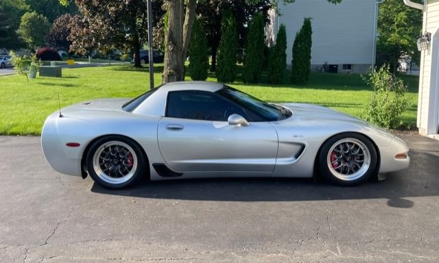

I'm running 18x8 and 18x10, not sure of offset I forget 275 up front 305 rear. I have slight rub at full turn but obviously I'm slammed. I'd like to see a set of 19's on one too.
