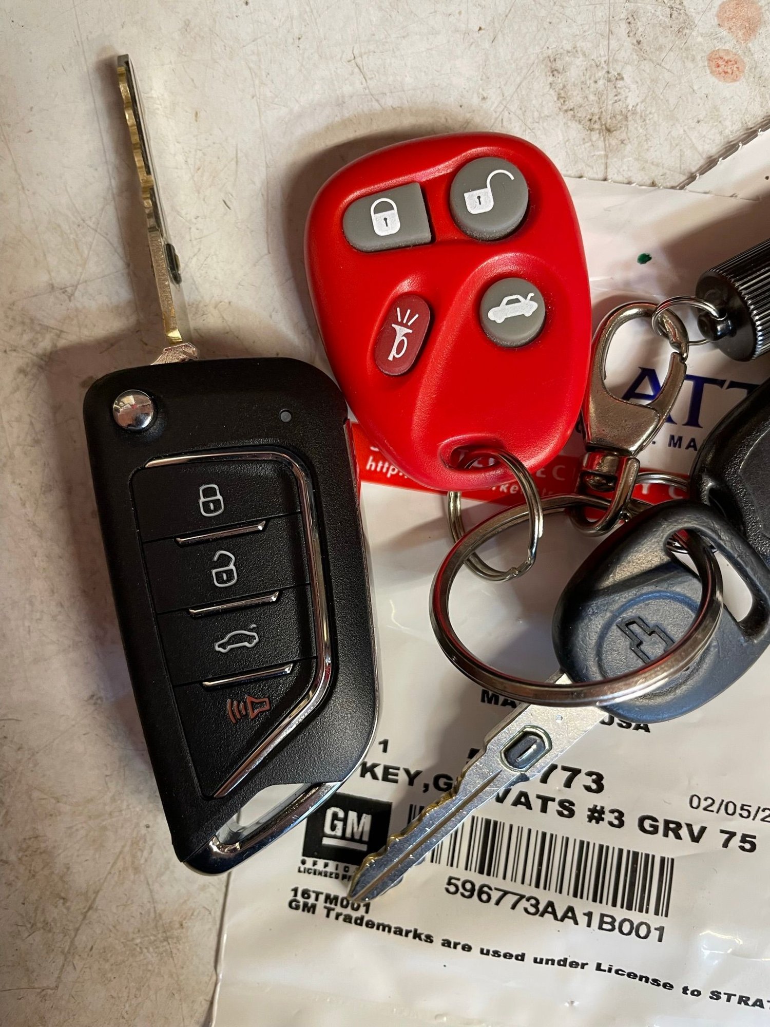

Here is an update...So I checked all the tires, and they are good for pressure. So as a last resort I did the magnet thingy to reset TPMS. It worked but I had to do it 3x. First time the LF worked fine but then the RF which was good previously said it had 14#. Second attempt same as before but then RR did not chirp the horn. On 3rd try everything went well and all is good...for now. So I think I may be looking into a new 2001-2004 set for both TPMS and fobs which is fine with me since they are readily available (read CHEAP). I just wanted to report back to all of you and thanks for all your input. Cheers!!!
Old Jun 7, 2022 | 03:26 PM
jdmvette's Avatar
jdmvette
Night Owl for life
Joined: Nov 2003
Posts: 24,685
Likes: 4,529
Then you can also do this
Old Jun 7, 2022 | 06:36 PM
snaitaz@aol.com's Avatar
snaitaz@aol.com
Joined: Feb 2022
Posts: 818
Likes: 235
From: Bakersfield, CA
Thanks Jason I have been following along on that mod. Looks interesting for sure. My plan is to mod the interior but not get crazy (yet) then proceed with suspension and braking mods followed by an LS3 swap. I did want to do an A&A blower but gotta do my research on it as I see a few members here are having some issues with that setup. If I want a "thrill" I just jump into my 68 Camaro with a 671 blower or my 71 ElCo with juice. My C5 I want to keep it "normal" (for now ).
