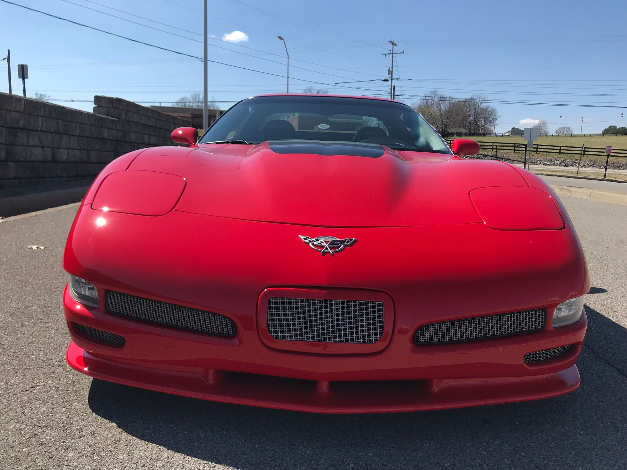

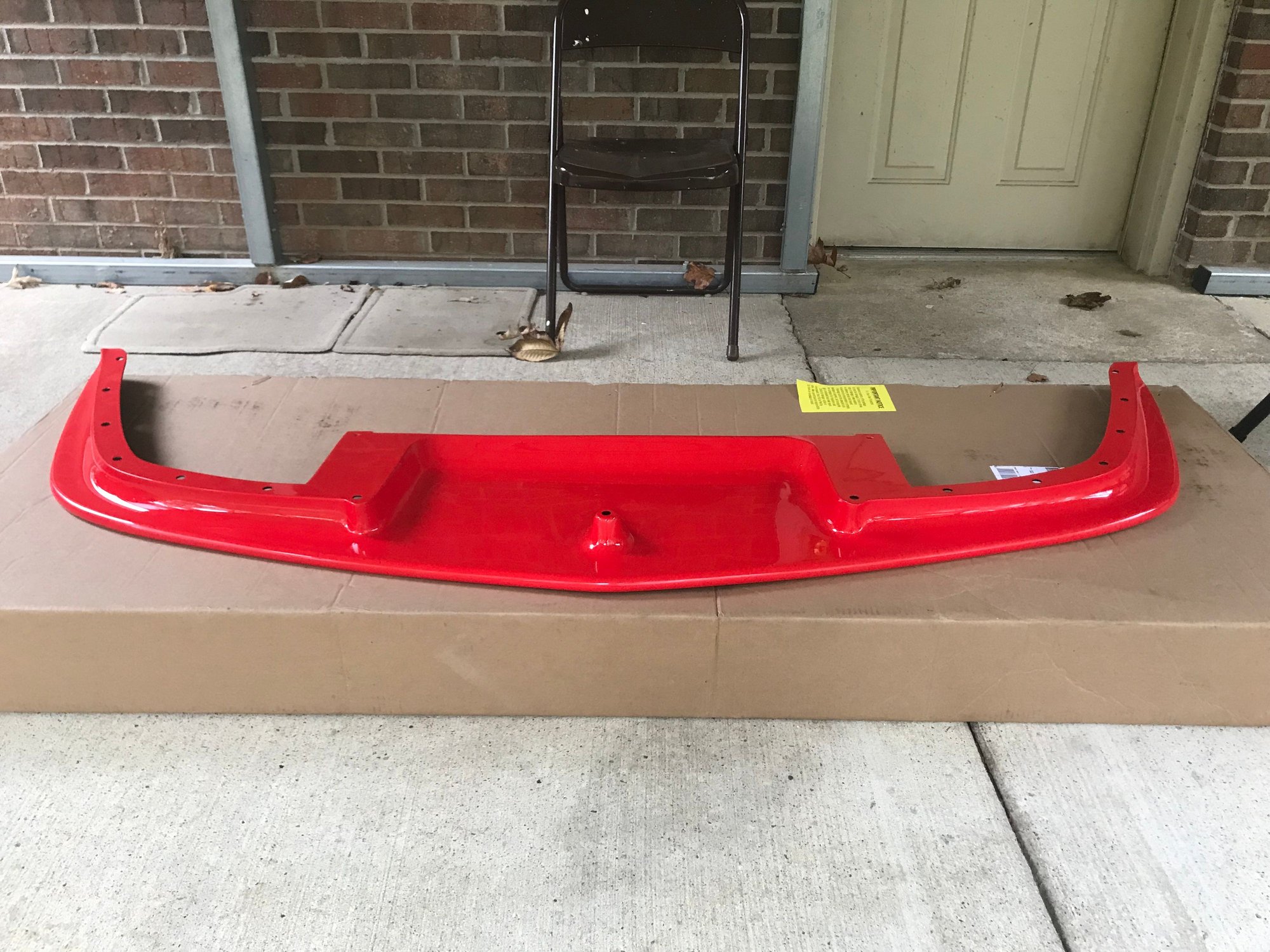

I have an ACI front splitter, and yes it replaces the center air deflector, as well as the 2 side deflectors.
The center portion (tray) channels air back and there is an air deflector at the rear of the tray that channels air up to the condenser and radiator.
The OEM center air deflector does scrape a lot normally and over time it will wear more and more material off and eventually need replacing, but otherwise it’s normal.
With the splitter you have to always be very aware of anything in the roadway, even more so if you are lowered, and curbs when parking, if you pull in head first.
There are other splitters that are the same functionality as the ACI, but it’s the only one I have used.
Before installation.
